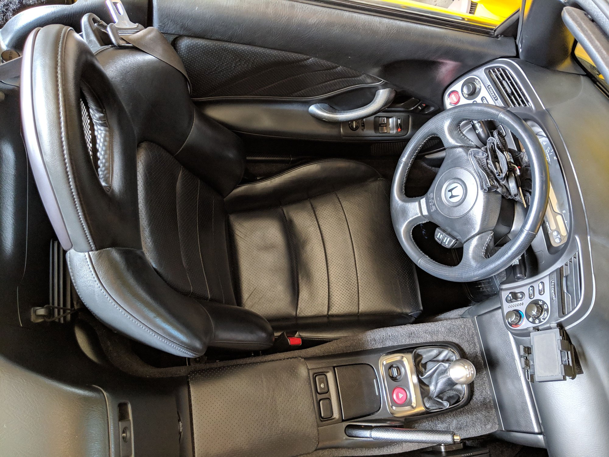

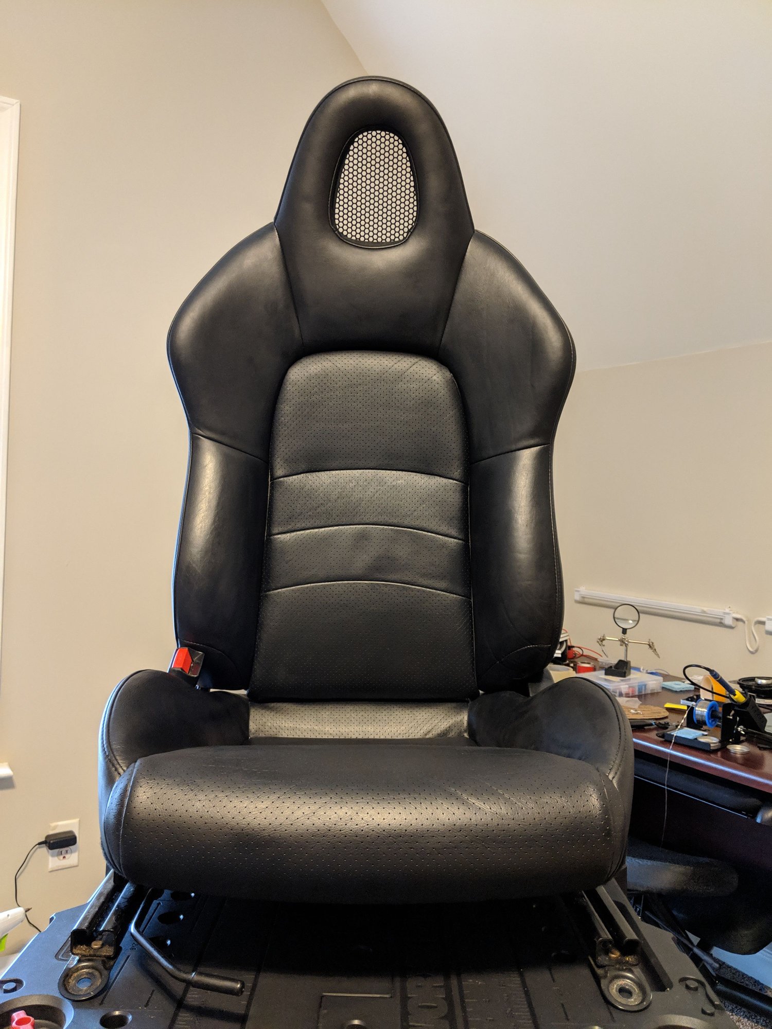

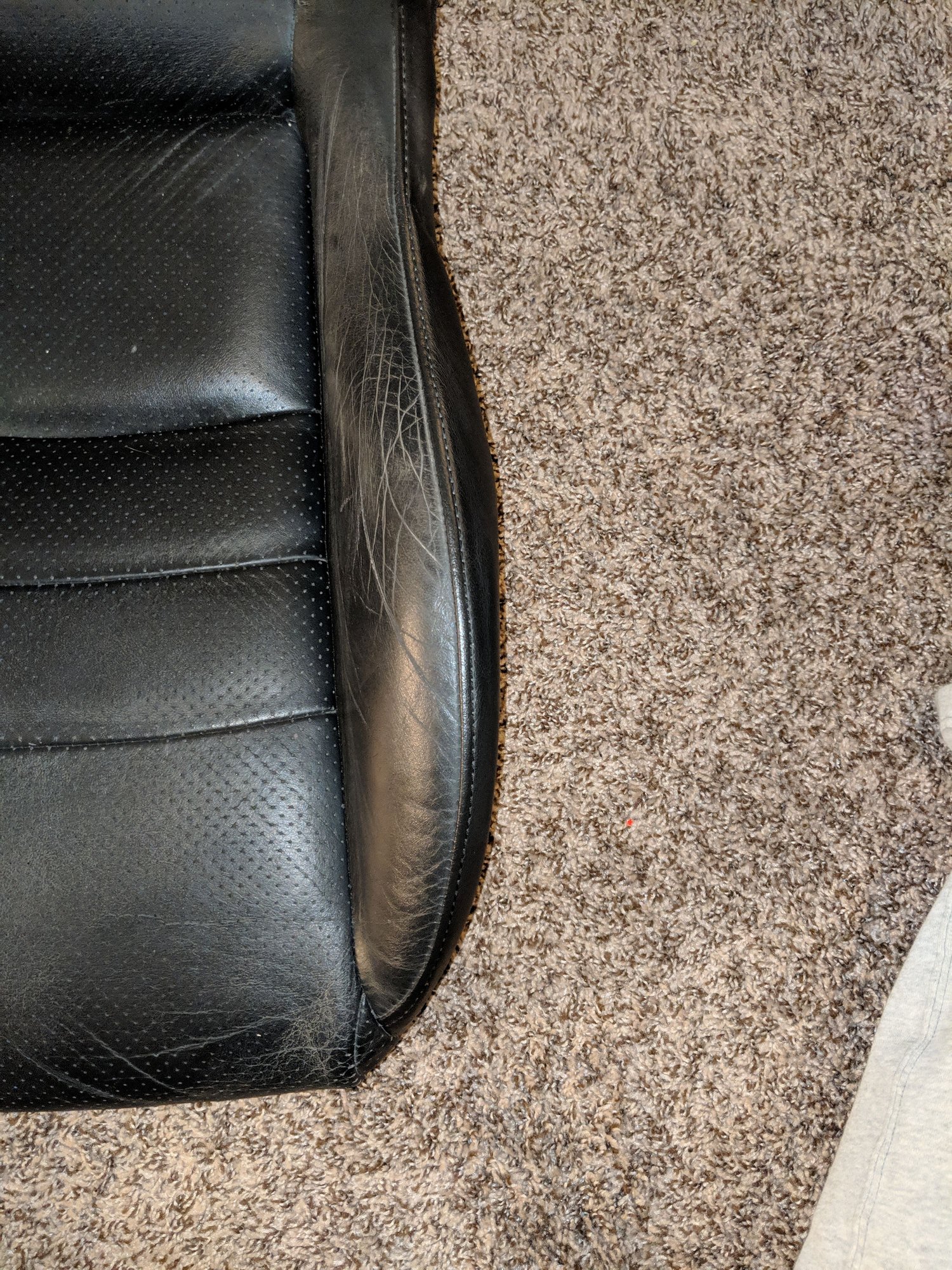

What color are the seats? If they are black, this is much easier. The seats in my car weren't horrific but there were some scratches and a couple worn areas that really popped in the sunlight and I wanted to fix them. I also had the typical driver's side flattened bolster. Here is what I did:
Remove the seat; remove the round metal clips on the side near the worn bolster, peel back the leather to expose the damaged foam underneath. Cut/glue foam pieces in place to rebuild the bolster and get it back into shape. Fit the leather back over the seat pad and re-attach using the clips or zip ties. Then hit the whole thing with a steamer with a microfiber cleaning pad attached. The steamer helps to clean and tighten up the leather in the area you worked on and also can help with the rest of the seat at removing old grease, gunk, etc.
Last thing to do is get some liquid black shoe polish (like this: https://www.target.com/p/kiwi-instan...B&gclsrc=aw.ds)
Apply to the seat on any worn areas, scratches, cracks, etc. It helps hide them and amazingly this stuff blends in with the black color of the seat extremely well. In my case I applied to the entire base of my passenger seat to cover some scratches and it looks great. Even in full sun, you can't tell that the dye was ever applied. It just looks right.
