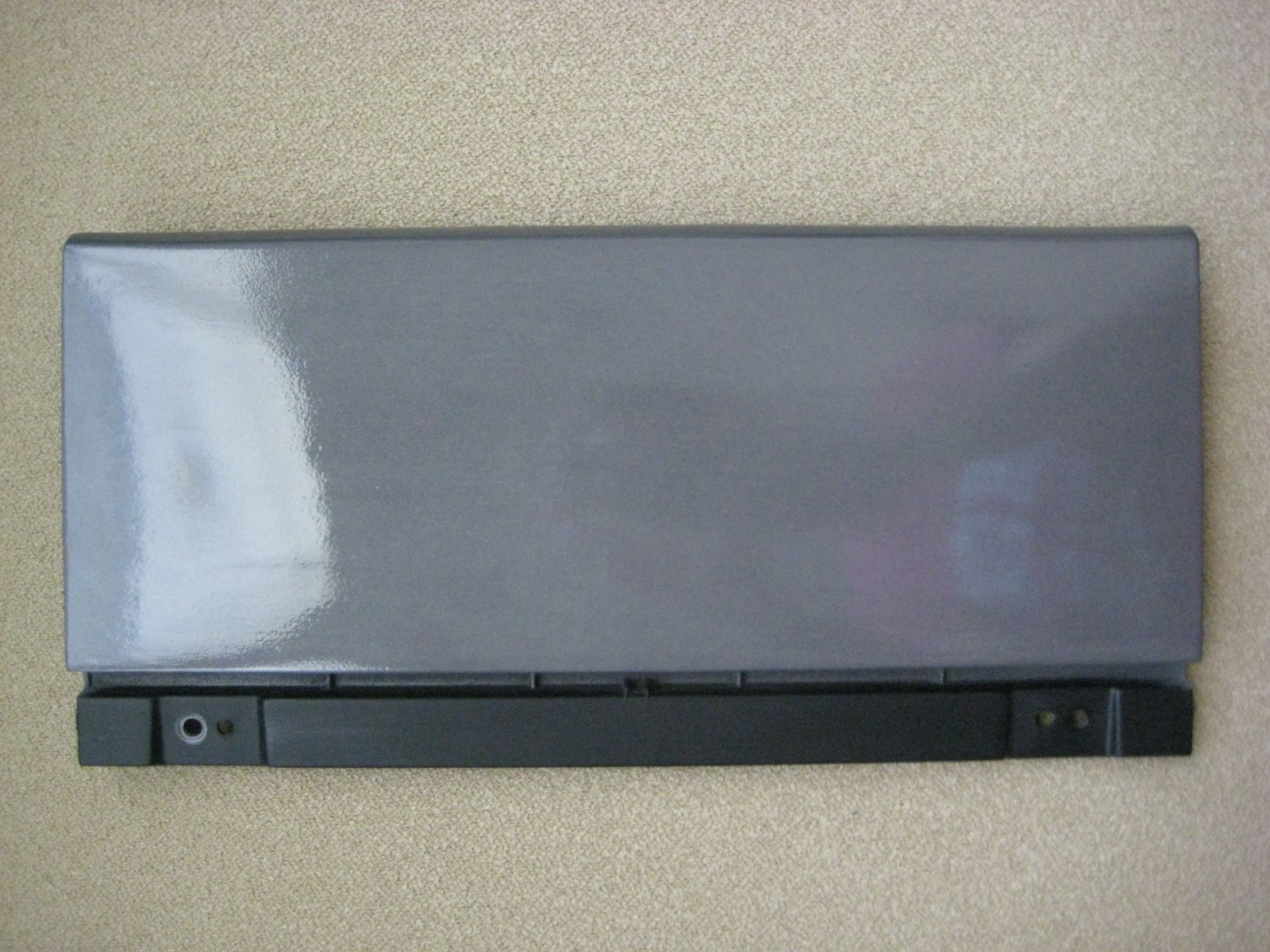

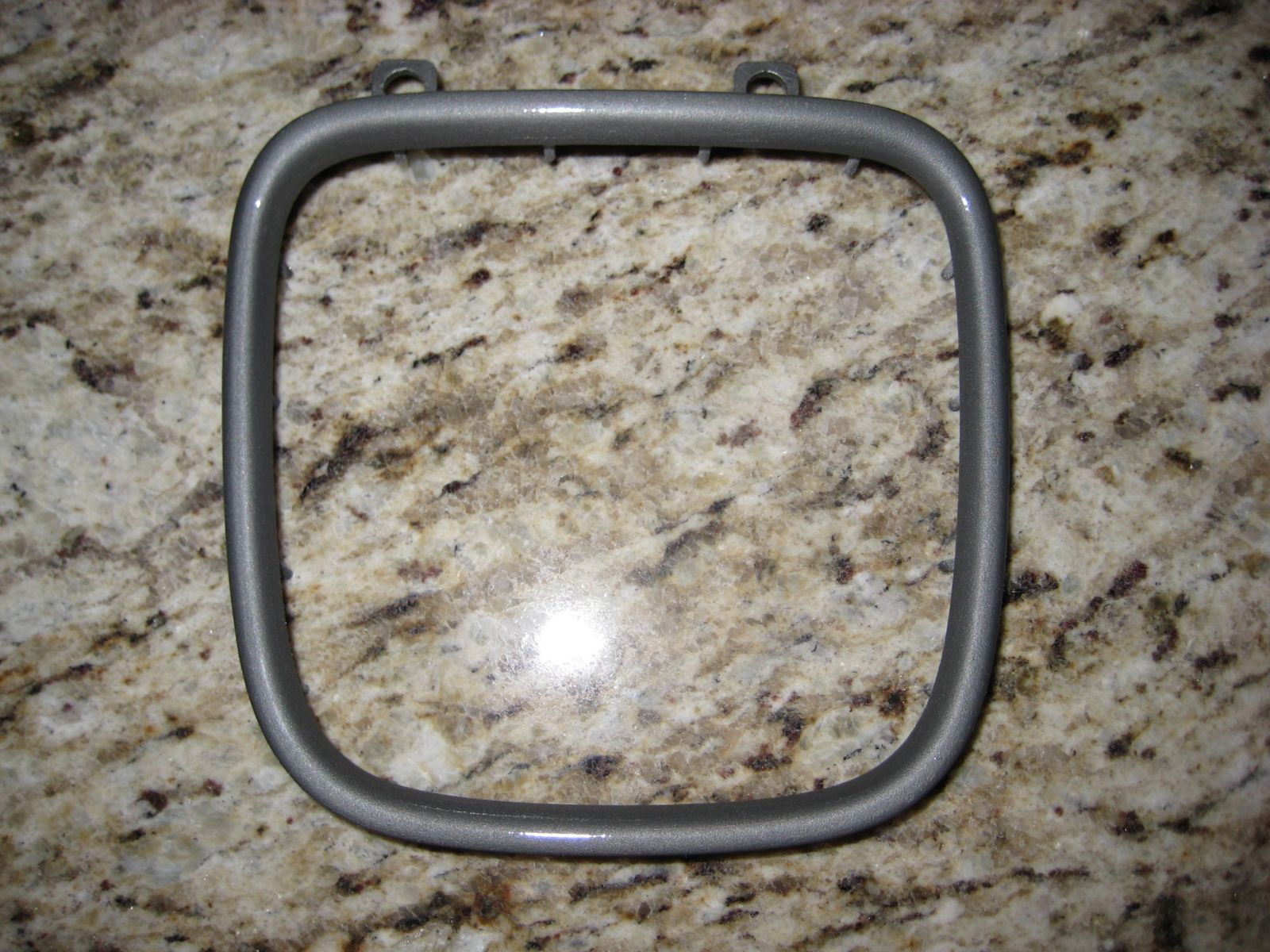

Here are the results we got.
Most of the pieces

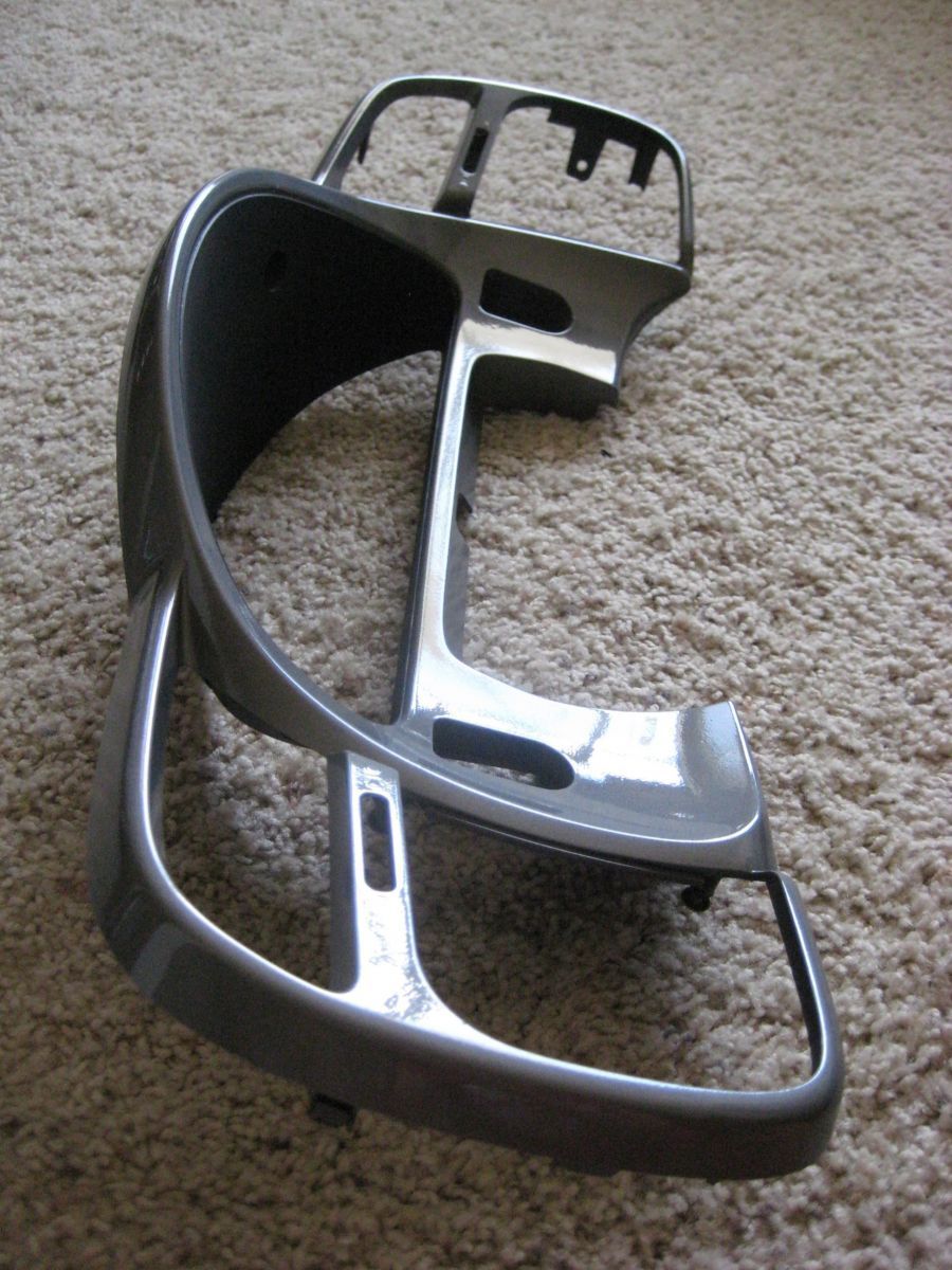

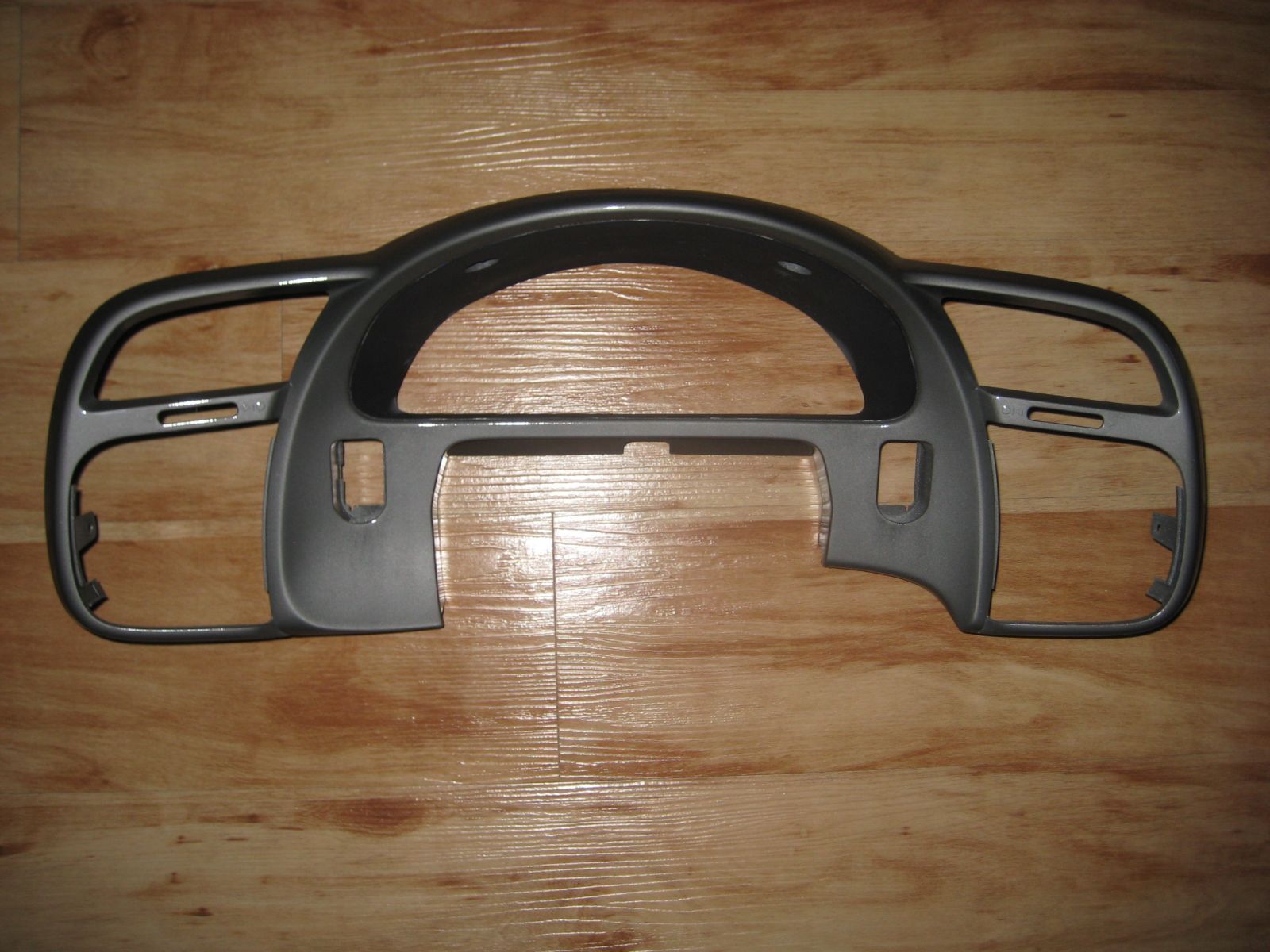

Gauge Cluster
Steering Wheel Under trim. This pic best shows the results.
Steering Wheel Upper trim
Secret Compartment rear trim. Notice my wife's reflection )

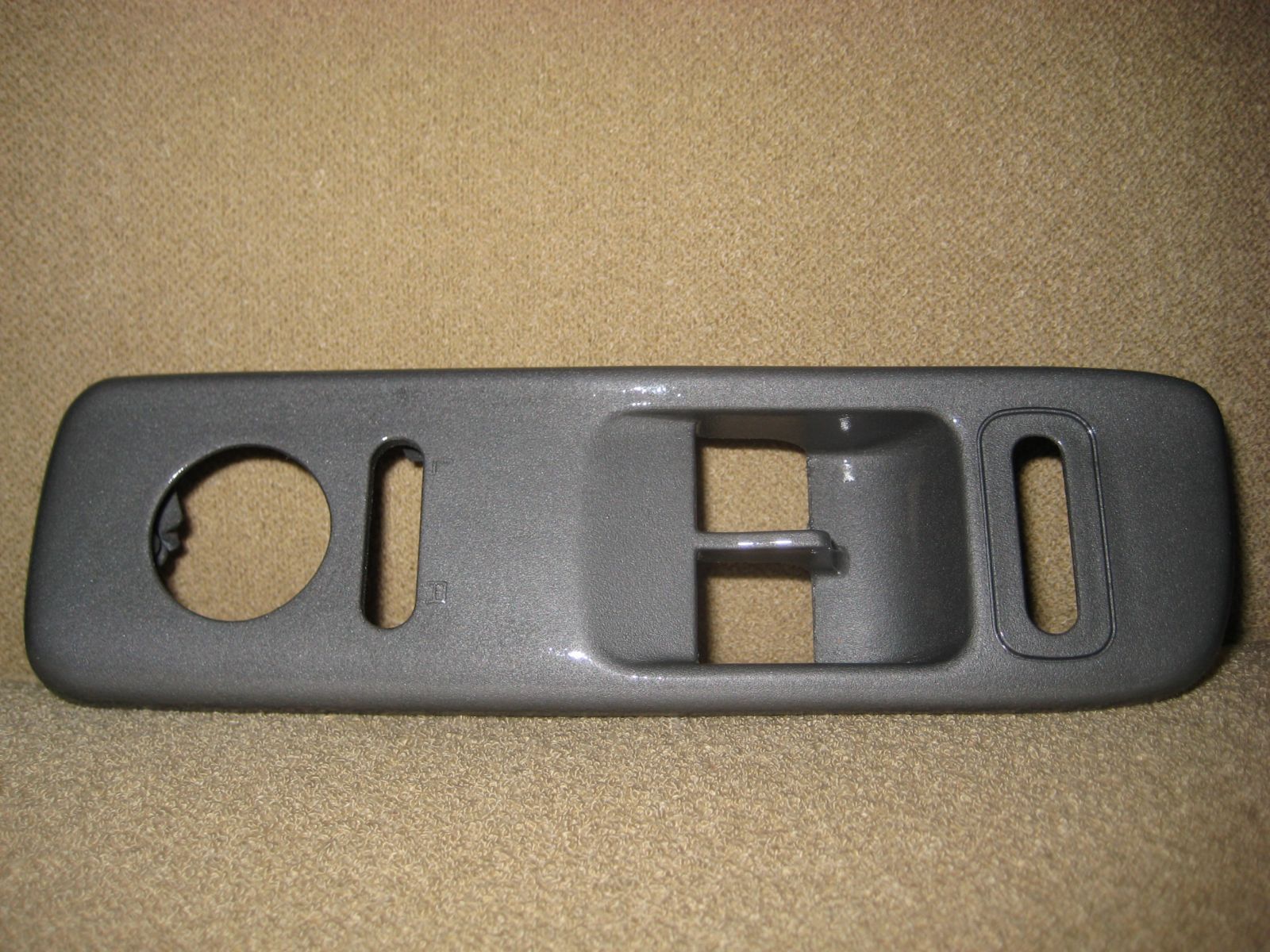

Window control trim pieces
This is a very close picture. The finish is very smooth - the texture is metallic look of the paint.

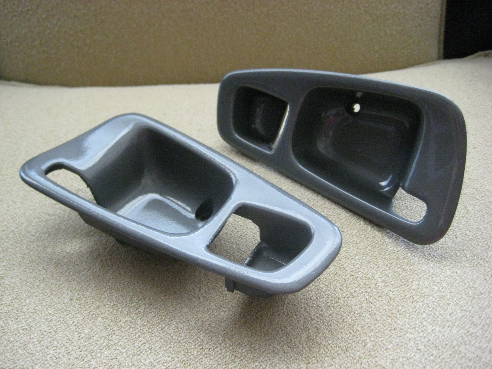

Door handle trim

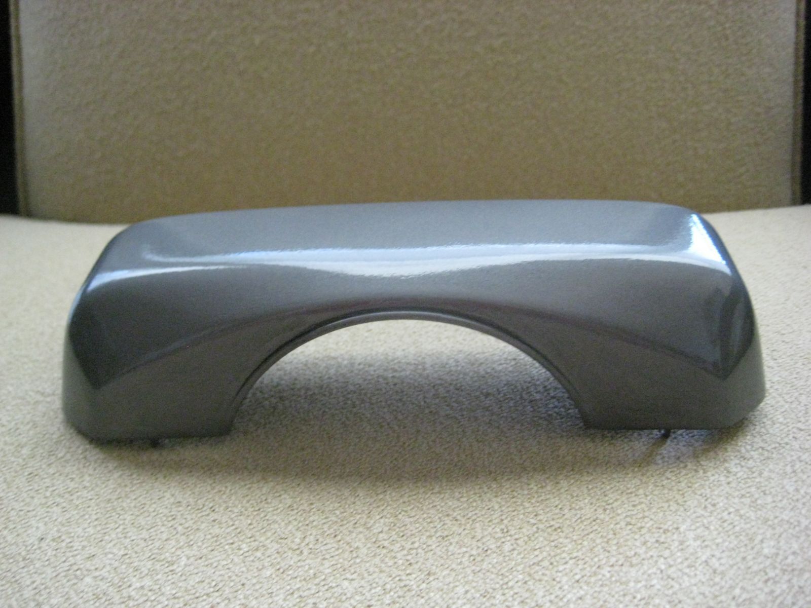

Shift boot trim

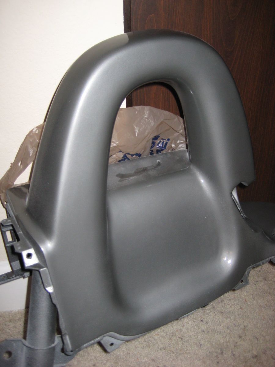

I posted this pic to show how easy it is to work with the U-Pol clear coat. The roll hoop has had the first 3 coats applied. You can see 'dust' on the surface. That's not dust but the overspray. Just wipe it off ))

We finished the roll hoops. A gust of wind blew one off it's stand. I had to do some touch up work.
The car is Rio Yellow and I've always wanted gray roll hoops. 8 years of owning an S and I finally got them.
