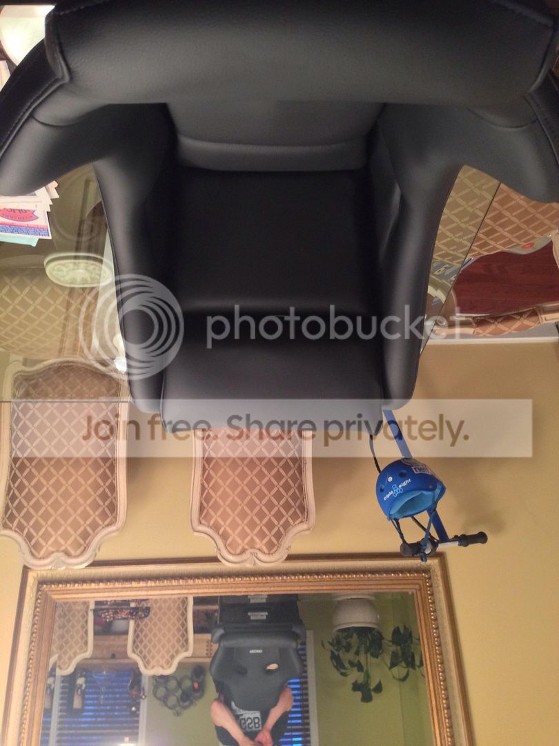

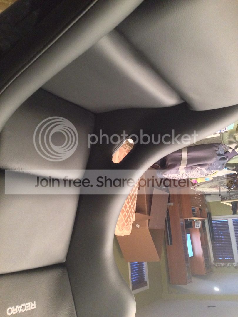

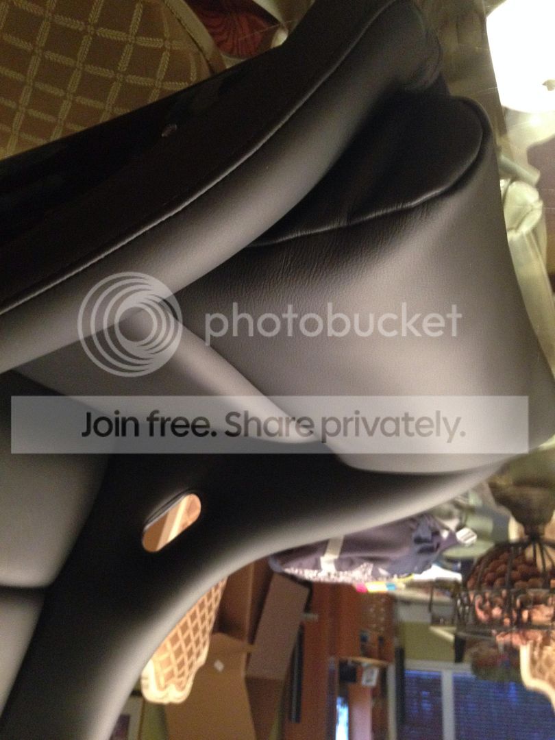

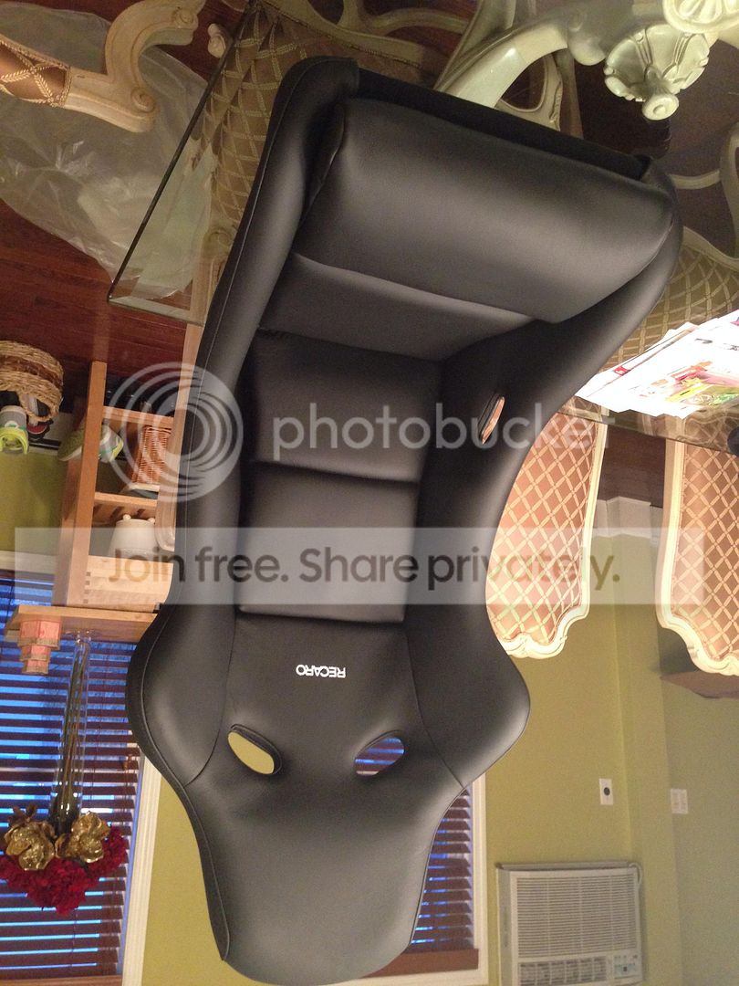

So I went to automat in Hicksville. I picked up two cushion material. One was 11/4" very firm foam that I shaped like the recaro cushion and shoved both back in.
For the outer leg cushion I installed a medium-firm cushion about 11/2". I shaped that as well and shoved both back in.
Recaro gives you a tiny pocket cushion to install for lumbar support, I just threw it on the floor and pissed on it. After that I shaped my own piece from the medium-firm cushion and wedged it in the lumbar section underneath the leather backing.
Finally, sat back down into the seat and it is better than what I had imagined. At least 5x better after the modifications.
I sit firmly and comfortably, not sitting on the fiberglass shell. I highly recommend everyone doe this. I'll post some pics later. I'll have to pull it apart

Looks comfy.

i like your decision to pursue this and know exactly what you mean. When i have some free time and less projects on my hand this will definitely be on my list to do! May i ask how much u paid for the foam?

That's a nice looking seat, damn.

Definitely nice pick up Justin. Keep buying car parts man and nice fix

Looks great, nice work!
I used to have Recaro PP's in my car, and I also found the padding to be pretty crap. The padding in my new Sparco's is way better than the Recaro's and Brides.

That looks incredibly comfy...hmm
