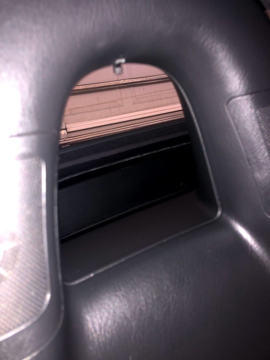

So my temporary fix was to use a right angle drill to drill one small hole in the bottom part of the inner hoop opening of each section. I then looped a small black zip tie through each hole and tightened the zip tie. The pieces stay together tight and you cannot see the zip tie at all since it is on the bottom side and the color of the small zip tie is black. I recommend looping the zip tie going from back to front and to make the small hole in the front hoop section a little larger so you can twist the zip tie lock up into the hoop after you secure it.
I will try to post pictures of the fix later if anyone is interested.

Hey can you post pictures of the zip tie truck I can’t find any used ones and dealer told me every dealer in america is sold out for months and might not ever come back in stock. I tired super glue and looks worse

So basically you just drill a small hole through the plastic on each side of the bottom of the hoop and run a black zip tie through the holes. Make one hole a little larger so you can move the locking portion of the zip tie through the hole to hide it. You cannot see it when you are done unless you look really hard directly under the hoop which no one does. I pulled the zip tie around in the picture so you can see were I cinched it at but once you rotate the tie through the slighter larger hole you cannot see it all and so far it has held up without any issues. Remember I rotated the zip lock portion out of the hole so you can see it so normally it is not even noticeable. I used a right angle drill although a normal drill would probably work as well.
