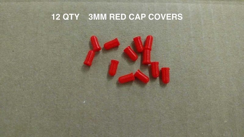

2) I also put silicone bulb covers over some LEDs. Some I reused from the OEM bulbs, and I bought some more off eBay from a guy who rebuilds gauge clusters. The title of the auction was "12 qty RED 3mm light bulb Color Caps Covers, climate radio switch auto car."
The bulb covers will dim the light and spread it out more evenly, even if they are the same color as the LED.
