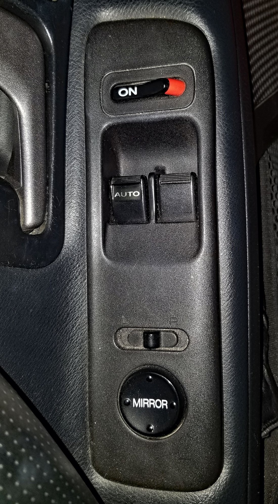

Just to be sure, it's not this switch?

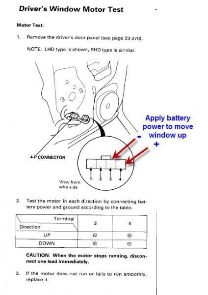

Im pretty sure its not but I could be wrong, I used this diagram to send direct power to the motor and still couldnt get it to work. The motor and something under the passenger dash was clicking when i sent power to the motor. so I dont think its the switch. Regulator doesnt look like it has any snapped cables or anything either.

Check the switch. Is it ON or OFF?
Thanks!
Was the switch turned off? Was the motor actually bad, and if so did you get it swapped out yet?

The switch is turned on so its not that, still have not swapped out the motor yet. hoping to find one local before i order

Well crud. Was hoping it was just as simple as the switch being turned off or possible the switch itself.
