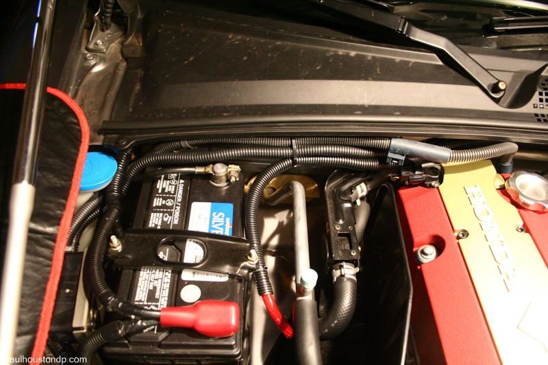

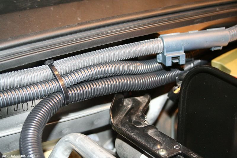

All wires have been hidden. Thanks again Autozone!
The nitrous wires are inside that middle cable cover. (the thick red wire is for a sounds system that never came to be).
Future plans... I should get the extra bottle clamps later today actually and I will update this picture.
