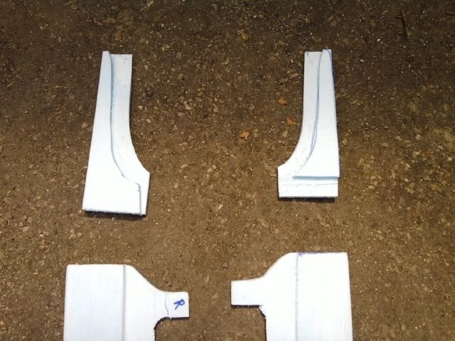

Just starting this project... so this is a work in progress journal.
Last time i got the whole rear diffuser sculpted and messed it up when I started glassing...
This time I'm starting with the side splitters...
... and am not going to blow it with an "undesirable chemical reaction"
Here's a couple of pics of the blue foam blanks:
I'm thinking Flat black...

Looks like we're working on very similar projects. FYI, if resin melts your plug, you can simply spray your plug with a couple layers of automotive primer.
Good luck

^^^ Cool -
Good luck with your project
I'm going with epoxy...
polyester resin will melt extruded polystyrene foam (XPS)... but epoxy won't...
--- see "undesirable chemical reaction" above.

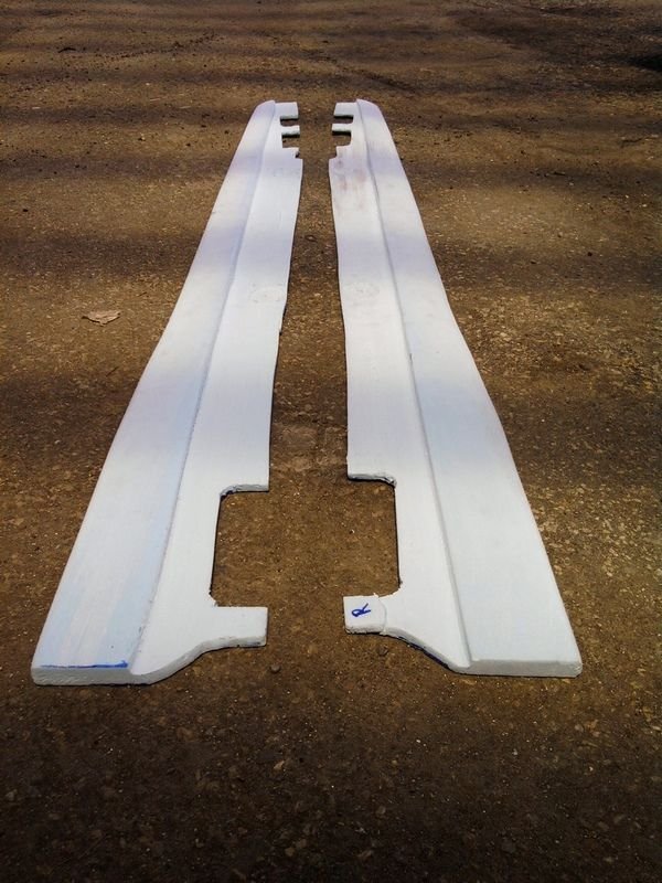

couple more pics -
DOW square edge foam -- ready for glass
end caps need some shaping still... working on making them thicker.

Wow, impressive. Your molds look good. Interested in seeing how it works out.
