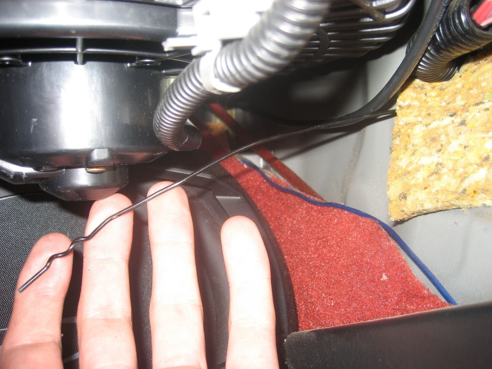

ran the wire down to the floor and popped off the plastic kick panel
(yes that is a sub in my passenger floor, no no one kicks it, no it doesnt take up more than 1'' of extra room compared to the stock floor)

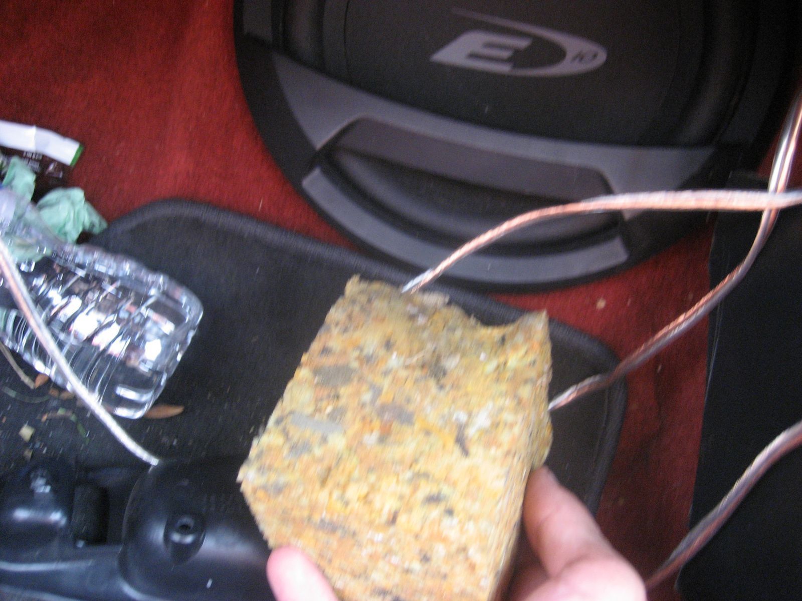

so after that i removed the awesome piece of sponge insulation honda put in our car, along with the door pannel(3 screws), and the speaker to get in there a bit easier (the entire housing not just the speaker itself(4 screws))

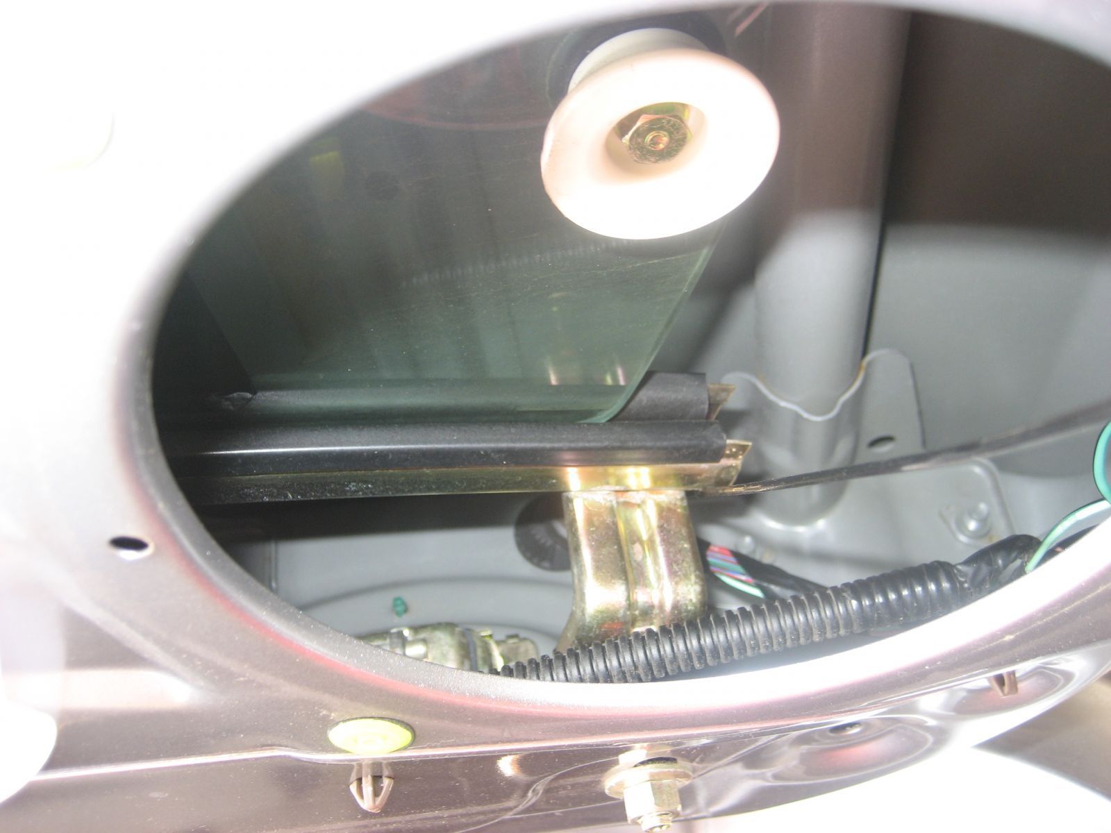

i used the old wire hanger to fish through and pull the speaker wire through the factory holes it was fairly easy acyually
ps put ur windows up it helps alot

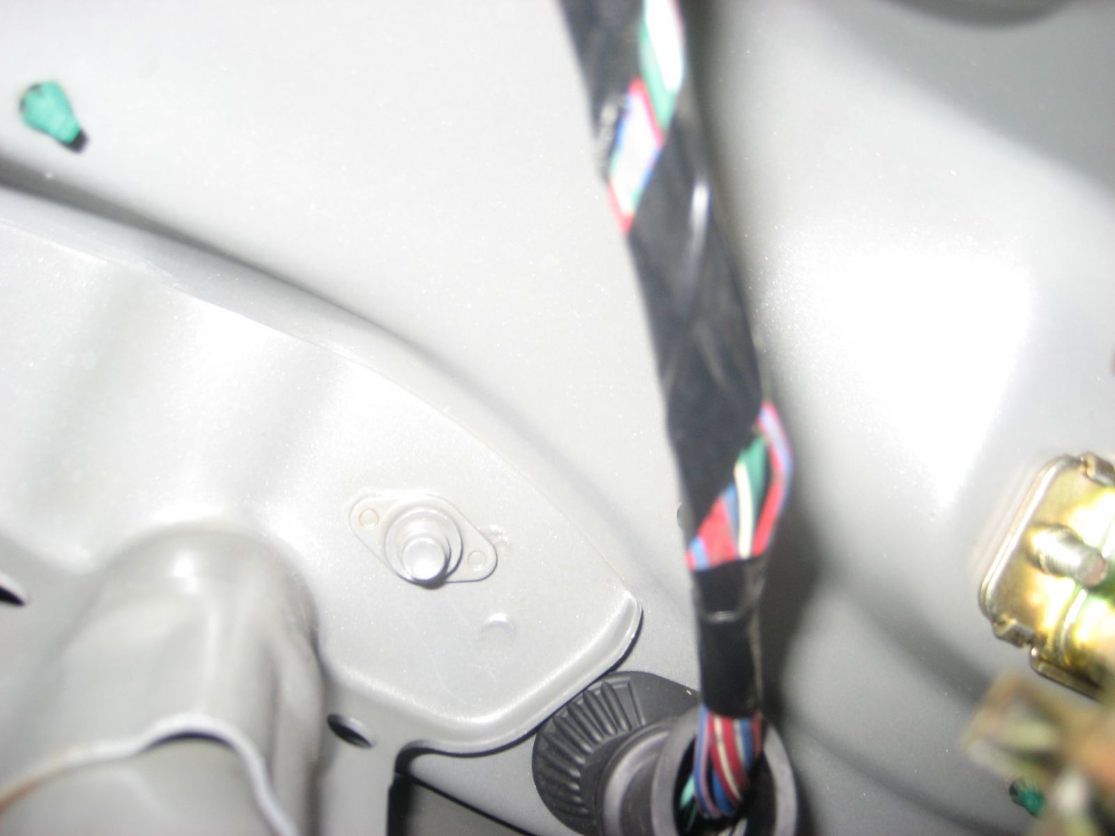

this is a shot of inside the door just follow those wires using the clothes hanger
right through to the other side

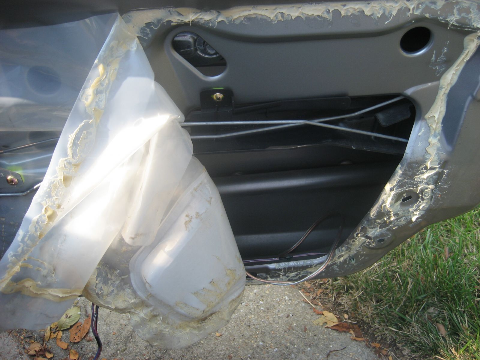

then i pulled off the plastic on the back side of the door to access the wiring with more ease.

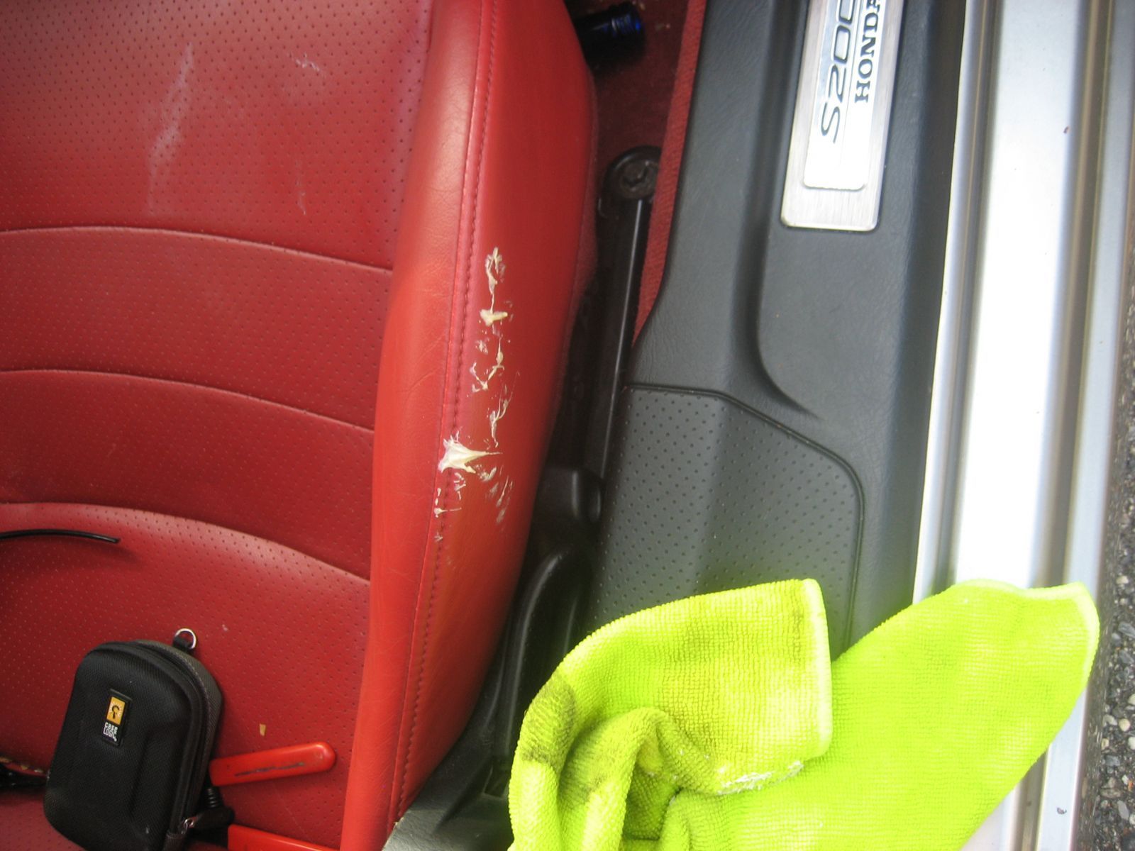

look out for that crap they use to seal the door its nasty and sticks to everyhting

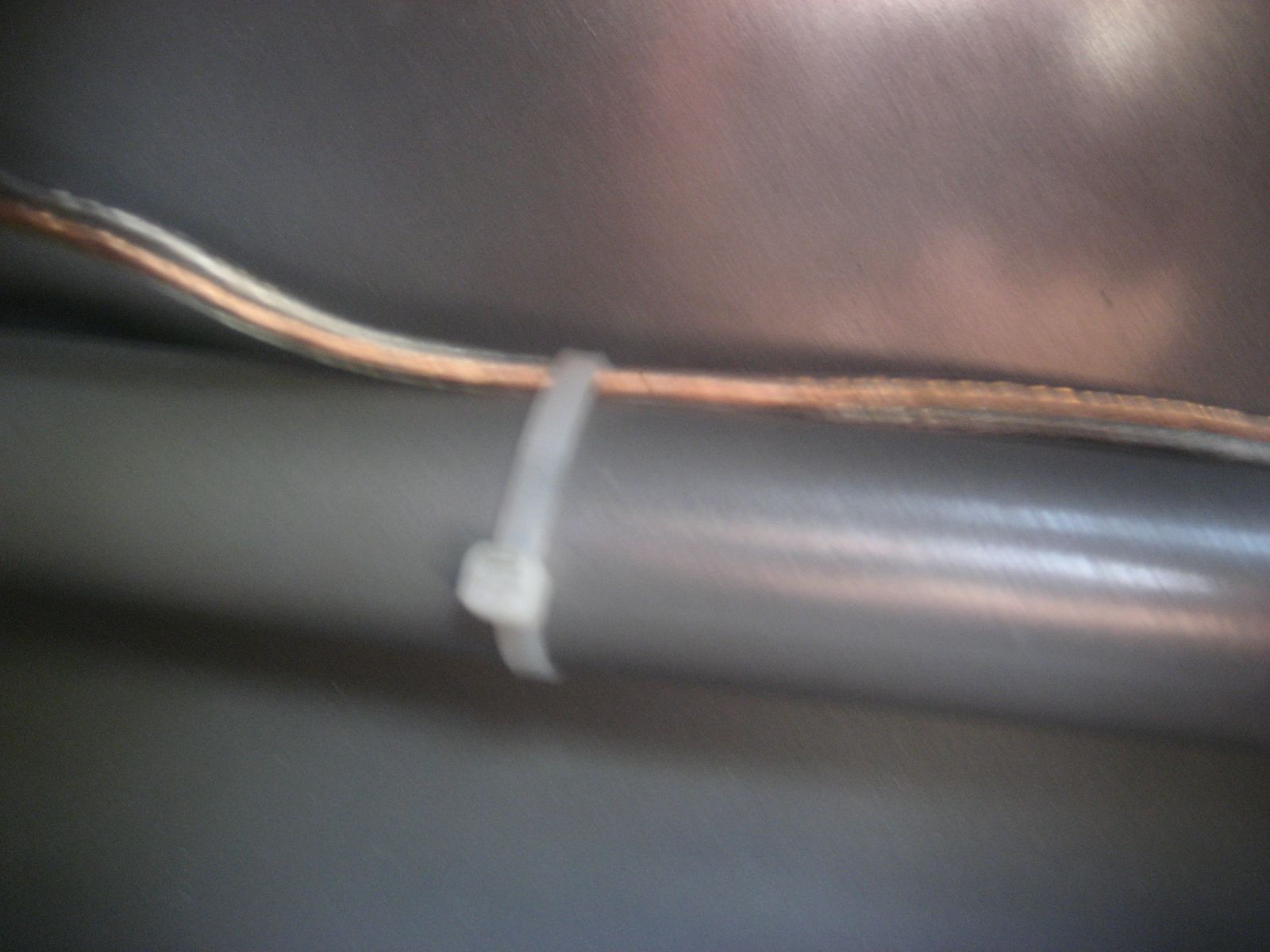

i fished the wires through the holes and used these clips to attach them incase one burns out it will be easier to replace
i used tiewraps to attach them out of the way of the windows

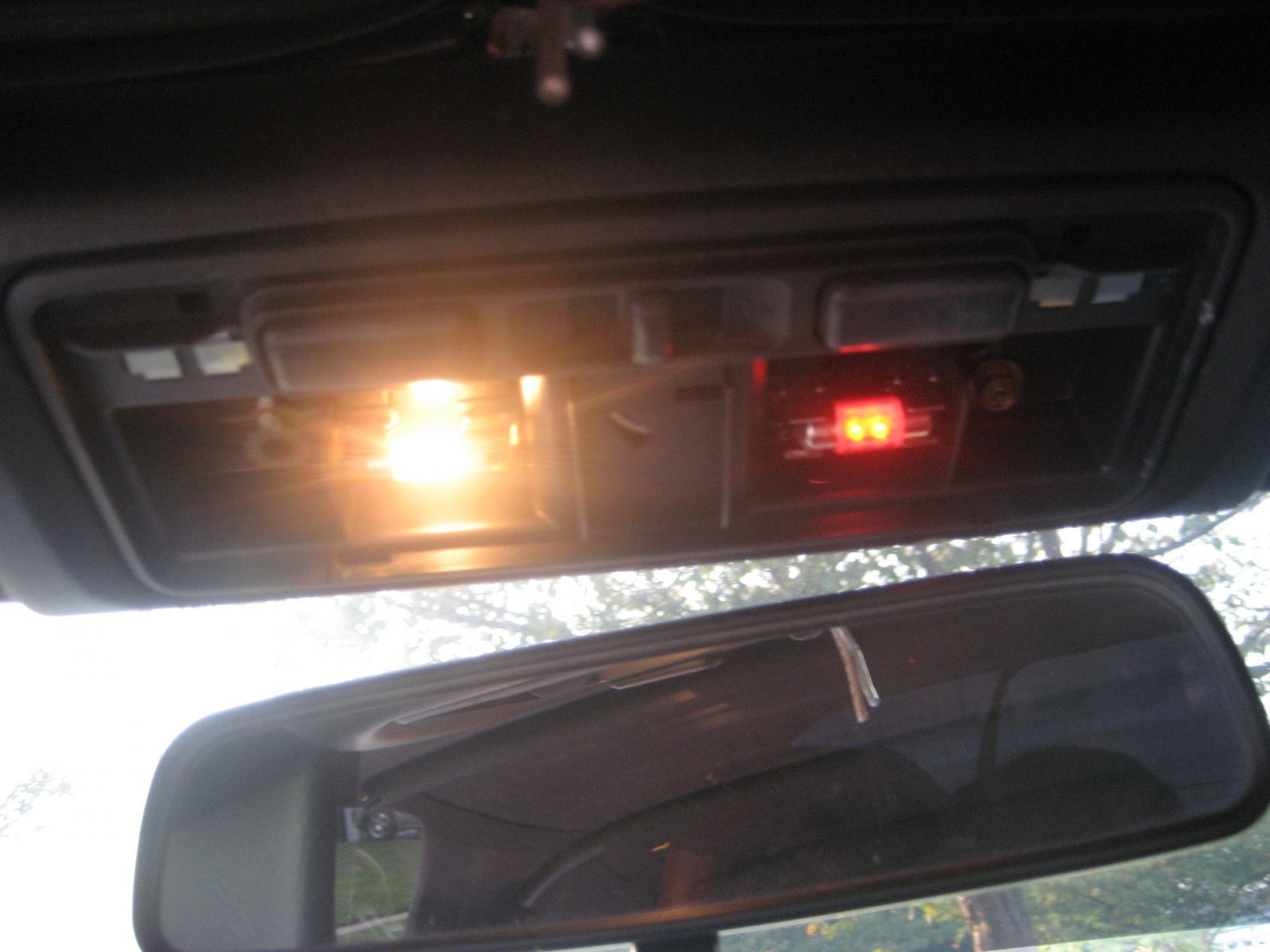

after that was all hooked up i wired it into the dome light the plastic piece pops off with a small flat head screwdriver
oh and i changed out interior lights to this red led looks good on the red/black leather(like the m3 lights)
to remove the whole lighting assembly you need a phillips screwdiver there is 2 screws on the sides of the lights
then here is the final result
hard to see because of the camera flash but they look good imo
