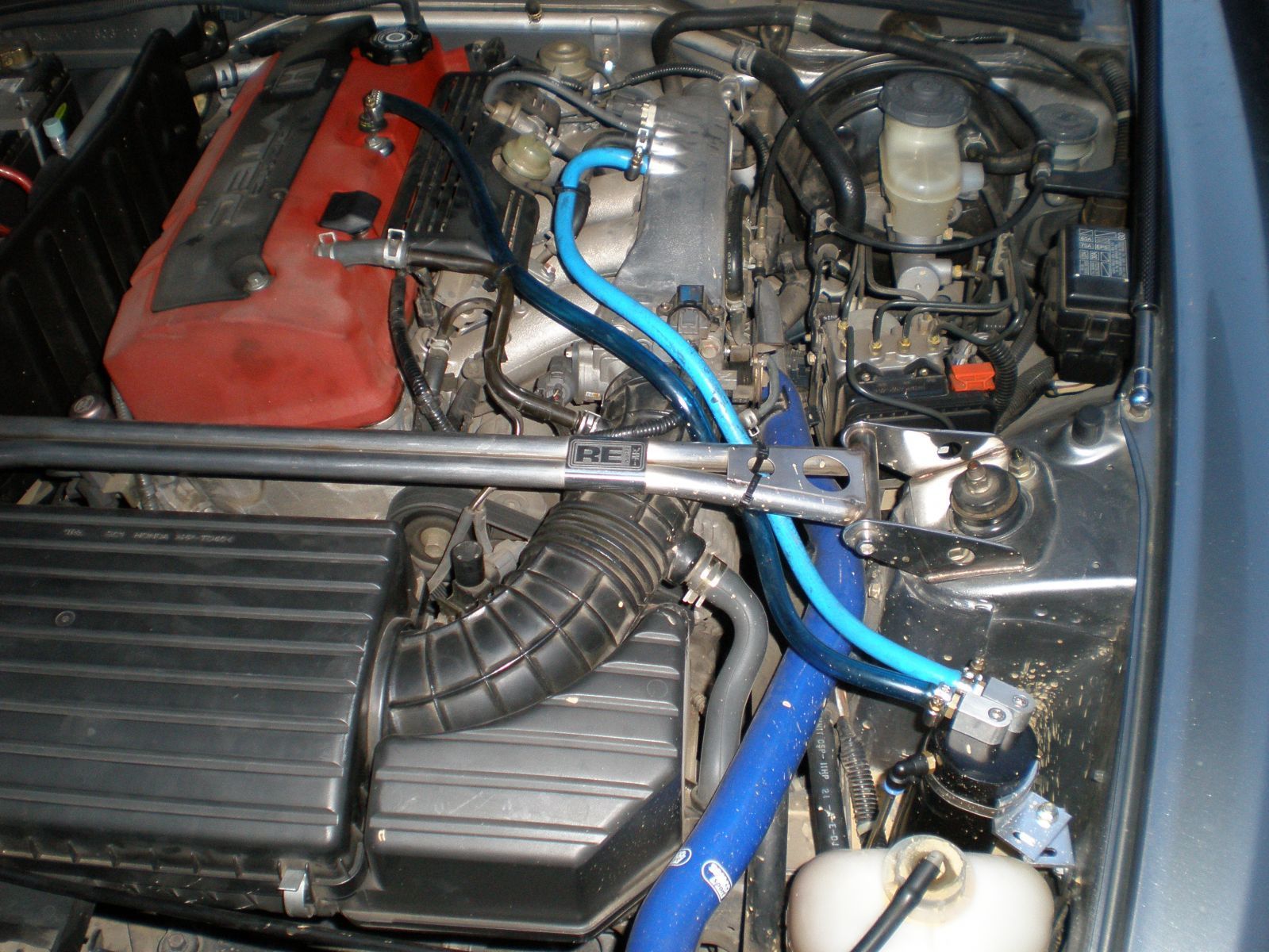

I am after an Ingalls (stiffy) Engine Torque Dampener but i already have a RE-Works Front Strut Bar and i was wondering whether i would have a problem with re-fitting my Strut Bar after have fitted the Dampener. ( i know the dampener goes to the other side buts its the only pic i have of my engine bay that shows the strut bar and how it mounts)
They do use the same bolts to mount on and common sense tell us that after fitting the dampener, the Strut bar would have a lift of 2mm-3mm from the left side. Shouldnt this be a problem?
Anyone using a combo of Front Strut Bar + Engine Torque Dampener without any mods on the bracket?

puddymod sells a special bracket which bolts under the fuse box near the strut to be able to have your torque damper and your strut bar

You can run the damper bracket, and then the strut bar on on top of it with no problem.

this is off topic but what are those blue hoses going to? what are the functions? i know that on stock cars, the hoses from intake manifold goes straight to the engine. but on the picture, its going to a navy blue can and then back to the engine. can someone explain to me what that does? =)
Oil Catch Can
Its basicaly a can that takes the hose from the PCV Valve and returns it to the intake manifold.
It keeps oil away from the intake resulting to excessive smoke from the exhaust.
That is mostly noticed in hard right turns where the engine design isnt quite helping.
