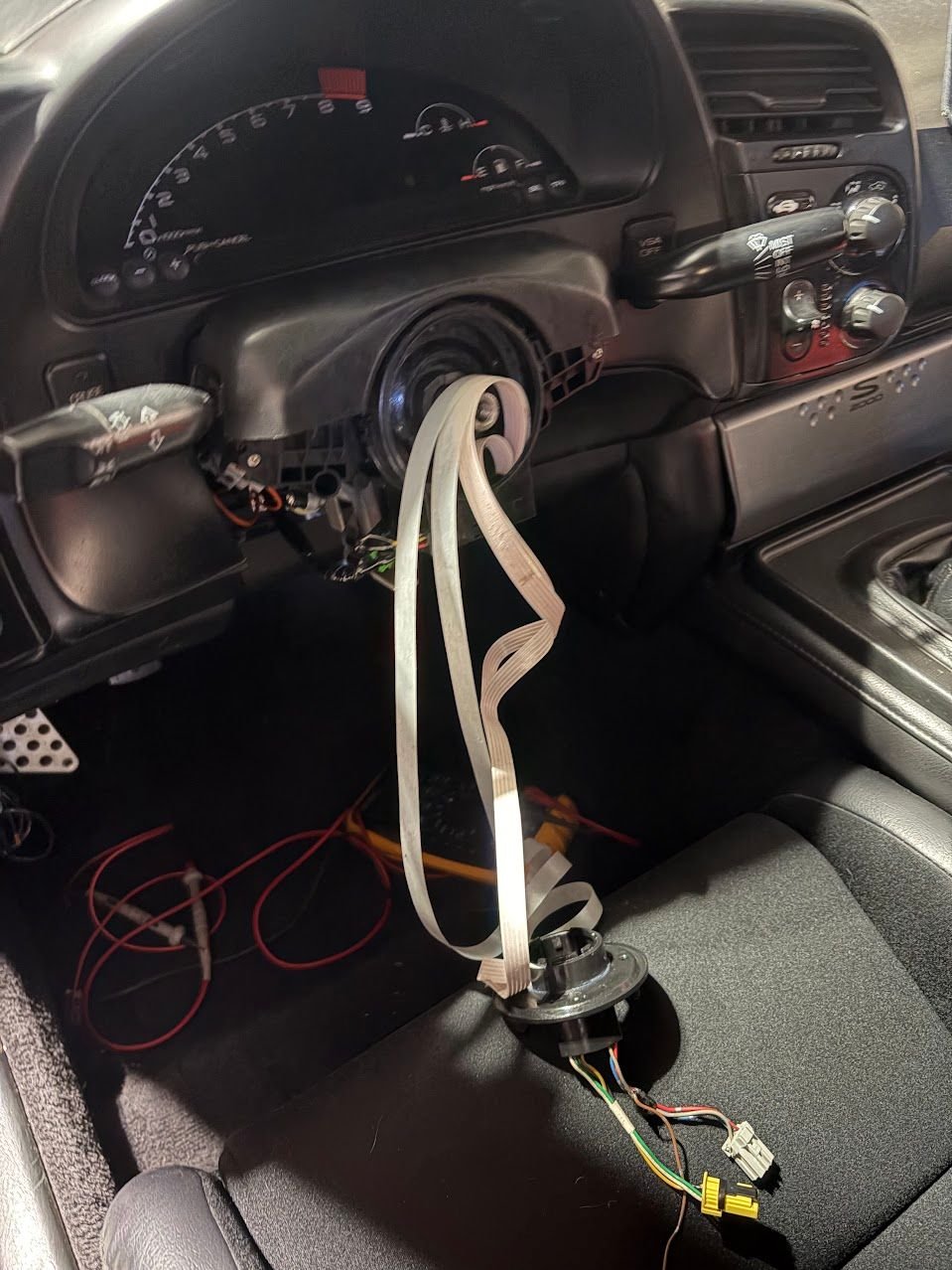

Tried installing NRG hub and quick release today but messed up and pulled off the front cover of the cable housing/clock spring. I know from other posts [1, 2] but I can't seem to figure out how you are supposed to get the back housing to respool it back in. Do I need to take it completely out of the car? It does not seem to want to come out and I didn't see any bolt/screw holding it. My main confusion is the detailed process in how this is supposed to go.
Really trying to avoid having to spend 300+ on a new clock spring.
Any help or advice is much appreciated!

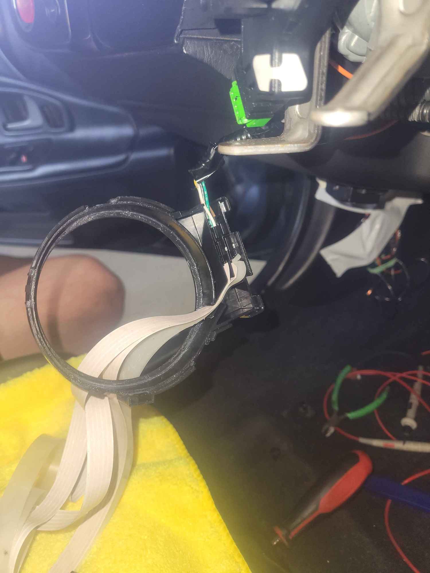

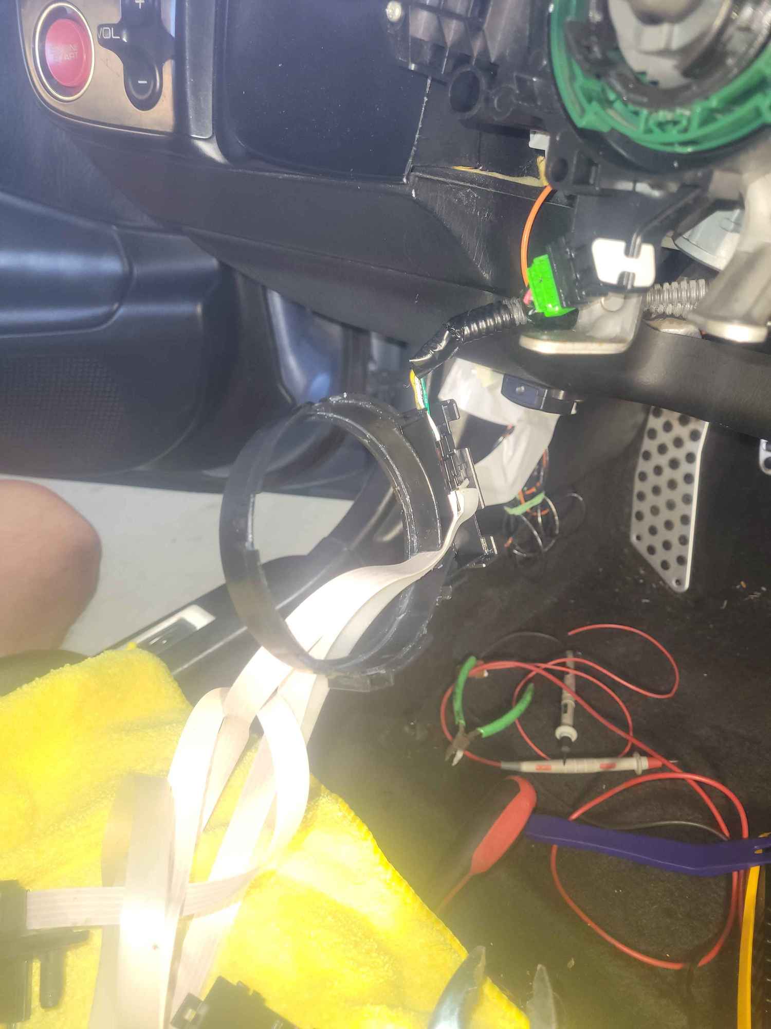

  4. If your reading this post, that likely means that your ribbons are all out. If this is the case, it is likely that the plastic retaining ring/clip is already broken open/loose. Remove this from the assembly and set it aside.
  5. Using wire cutters, cut the zip tie that is holding the wires to the housing.

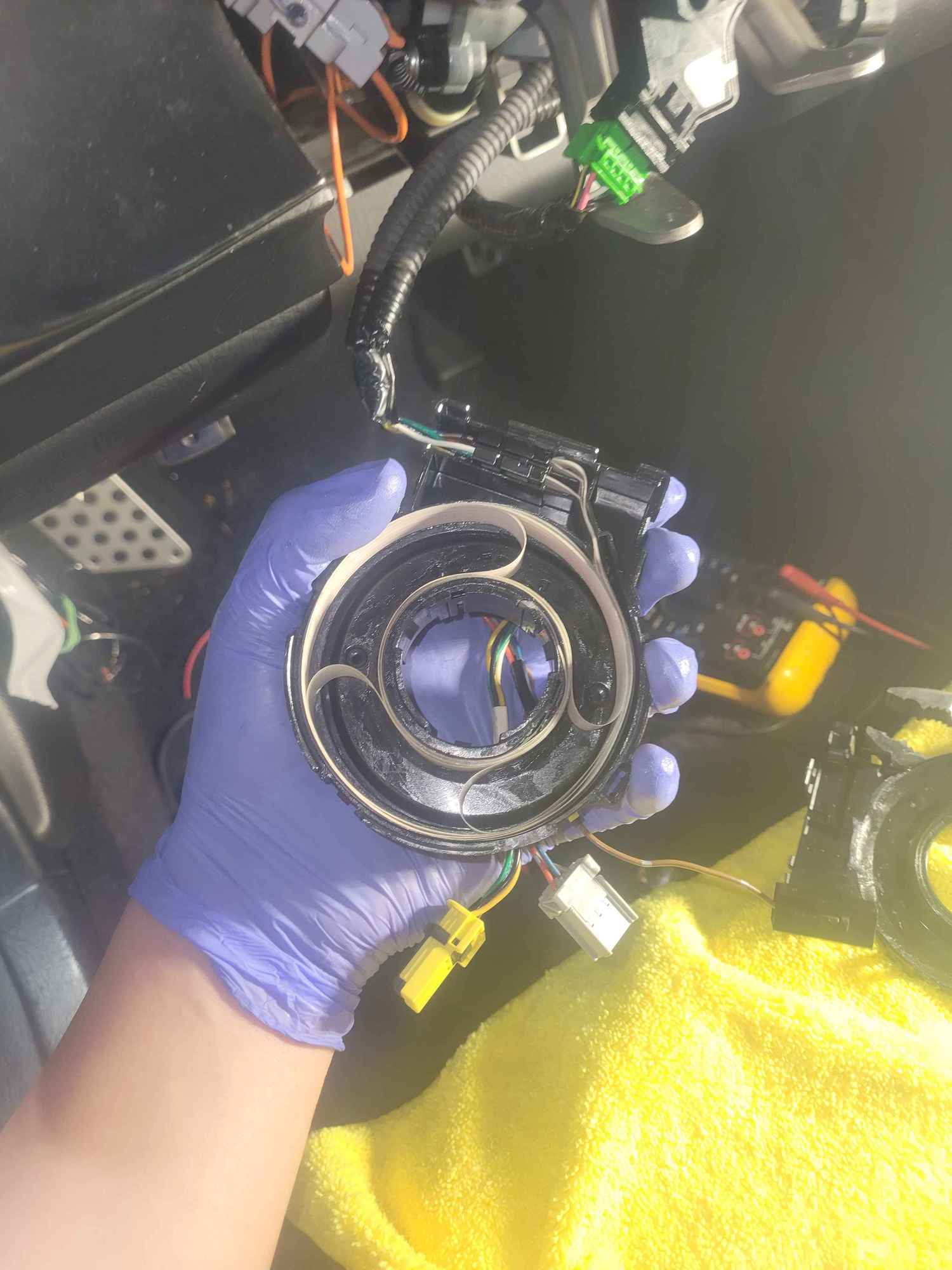

  6. Using the same plastic trim removal tool, pry away the tabs to expose the back housing. Remove the back housing and set it aside. You should now see something like the following:
  7. You will notice that you don't actually re-feed the spool into some container inside. Rather, you will need to coil/roll the ribbons back around the piece that popped out. When you get close, it will seem that the ribbons loop upon each other. Orient the loops such that they fan out from the center. The very bottom ribbon needs to go below in the opposite direction. It's a bit hard to explain but it should look like the following from the back:
