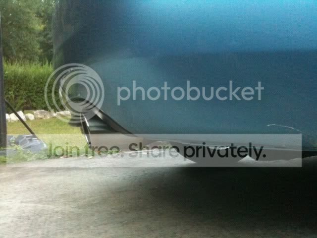

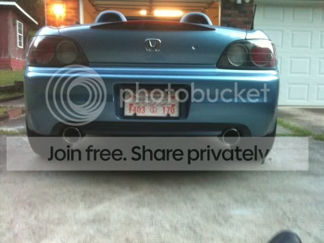

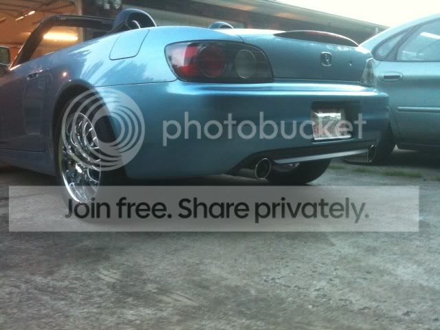

I am going to upload pics and video tomorrow. I'm trying to figure out how to upload iPhone vids to the site. The exhaust looks OEM stock other than the fact that there aren't ugly canisters hanging down under the bumper. The only thing you see is part of the factory split piping near the suspension. I lined the tips up in the holes exactly symmetrical on both sides. They look like OEM 350Z tips, and fill the cutouts better than the OEM tips. I think you will approve
Oh, and the tips came from Summit Racing.

Pictures up. Vid coming soon..

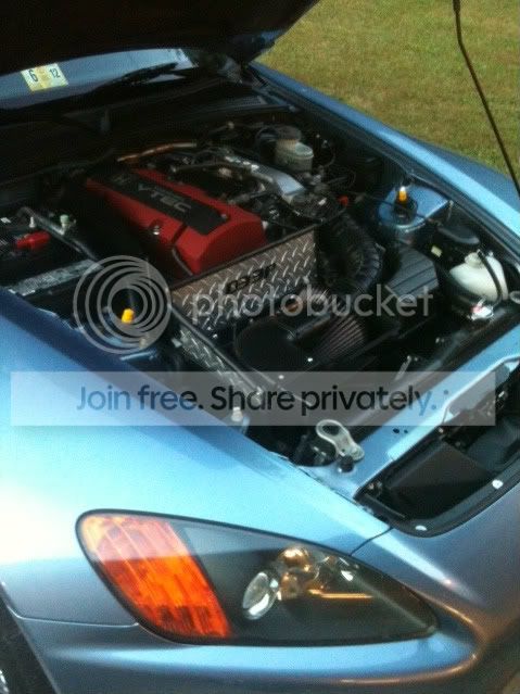

Posted an image of the intake mod: Still a semi-rough draft, not complete.. Free mod, works, so don't flame me too hard for it! Lol.
