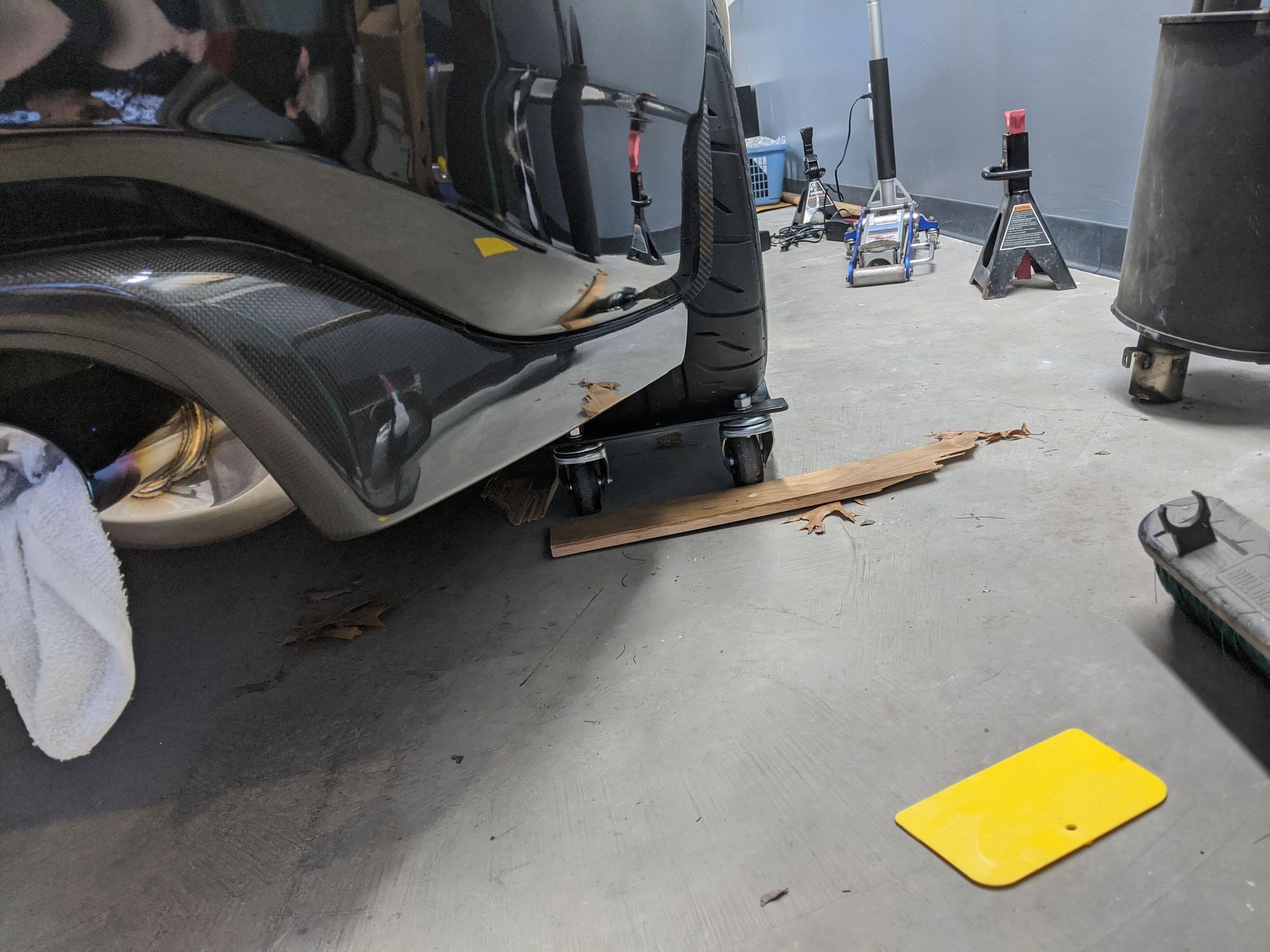

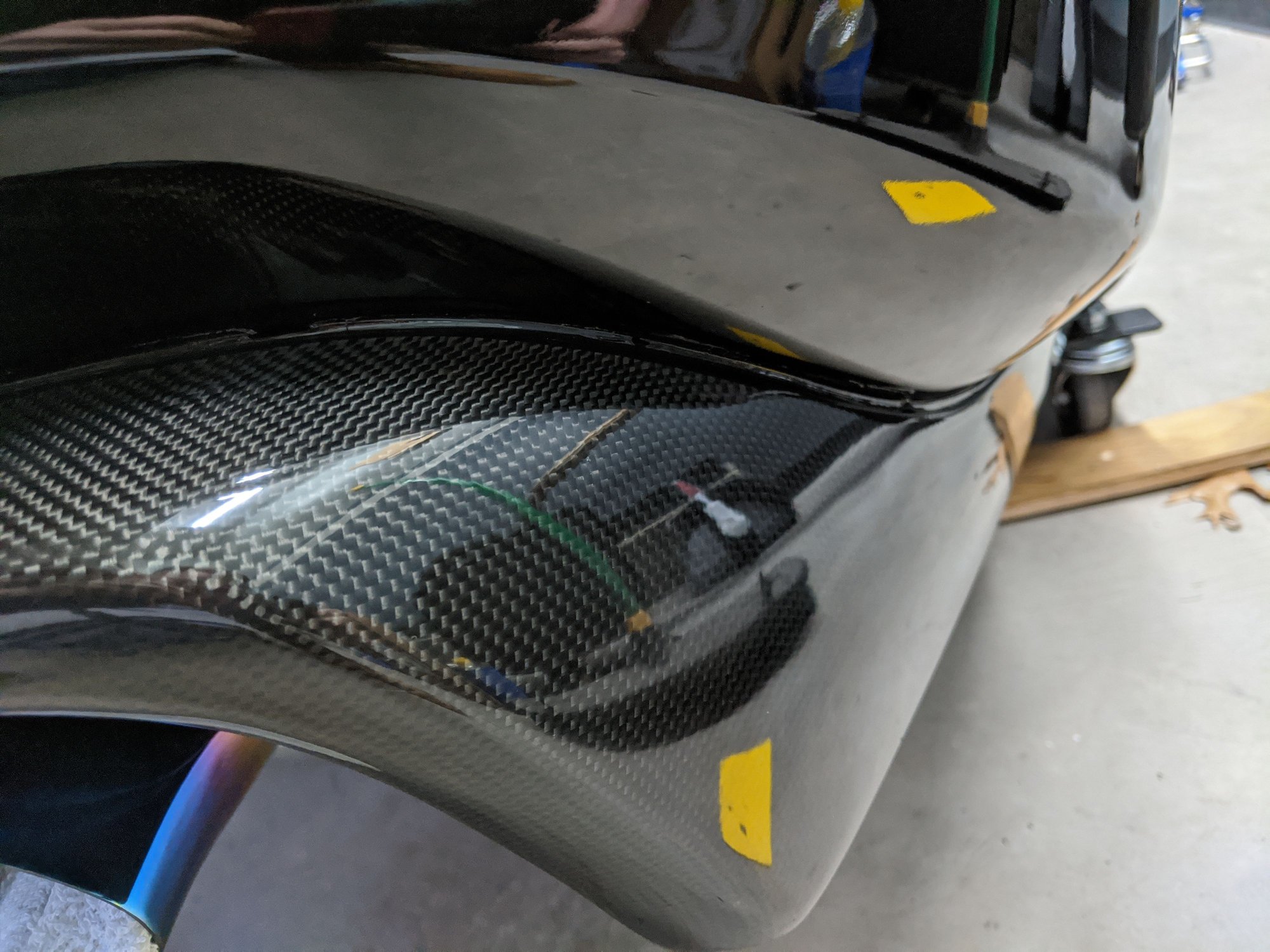

I ended up using black gasket maker. I put painters tape on the bumper and diffuser to keep things clean then squeezed the silicone into the gap. Then I wiped it away with my finger. I also used a pencil eraser to try to remove as much as possible. I then used a plastic razor blade to scrape away the excess. I'm happy with how it came out but if there is a pre made rubber one I'd use that. I just wasn't able to find one.

@Nivlac978 your paint looks good.
