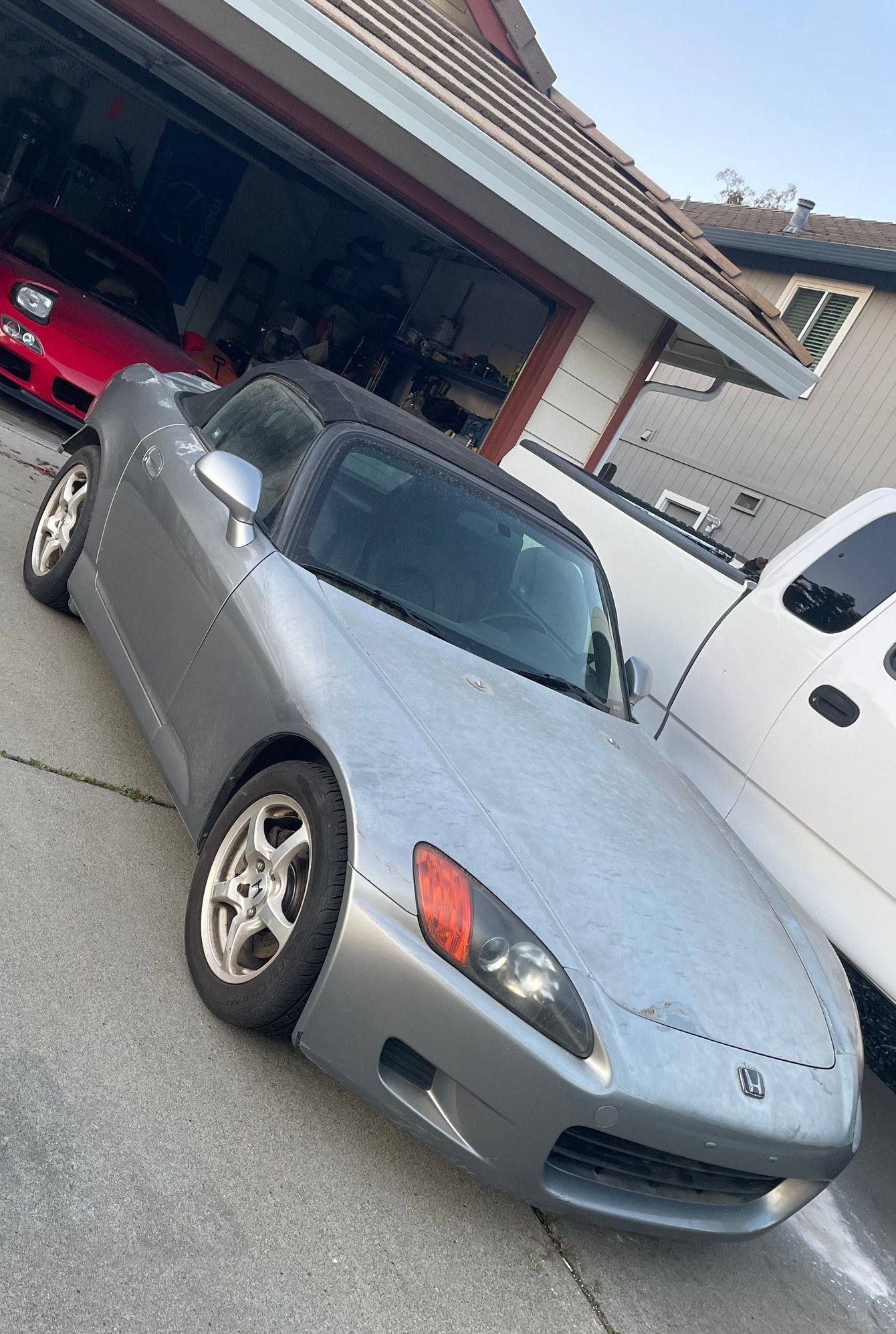

So plan with my car is to prep it for the 24 hours of lemons. Official rules are max vehicle cost is $500 with unlimited budget for safety (cage, seat, brakes, wheels, tires, ect.) while I’m gutting the interior and selling all the parts my overall cost for the car should be in the negatives. So I’m curious what would be the best mod for track use. I’m already planning on doing the valve cover mod. Would a bigger radiator be best since I plan on this car going a straight 24 hours? Is there something else I should be looking at for endurance reliability?

Yah I’ve already come to terms with the fact judges won’t believe me, even though I would be 100% honest with them. But I want to try to keep in the spirit of the race for the first one. The car is also not completely clapped out but it was not taken care of. The car also oddly looks cleaner being completely gutted and soft top removed.
