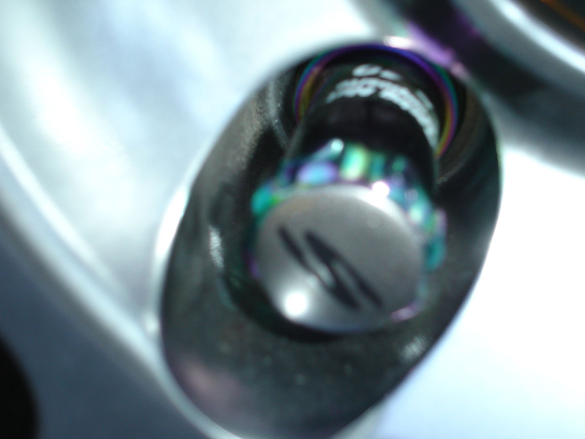

Old Jan 8, 2008 | 01:40 AM
Looter's Avatar
Joined: Aug 2003
Posts: 8,227
Likes: 77
From: Cincinnati, Ohio
......My "NUTS"......
Old Jan 8, 2008 | 05:01 PM
tbonesteak's Avatar
Joined: Apr 2006
Posts: 1,031
^^ what kind are they?
Kic's R-40...Neo Chrono's, with self fabed end caps......
