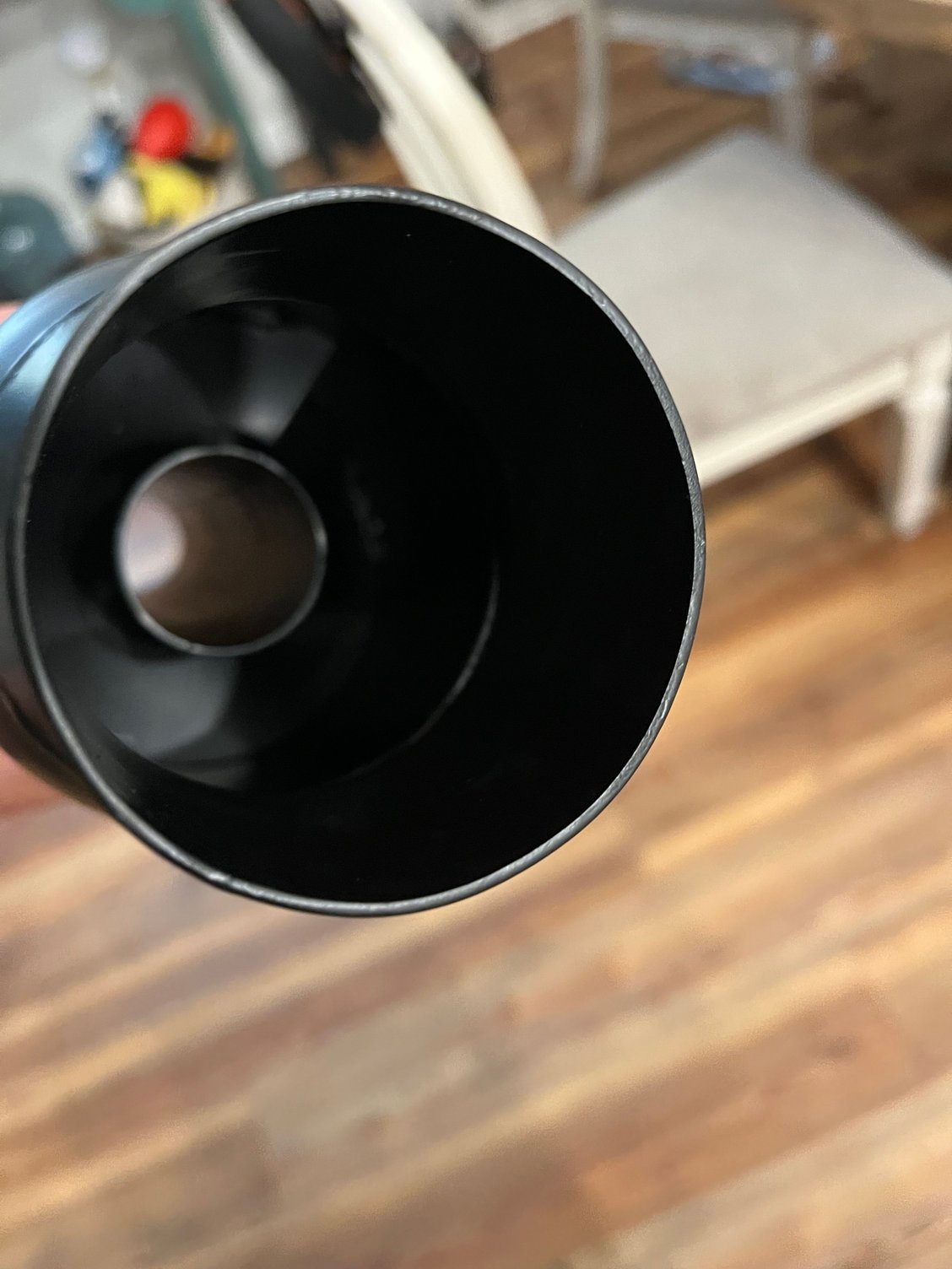

Got something in the post today…
Moroso spiral muffler. I know it’s nothing special but it is one of the key ingredients of my track pipe
Straight through center section design with a spiral outer bypass
I had 5 criteria for this system
1. simple
2. cheap
3. light weight
4. Free up a couple ponies
5. be loud enough to hear my car on the track but not make my ears bleed.
I’ll be dropping it off at my local shop to have them fab up the rest. Stay tuned if you’re curious.

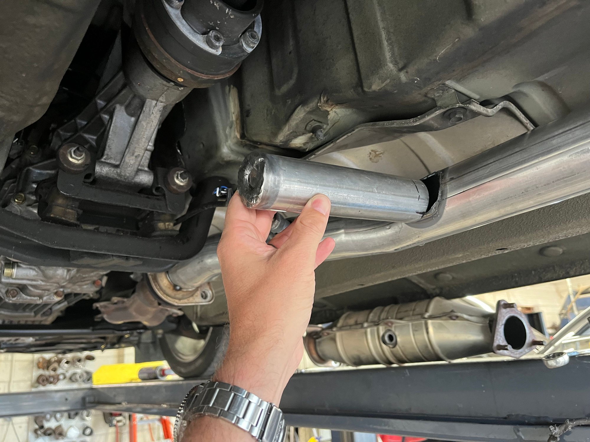

Owner of Top Gun muffler Dave, showing my how the system is coming along
Difference between my system and robrob is mine attaches to the header.
It will still include the T pipe for a resonator and an O2 bung to help with tuning later on down the road.
All that’s left is to finish off the tack welds and a lick of paint and she’ll be ready.
Dave kept telling me what a pain it is to remove the back boxes because of the hanger above the mufflers. I may need to re think swapping back and forth between the two systems for long road trips. I just don’t think I’ll be doing more than 1 road trip per year so I don’t think I will be swapping that often.

Those rubber hangers slide right off once you give em a shot of silicone spray

good to hear

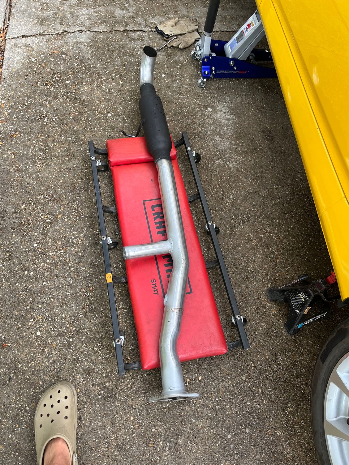

Took me less than 20 min to pull the track pipe off. It cooled really fast too. I think it looks like an RPG
Tucked away until the next track day
I had one guy tell me, “I’m used to s2k sounding sophisticated, your sounds angry. Love it!” There was a family there today in a 3series. The younger son asked if he could ride with me. He said my car was the loudest there. I wish it was the fastest. Good thing is I can swap it out in less than an hour. I did need an extra set of hands to get the stock system back on.
