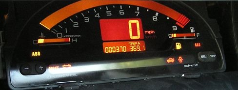

Someone broke into my honda s2000 and stole the cluster (and clipped the harness wires). My car has been in the shop for quite a long time since they’re having trouble finding a 2006 Honda s2000 cluster. They had originally put in an ‘05 cluster and everything was lit up error on the dash.
Can someone enlighten me? I was told it’s nearly impossible to find because:
It is only supposed to be 7000 rpms instead of 9000?
It must be from 2006 specific, can’t be ‘05/‘07
Does anyone know where else to look? Or why are there an abundant of 05 clusters everywhere but not 06? I wanted to be informed on this, but am a little confused..

I believe redline is 8000 rpm on an AP2 cluster, 8200 rpm is the fuel cutoff point.
Found an AP2 2006 cluster on ebay: https://www.ebay.com/itm/2006-HONDA-...4383.l4275.c10

The redline on an AP2 cluster is highlighted as 8000 RPM, I think the 2006 and 2007 cluster is the same and were changed to a different layout for 2008-2009.

AP1 had the flat temp and fuel gauge and higher redline.
04-05 had the lower redline, it also goes to half circles for the temp and fuel gauge. It also adds outside temperature.
06-07 has VSA, so it adds provisions for the VSA light, the plugs and pin-out are different. The redline is the same as the 04-05.
07-09 go to arcs for the temp and fuel gauge that continue the arc of the tach. Also adds TPMS and "power indicator." The plugs on the back look to be a similar shape, but I have not confirmed functionality if swapping to 06-07. Unfortunately I only have a 06-07 Electrical service manual, so I can't confirm pin-outs.
