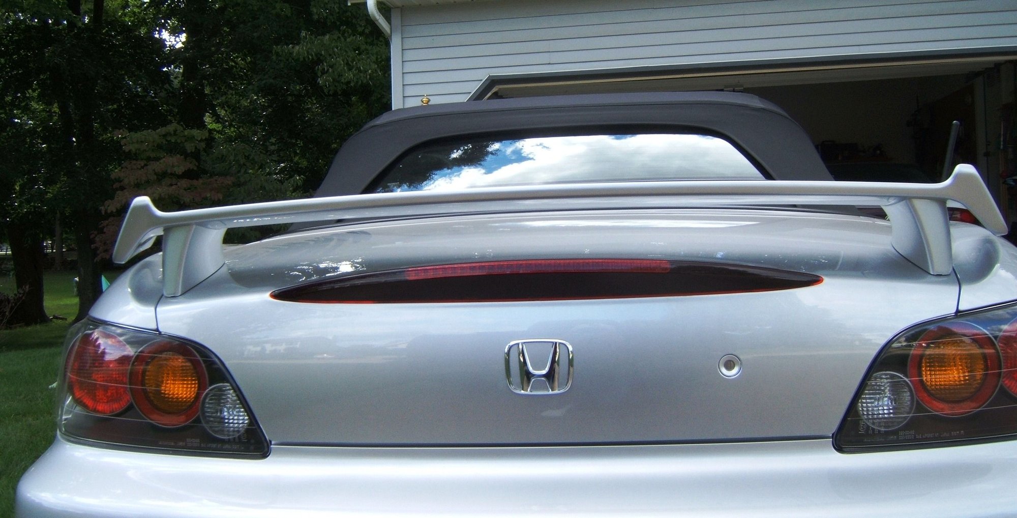

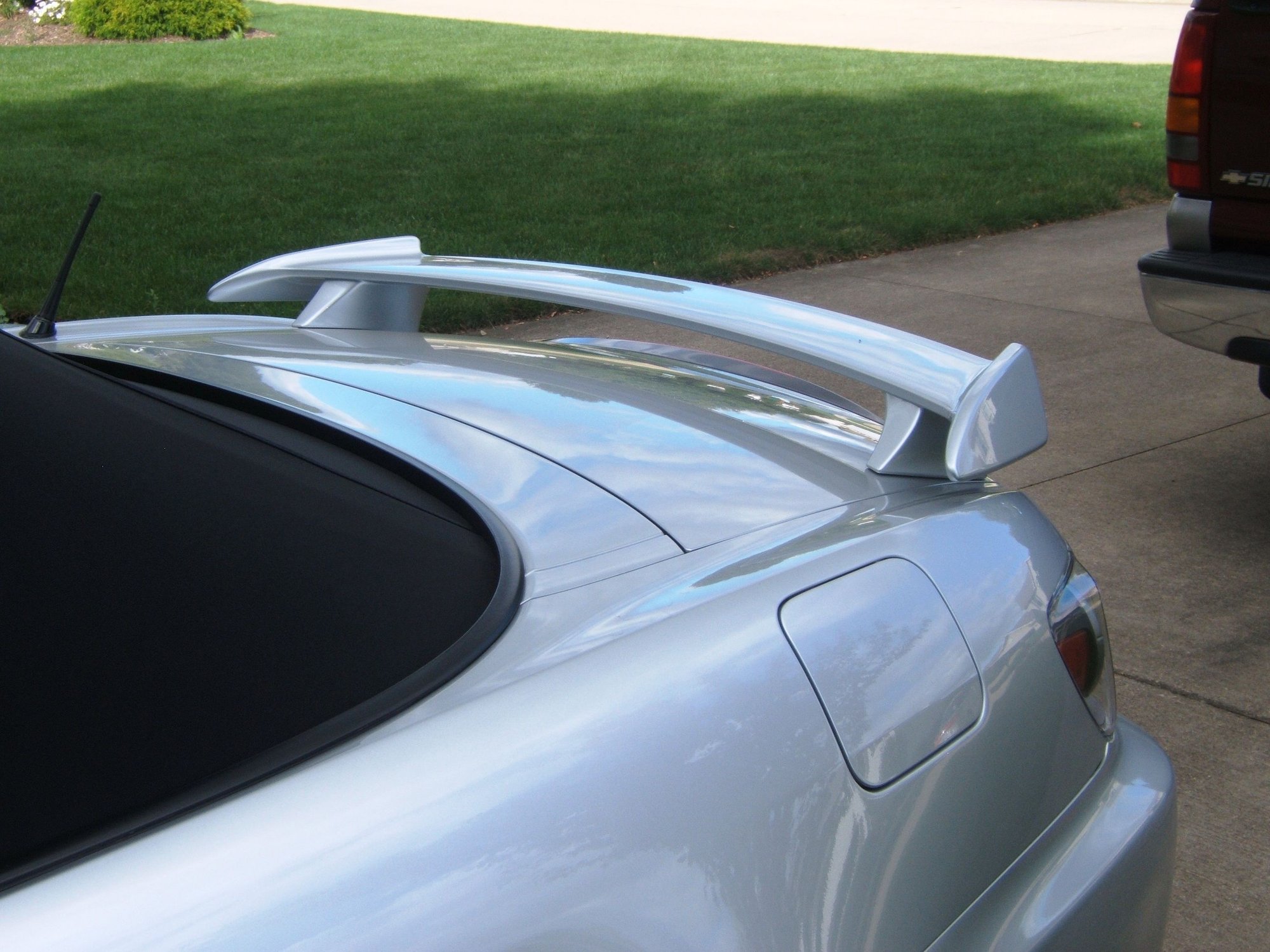

I have this wing and installation only took about 30-45 min.
I bought it from a friend who works at a dealership and he did the install for me. The link above that has the installation instructions is dead on and actually very simple if you have the template.
The only thing we did differently was after we drilled the holes we put a coat of paint on the bare metal of the hole edges.
Make sure when you put the trunk bushings back on that they are screwed in to the same depth as you took them out. If you don't do that then the trunk might not seal correctly.
I did change out the trunk springs for the newer heaver ones but the standard trunk springs worked just fine. He had the trunk spring tool and it made things much easer swapping them out.
If anyone needs a set of the standard trunk springs drop me a line and we can work out a deal.
Here are 2 pics of the installed OEM wing
Good luck.
