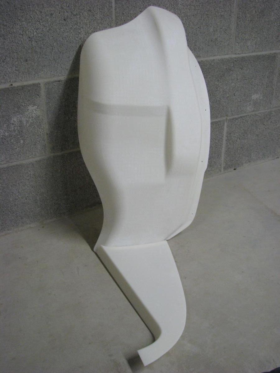

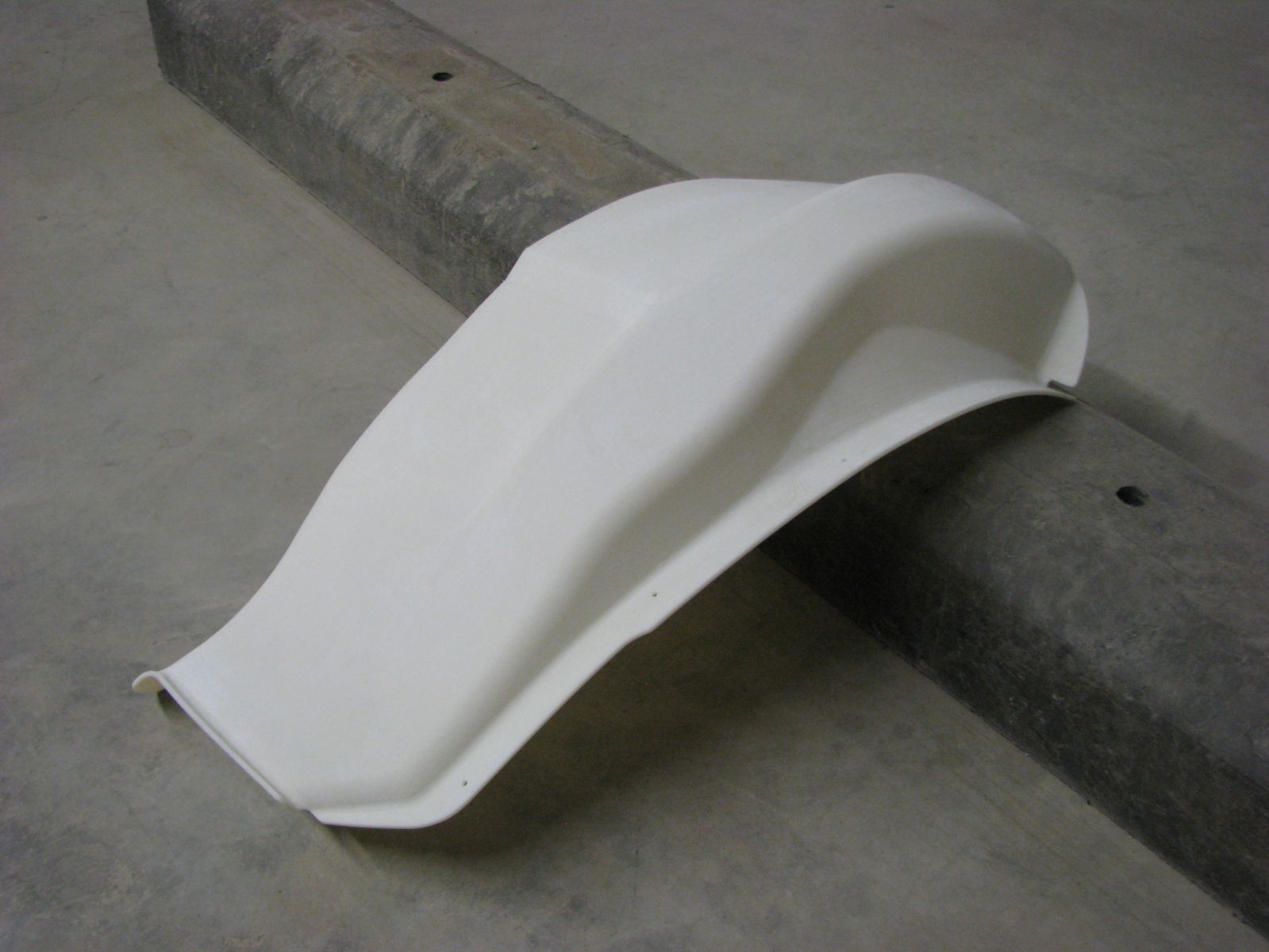

I have now received the Rapid Prototypes of the RH versions of the liner and underliner and am "over the moon" on the Form and Fit. Remember, all the design work was done on the LH side of the car on the assumption (after very close insepction) that the RH and LH are mirror images of one another - they are!!!!! The beauty of CAD. Have posted photos in the HS2K.RLS gallery. Production will be in 'sand' finished black HDPE so the match up with the existing fender trim will look great.Thickness of the thermoformed parts will be slightly thinner than the rapid prototype because of the nature of the production process. Now just need to get the interest level up to justify taking the next (expensive) step. Cheers to all.

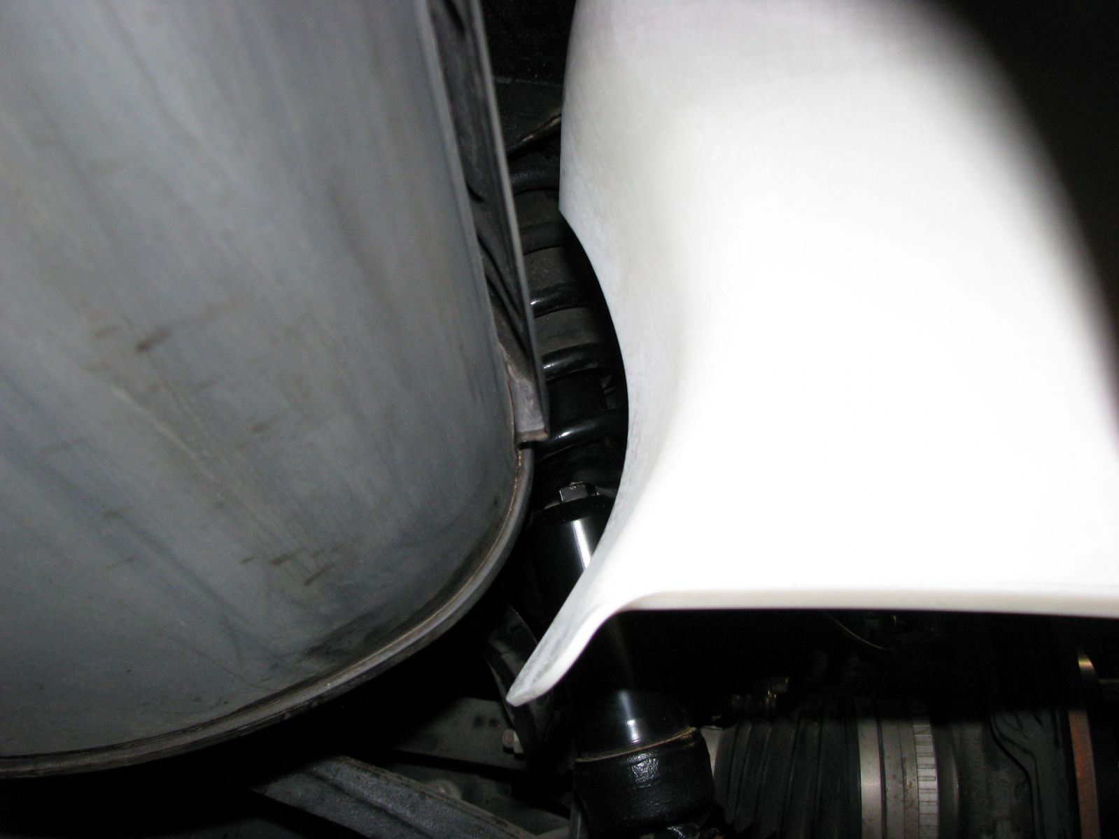

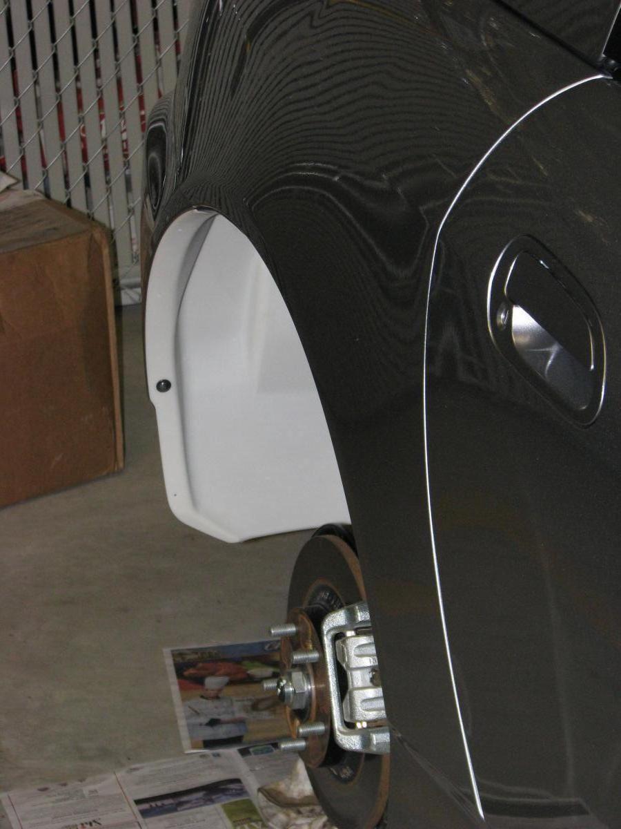

These are some of the photos posted to my gallery Feb 24,2011 showing the Form and Fit test results of the RLS rapid prototypes received Wed of this week. I am very happy. How about you?

Follow up and to anticipate questions in this regard - I personally will use a 1/4" x 1/32" piece of double sided tape (available from any good model shop) between the liner and the edge of the bumper to ensure that that interface is tight. Also note in the pictures that the liner is being held in place by the regular bumper mounting screw only - it is that snug to the inside faces that it doesn't require more than that to keep it in place in a static condition. It was my intent that 3 additional screws would affix the liner to the face of the bumper skin (you can see pilot holes for those already in the RP) as well as 3 screws into the sheet metal inside along the small flat faced surface that runs accross the liner (if you look at the picture of the "behind" view you will see the sheet metal face hanging down about 1" from the box above it) so that you would have access to the backside of these screws/bolts if you needed or wanted to. These holes through the sheet metal would be lined to prevent galvanic action (rust), or the screws would be some sort of non conductive material (perhaps ceramic) for the same reason, with larger washers (like the present bumper mounting screw) to spread the load out around the hole and prevent fretting of the hole in the liner. So that is all the mounting "secrets" exposed. Cheers

the design looks very well thought out and the quality according to the pictures look great. i would be interested in something like this being that it would save me a lot of rocks flying up onto my diffuser. i would have to cut down some of it to accommodate for my wider wheels but i would be hard pressed to believe you are going to be able to drum up enough interest to offset your cost if your price point is 250-350 on a production that would have to be much greater then 100. with the demographic of this board and the price point of the s2000 now its going to have to be closer to $150-200.
