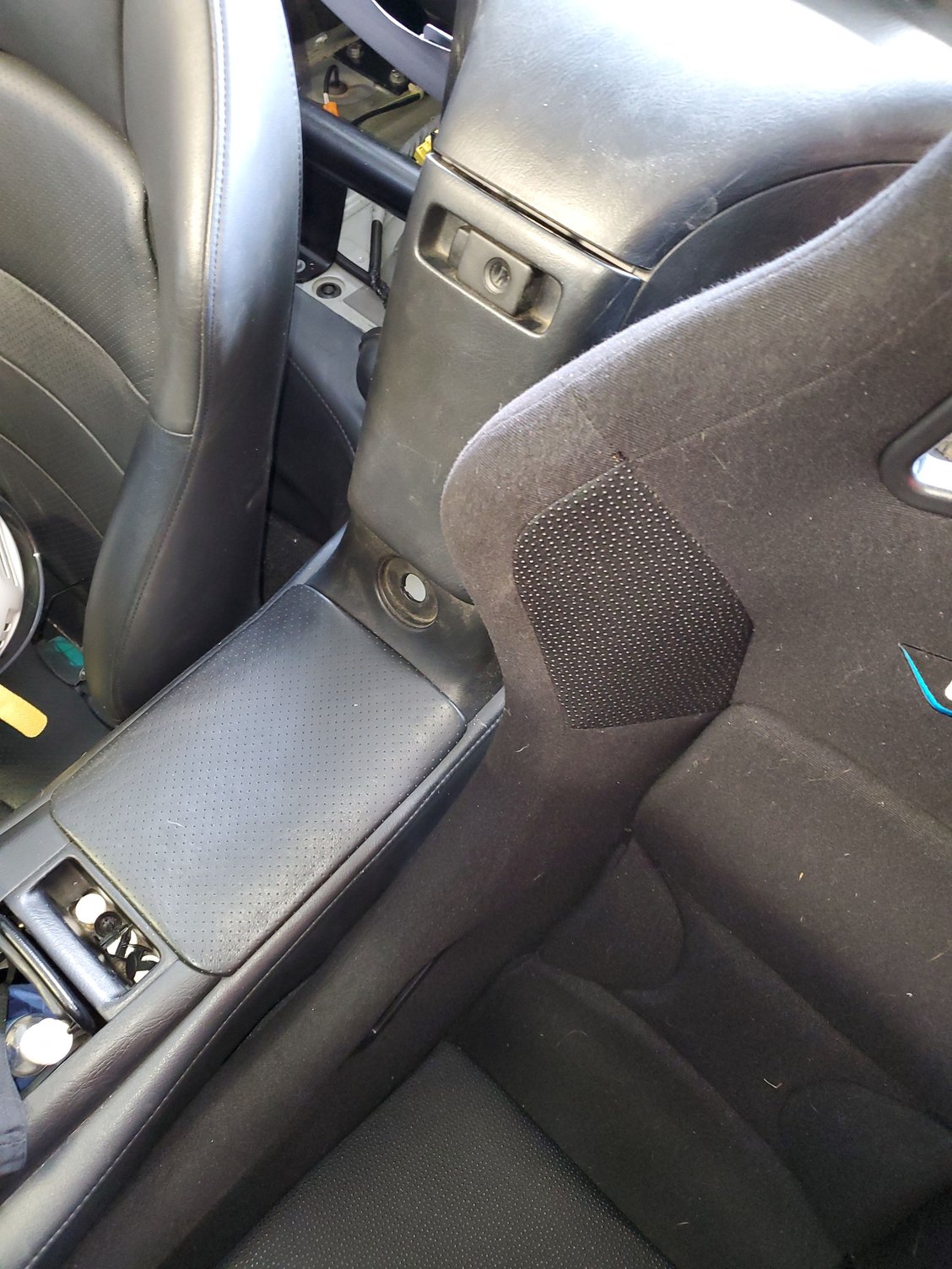

Hello all,
I've been Lurking around the forum since buying my AP1 last August. Having a 18 year old car it seemed most of the answers I needed were already out there. I was compelled to make my first post to share my experience with a little discussed seat, the Sparco QRT R. Being 5'10 245lbs with wearing a 38x30 pant most easy to fits seats were out. All the big seats seemed to have fitment issues. I found a Sparco Evo 2 US and committed to cutting it up to fit as i had seen talked about. Them something bugged me, why pay for a FIA seat if im gonna cut it up and void that rating. Im not doing wheel to wheel but it just wasn't the way I wanted to go (no disrespect to those who have).
After Dry fitting the Evo 2 I realized the only thing it really needed was 1/2" bolster width and 1" shoulder wing reduction. So i set out to find a seat with the same butt capacity. After looking at a bunch of seats I landed on the QRT R and despite is rating for "up to 36 inch waist" the measurements looked very much the same as the Evo 2 us with 22 inch (down from 24) shoulder width and narrower bolsters. So it arrived today and I sat down and it was perfect felt like the same seat. You lose the slightest amount of leg spread capability but thats it. Mounted on PCI adjustable rails its fit perfectly in the car with no modification. The center console opens and the door barely brushes the seat.
So long story short this is a great alternative seat for guys up to my size (taller is not a problem except for head clearance). IF you fit a Evo 2 Us, Corbeau Fx1, or are sqeezed into a pole position id check this seat out.

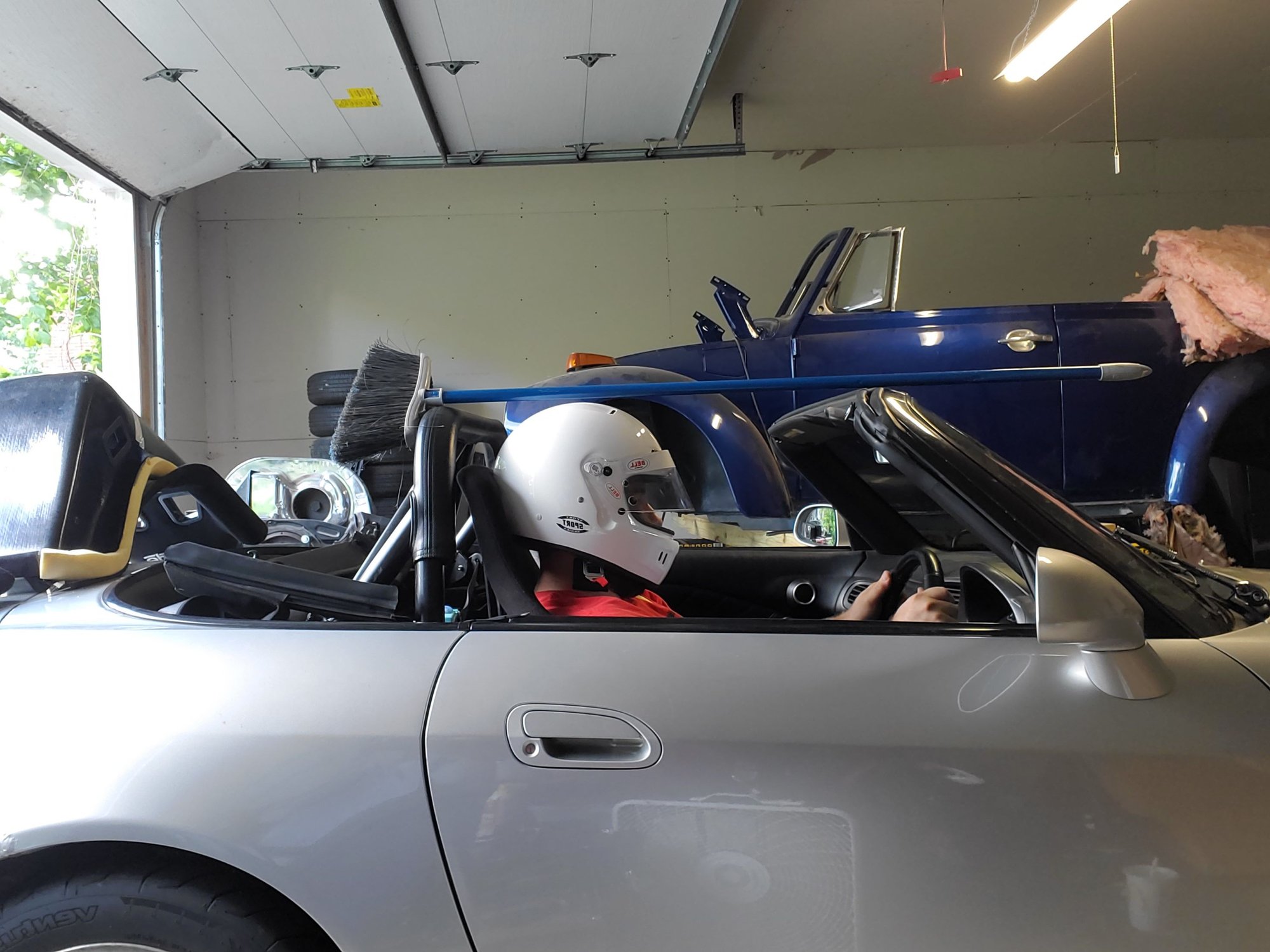

Examples of my \"size"
glamour shot

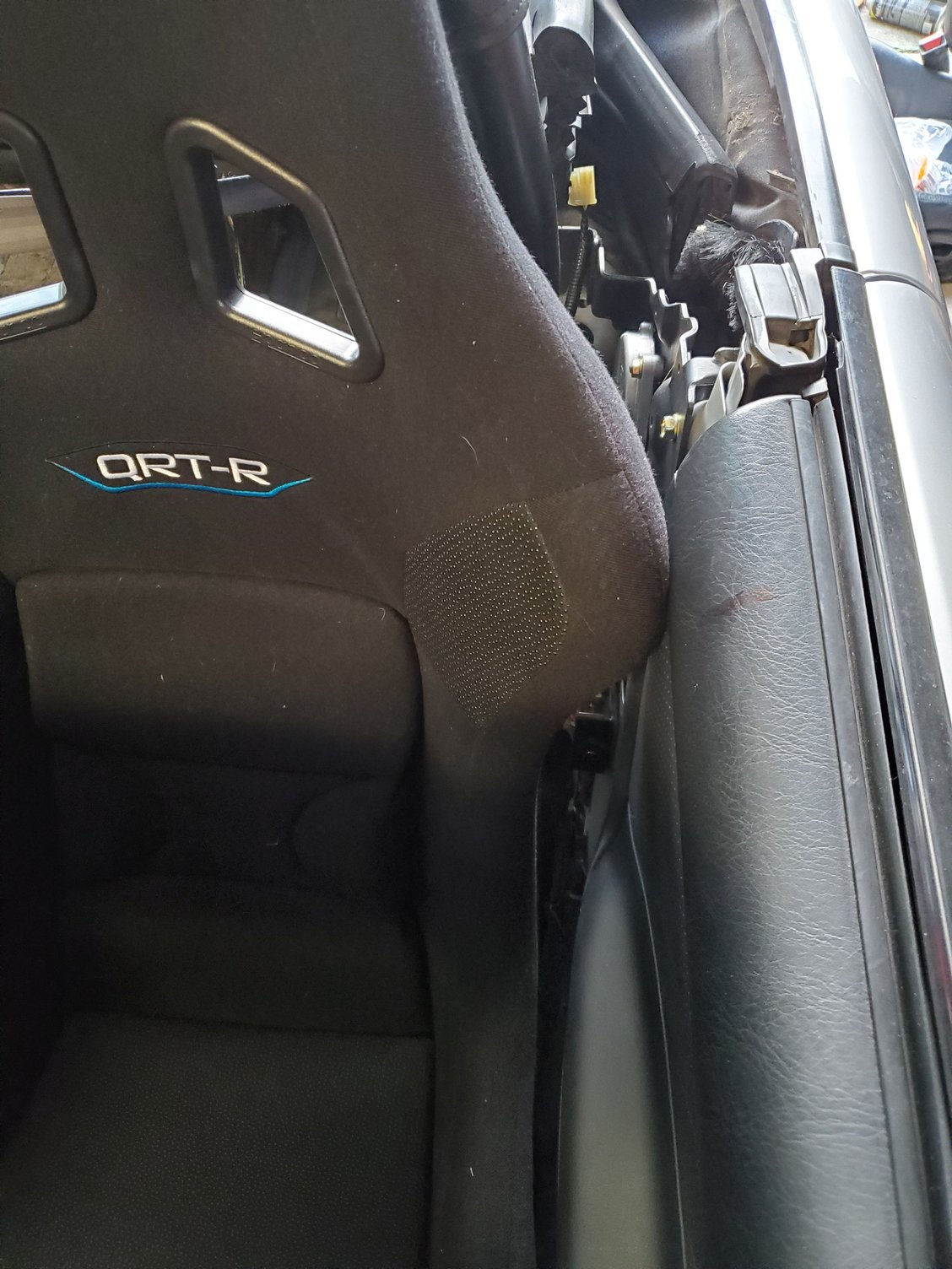

Just barely touches door
no need to cant the seat left to fit between the door and tunnel

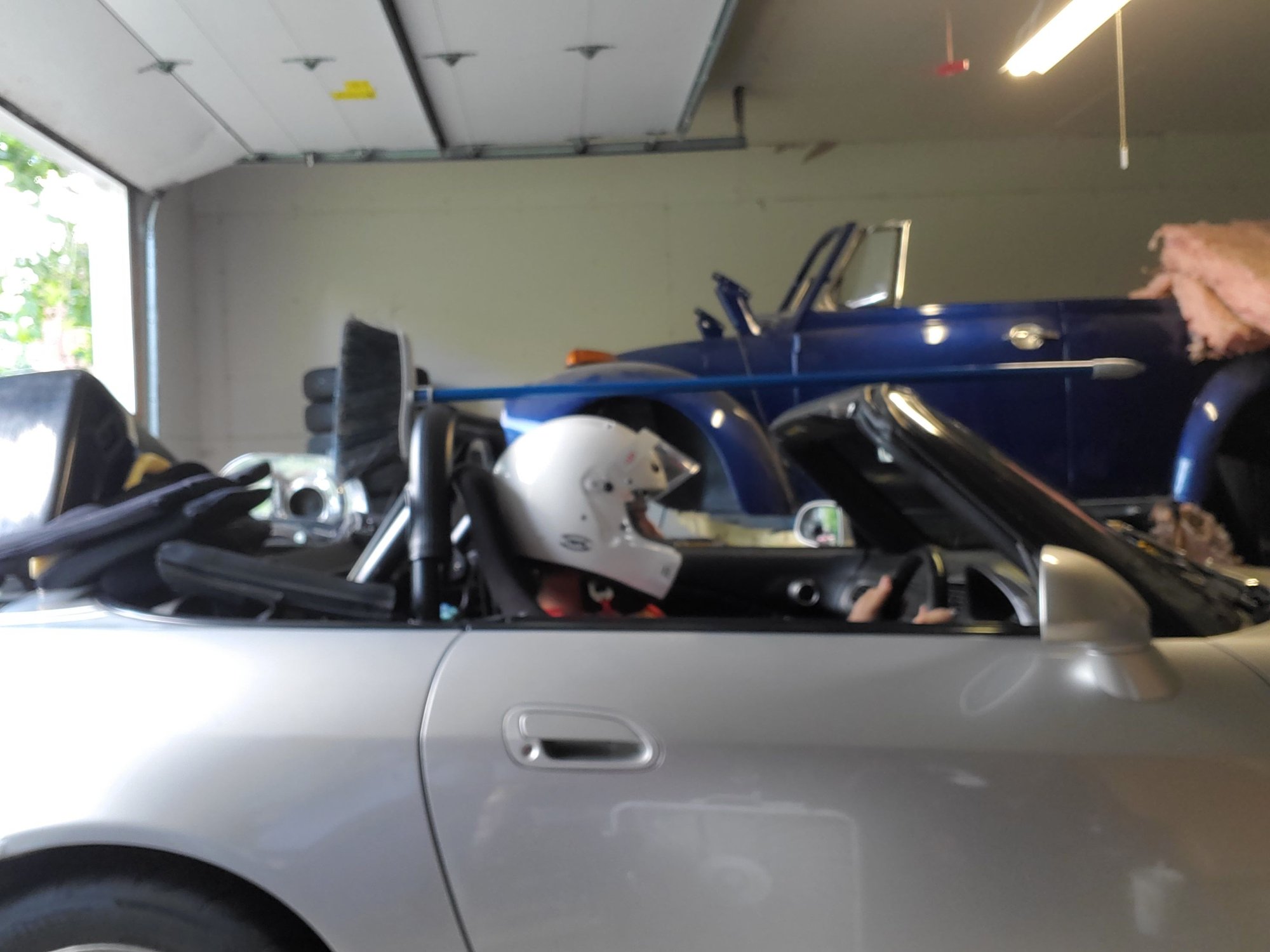

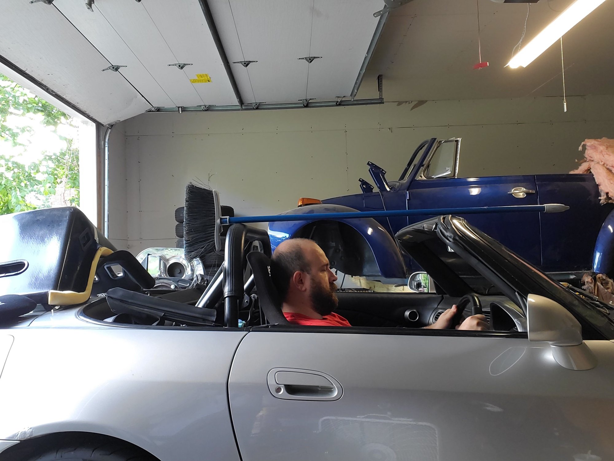

With helmet on i have a 1 finger gap
If you remove the seat padding (which i will do for track days) i get 2.5 finger gap matbe a littl more
No console blockage

That being said i chose this seat for track/weekender so i think this seat is perfect despite those two things. One thing to consider that i have run into is that if you are under 5'11 with 50/50 torso/legs, or have a short torso the harness holes may not work for you. IF you are slightly to tall for Recaro PP you MIGHT be to short for a QRT-R. I am very close to not working but I am fine with my Hans on and that's the only way i'm using the harness holes anyway.

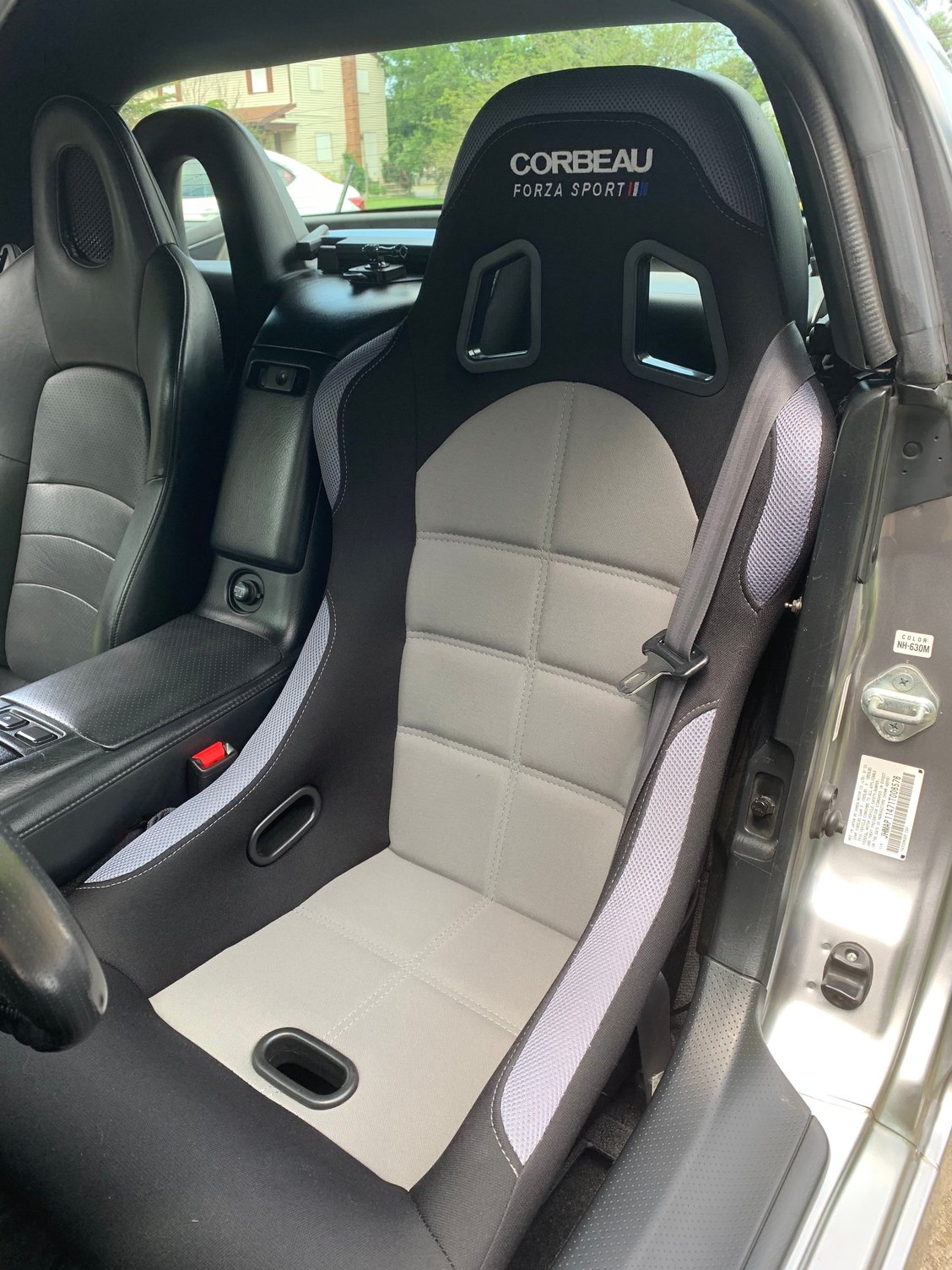

Good to know! Im not too dissimilar in dimensions and ran into this issue a year or so back. I actually fit somewhat comfortably in Pole Positions but the shoulder harness holes were far too low on my back to make sense with a harness, then I came across the Corbeau Forza Sport. Fits the car great, I fit comfortably(even on long trips, most trips to the track are 3+ hours long) FIA cert, but of course they discontinued them(and I only found the one, have been looking for a matching passenger seat but no luck). The QRT-R caught my eye at the track about a year ago, but I havent been ready to pull the trigger yet but has certainly been on my radar. Happy to hear they work well in the car and on a *particular* body type.
