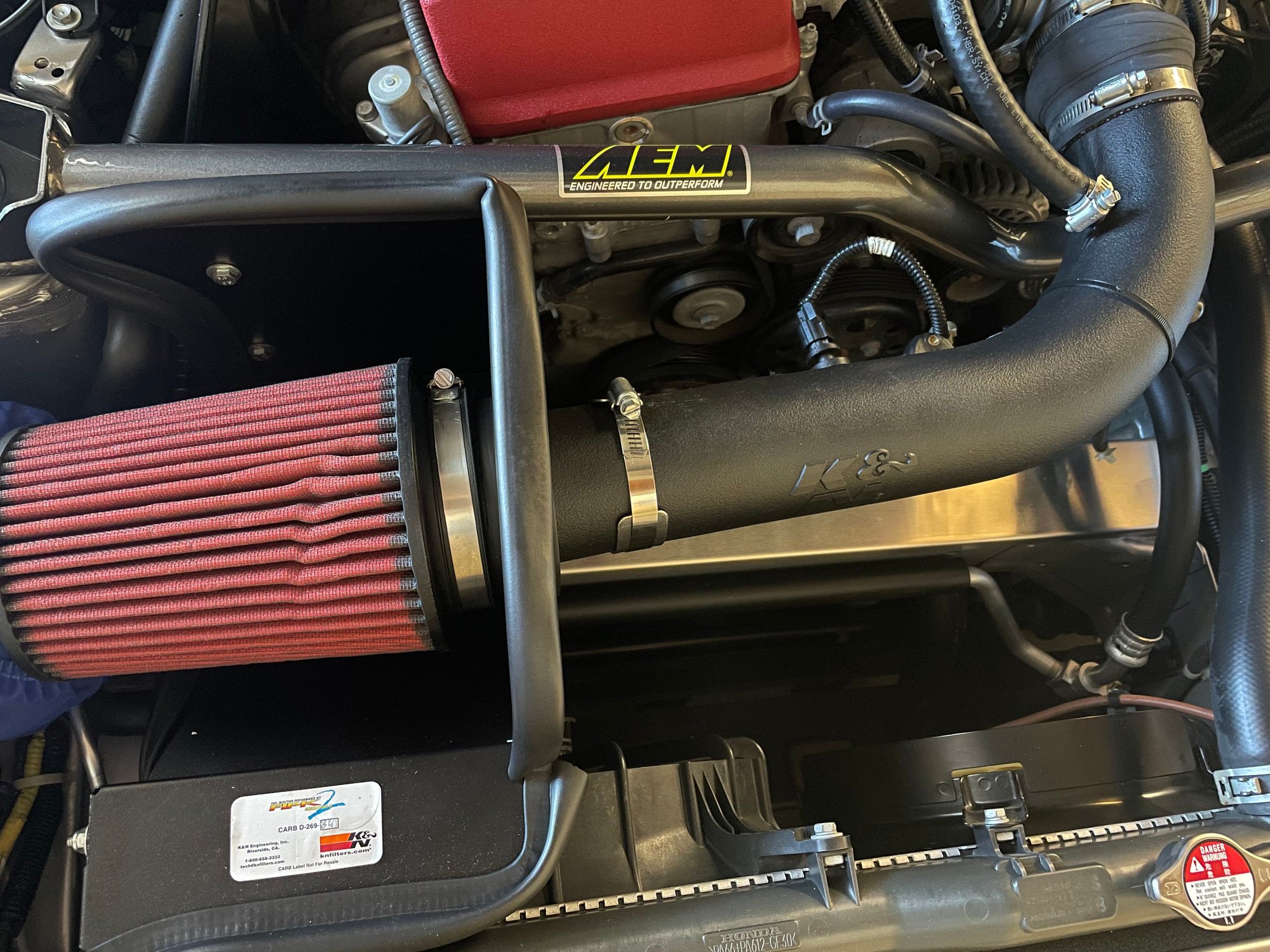

What CA wrote: Consensus here notes they do nothing for the car other than a place to lean on when checking the oil. Before I knew better I fitted one within in days of buying the car and it "looks good" under the hood. Fitted the K&N FIPK the same week but at least that may add 1 or 2 horsepower.
