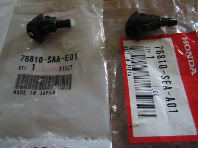

If you're looking for the mist spray instead of the squirt like the s2000 I believe people used the Fit/Jazz nozzles to good effect. There's some threads about it on here.
https://www.s2ki.com/forums/uk-irela...r-jets-997542/
Part number is 76810-SEA-A01. There's another listed, but that one is only available in other regions; the part number I posted can be ordered from a local dealer. Note though that they do not come colored, so you'd have to get them paint matched, or leave them black if you don't care. Make sure to transfer over the gasket on the bottom of your original squirters or they will not fit tight.
Only difference between the 76810-SEA-A01 (Fit, TSX, Accord etc) mentioned here, and the 76810-SAA-A01 (Honda Jazz) is the color of the actual nozzle. The Fit one is all black, the Jazz one has a silver nozzle.
Picture taken from that thread:

Ahh perfect! Thanks man
