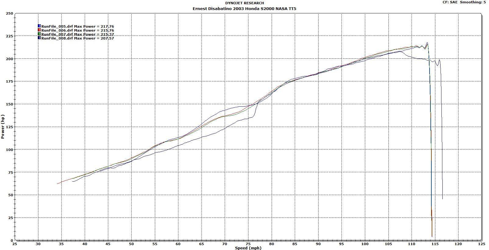

Here is the DynoJet plot:
Blue Run 005: Custom Intake tuned
Red Run 006: Oem intake on same tune
Green Run 007: Oem intake on same tune
Purple Run 008: Oem intake on Stock ecu

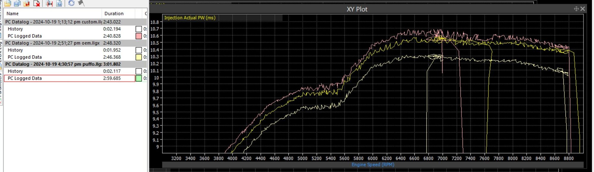

Here is the Injector PW from the Virtual Dyno Pull:
Pink: Custom Intake
Yellow: OEM intake
Green/White: Puffo Intake

I think part of the issue when we are talking a few hp, is sample size. I kinda take these types of intake tests with a grain of salt due to that. When testing you need many samples of each setup and then average them to get a good set of numbers. So many variables at play. Example... at the last dyno day I attended, we only got 2 runs. Car never moved off the dyno, same conditions, etc, on a Mustang Dyno. My car made 224 on one and 227 on the other pull. So there is 3hp variation with back to back pulls with it never leaving the dyno, on a good dyno setup. Unless a ton of pulls were made and averaged, I consider a few hp to be in the noise of variability. And on the street, the variable count goes up further.
I think the most you can take from this is that you do see a change in AFR requiring more fuel with the custom intake. That does indicate that it may be getting more air in. And it is getting cooler air which also indicates it is likely working better. So that is some indication that the custom intake may be better. Now how much? Likely less than 3hp but not enough samples to tell.

Pulse width is a good measure (assuming equal afr) of actual airflow (ve) for the engine.
