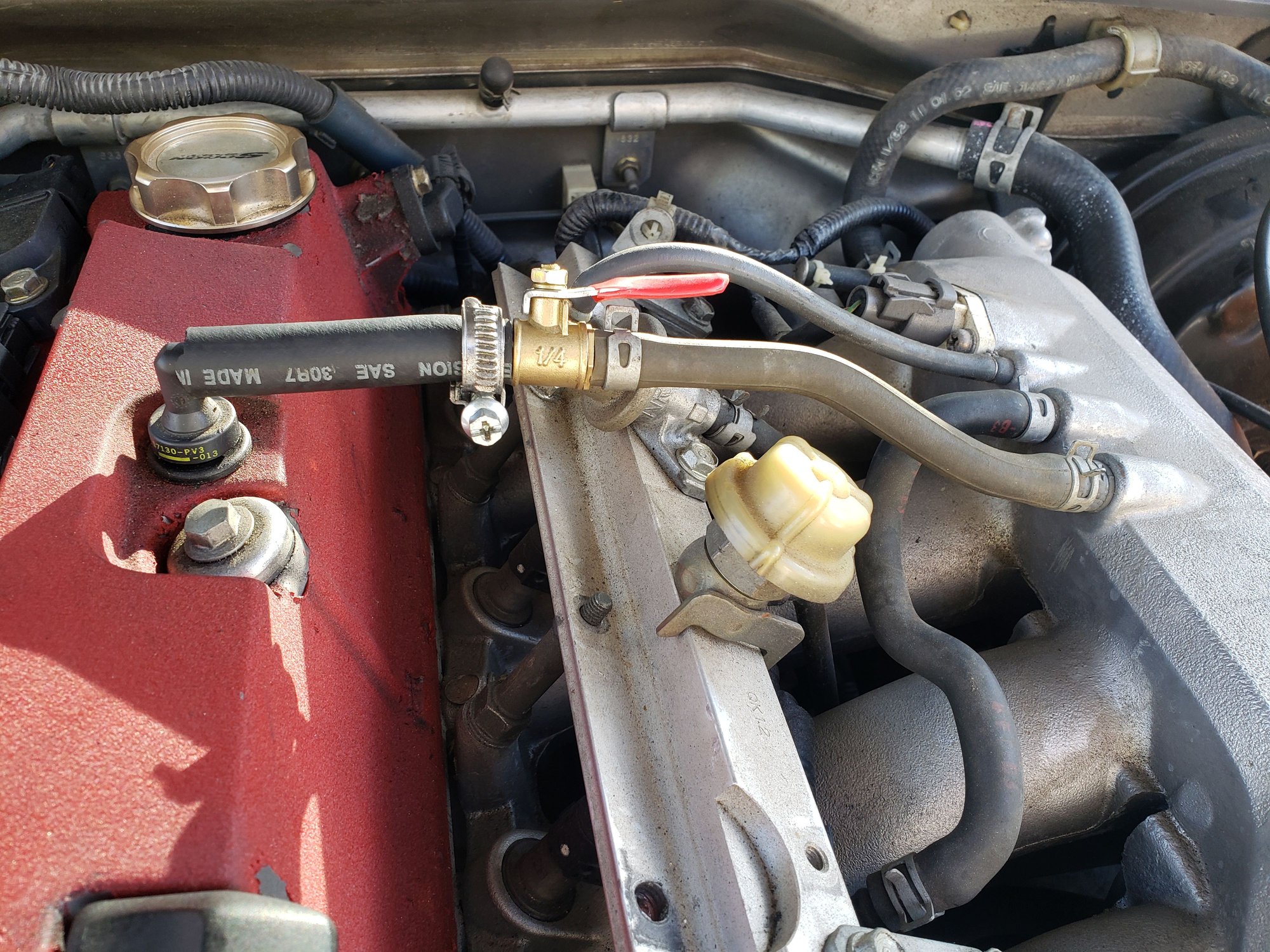

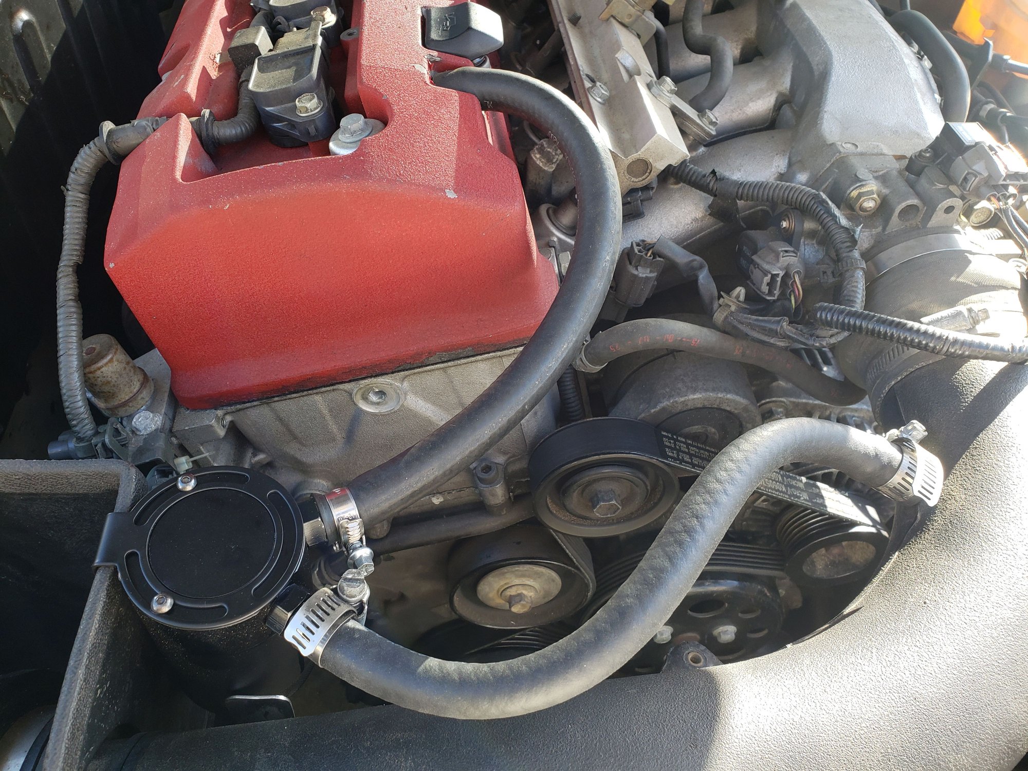

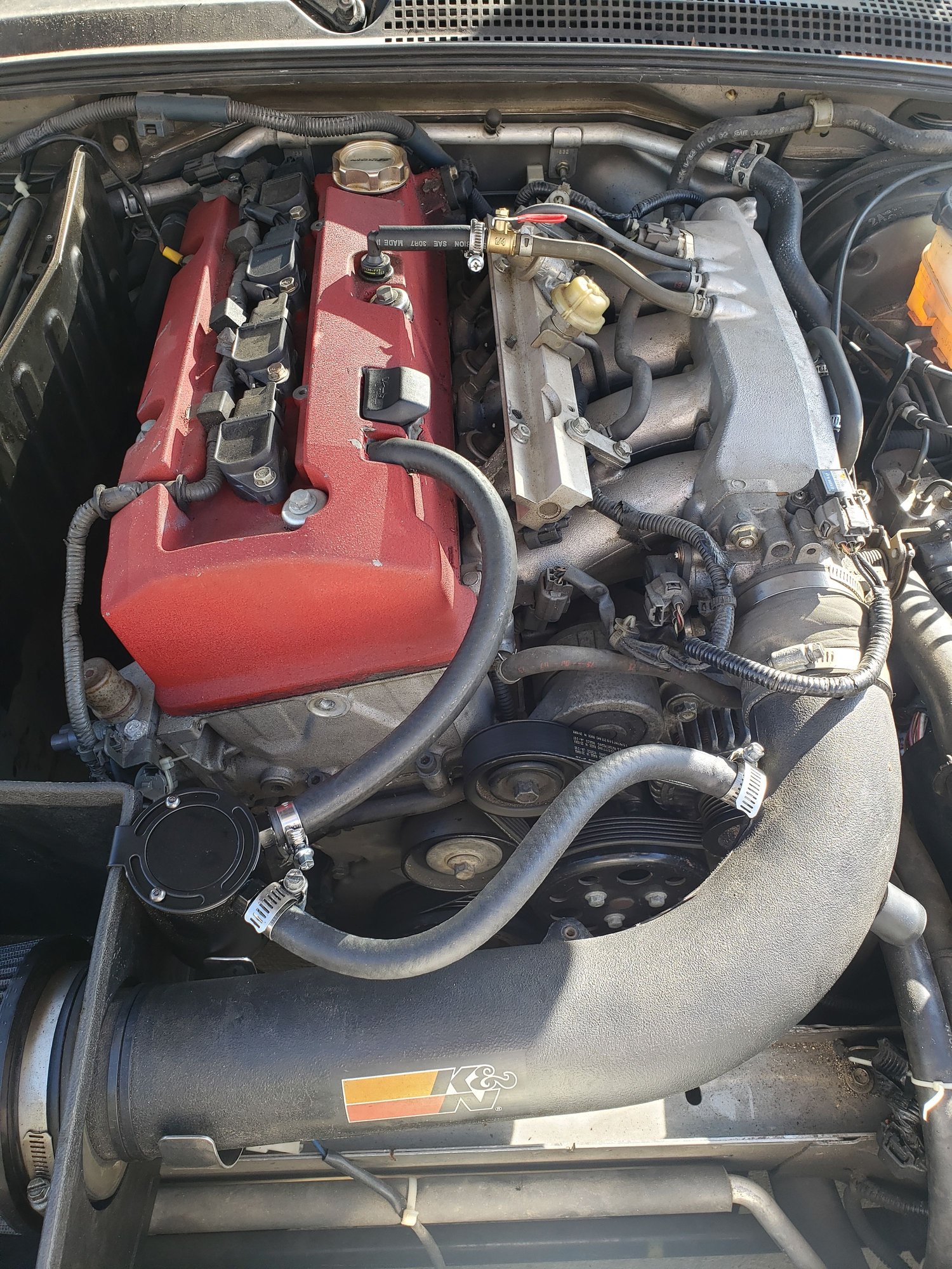

S2000's smoke realy bad at my local track Roebling Road. I was running a catchcan with lines from the PCV and breather and vented to atmosphere but didn't like the fumes driving to the track.
As I understand the PCV doesn't do much on the track it works at low rpm's and idle - my cars been acting funny and seems to work better driving around normally with the PCV enabled.
So my new setup I put a cheap ebay catchcan on the breather and a switch on the PCV to turn it off at the track.
Ran three sessions the other day and didn't smoke at all that I noticed. The catchcan caught a fair amount of oil I am not sure if it filled but I might get a bigger one to be safe.
Found some oil residue in the intake tube and throttle body but not a huge amount and no smoke.

I always found the pcv hooked up to vacuum sucked the most oil in my AP2. I have stalled the engine because there was so much oil in my intake. I have only seen boosted cars discharge oil through the breather when the pcv is routed to the intake mani.
