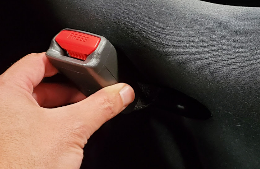

I did find an answer to my seat belt extender question. GM Part #89024730 is an extender for a Chevy HHR that fits and has the aesthetic I was looking for. They used to be free at dealers but have been discontinued and only available via resellers on Ebay. I'm still waiting on the rails and seats to come in. Seats may not be until November. Also, the items from Schroth that I need to complete my receptacle setup are on back-order. I'll try to post what I'm using and the end result should be the picture in my first post.

I got a seat belt extender from Ford for free for my 07 a few years ago. I think you need to ask them for an 05 Mustang seat belt extender

Azn_akira - Happen to know the Part number for info's sake and a visual? I was being picky but since I was paying for a receptacle anyways, I wanted the one without the separate metal bracket attached. The GM Part # I posted is what I was looking for. Already bought them, unfortunately.
Sorry I don't have the part #. I just called my local Ford dealer and asked for one, they didn't have it in stock but they were able to get one in about two days.
Sorry crappy pic but the end of it has the metal connector like pic#3 in your original post.
