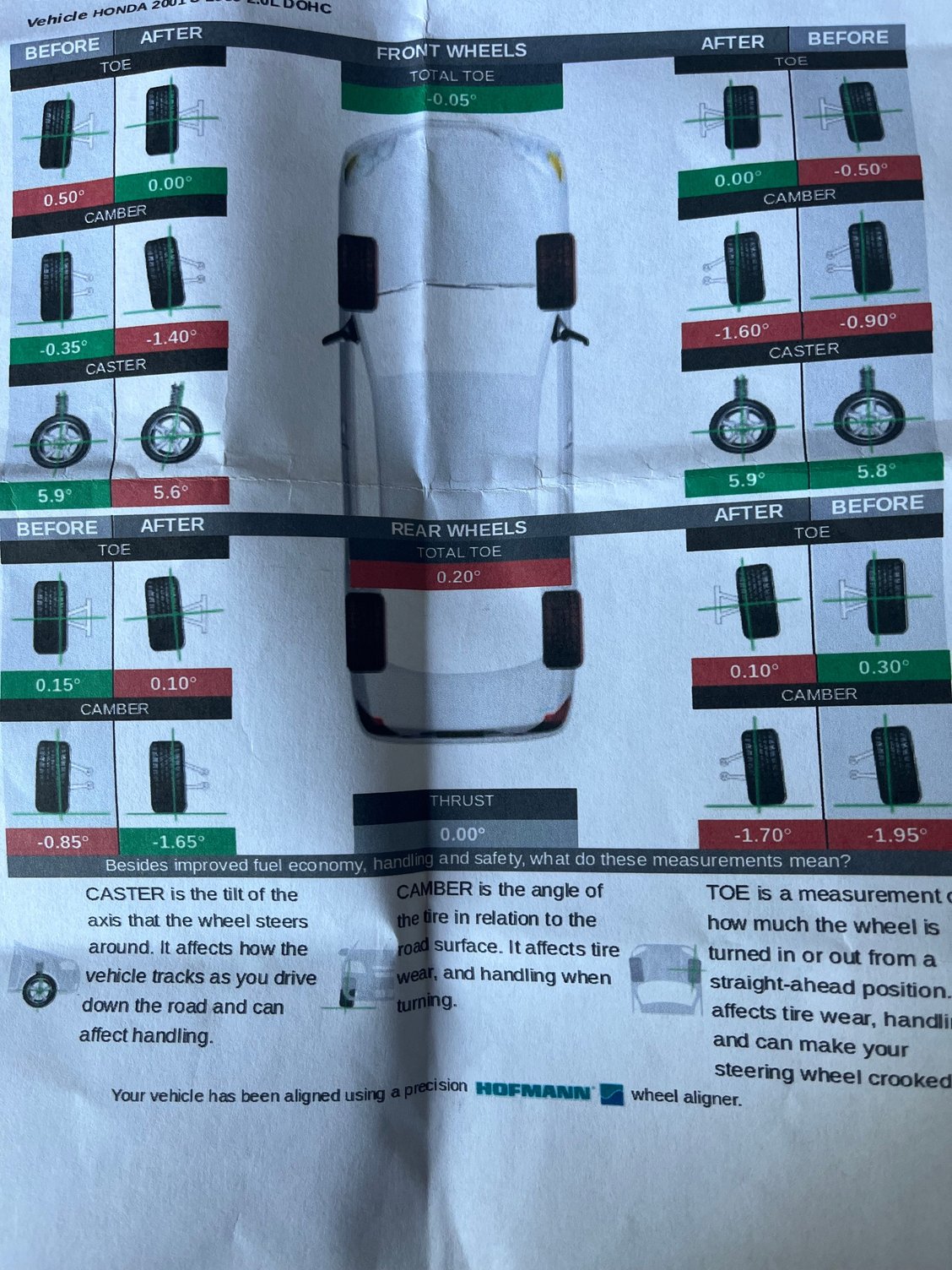

Got my alignment numbers set up today, pretty happy with the results. My old setup (ap1 wheels and crappy tires) was pretty slidey. The new (to me) ap2 wheels and decent rubber was an improvement, and now with my camber filed in, I need to push hard to break the back loose. Looking forward to my next autoX event later this month.
Pretty pleased with the results

Of note. I am noticing my back right tire breaking loose easier than back left. What is odd to me is it starts with a silent slide. I am going to check my tire pressures but something seems off.
could my settings be off?
