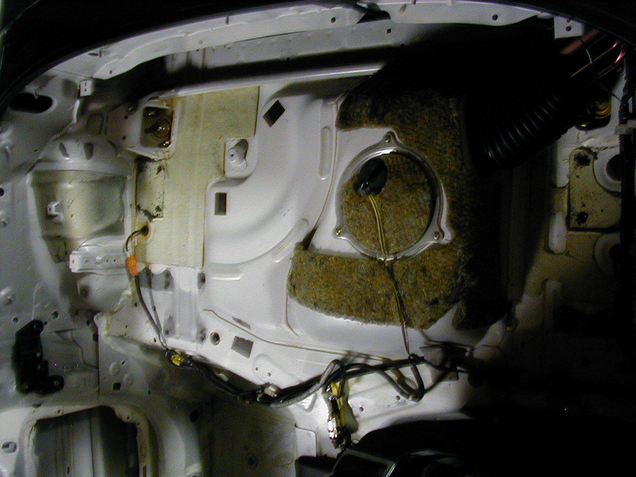

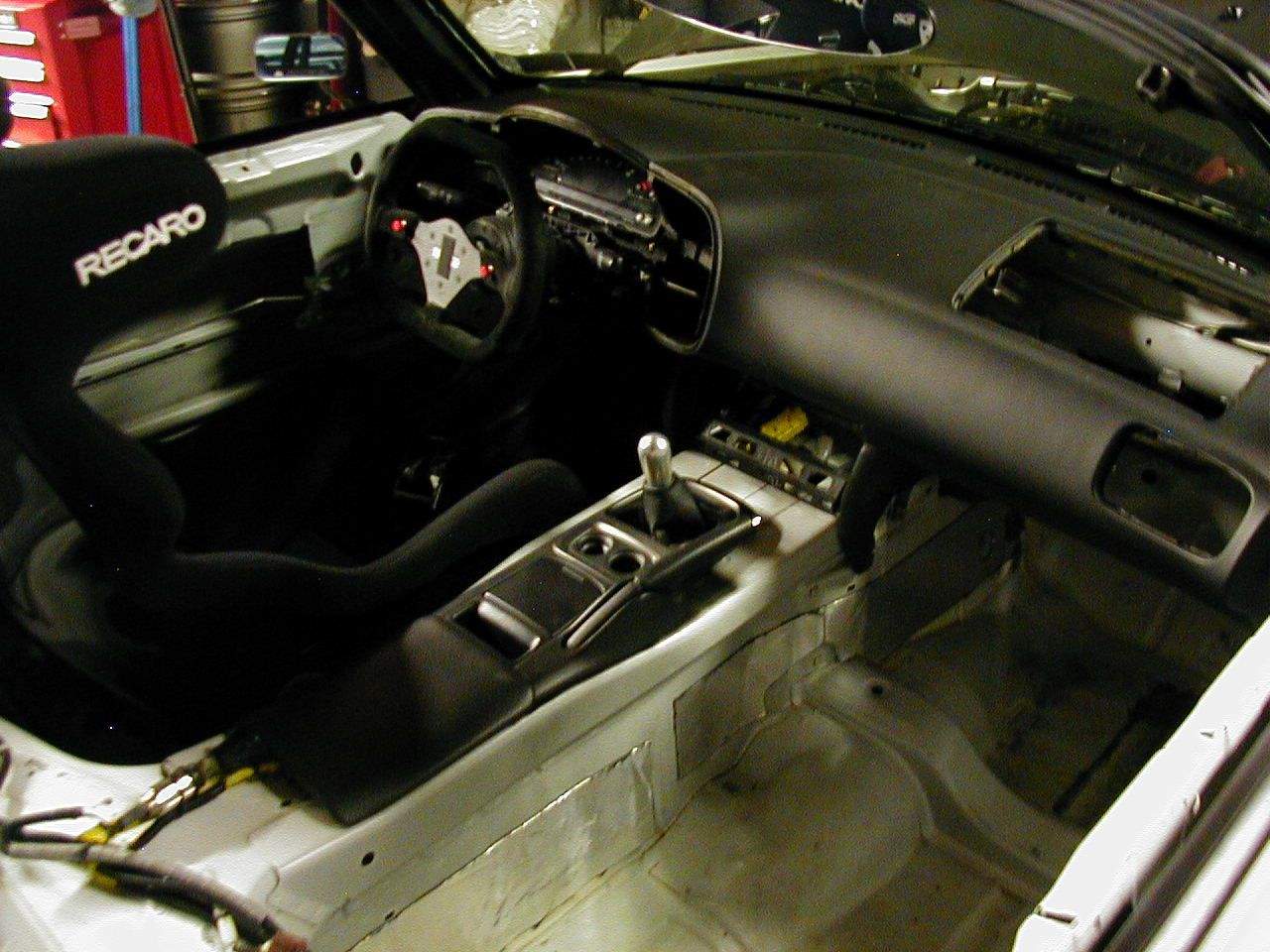

So I tore the ELDA bar out and gutted the interior. Sorry but my ELDA is spoken for so I can't entertain offers but at this point I think I could get big money for it. The ELDA is a very good bar and I hope it can be back on the market again in the near future. I know there are plenty of track enthusiasts out there that have the cash to buy one and are willing to spend it.
and the doors leaving just the latch mech for the drivers side.

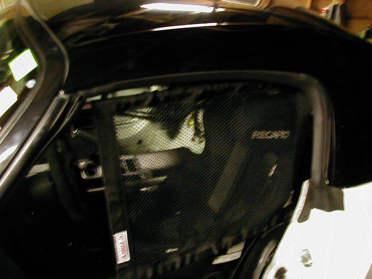

Pic is shaky but window net installed by roll cage manufacturer. Looks nicer than something added on after cage is built.

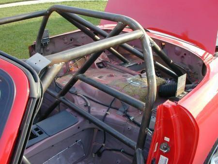

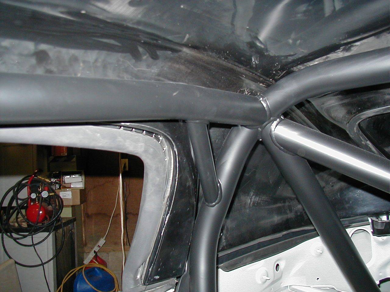

Roof bar.

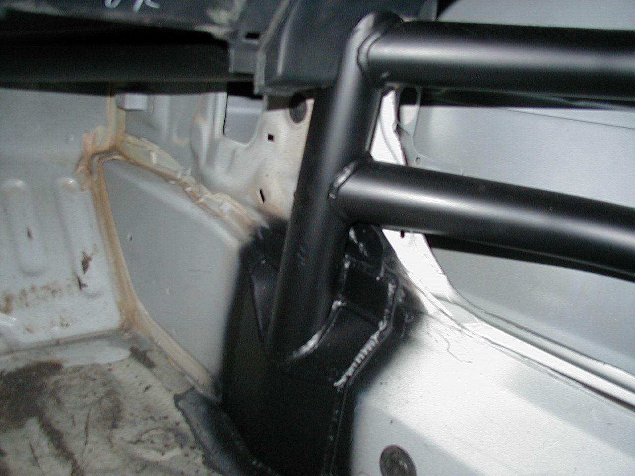

A pillars. Bars are welded in 3 places; top, middle, and at the base. Gussett bars and bar at top of windshield is a continuous bend and welded to frame.

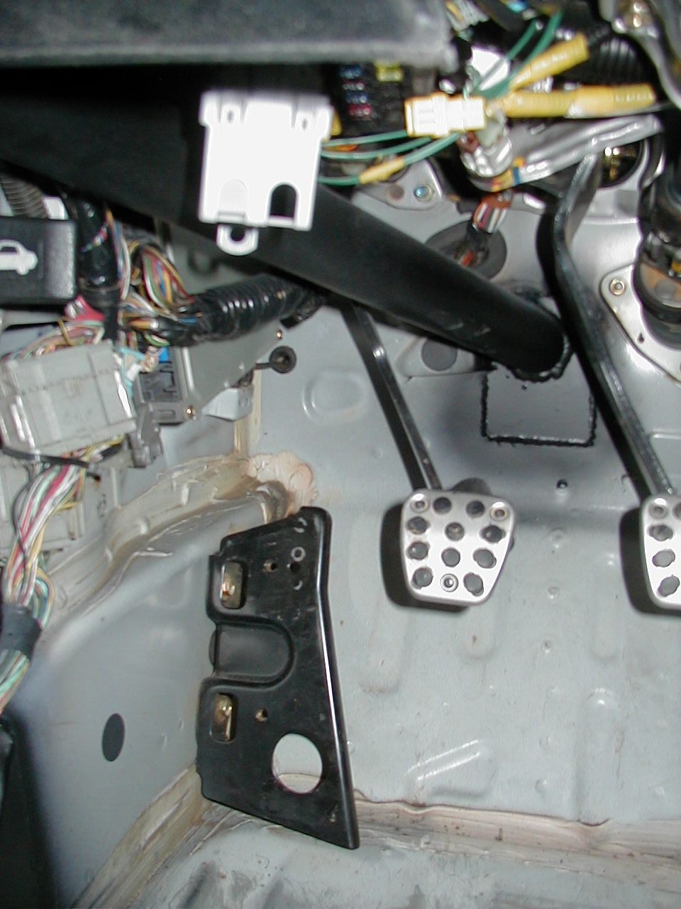

A pillar attachment at base. Nice end plate detail.

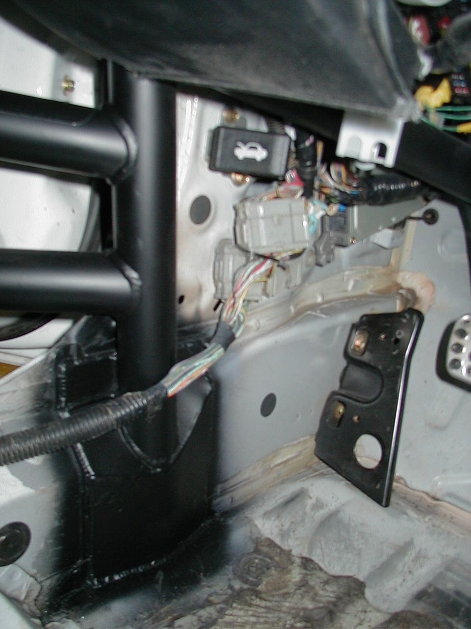

Right above where the two Nascar door bars come into the down bar there are 3 more bars (each side) connected to the chassis.
1 pair goes to where the stock frame rail runs on the other side of the firewall.
1 pair connects to the factory dash bar. I do not have any pics because they are blocked by the dash.

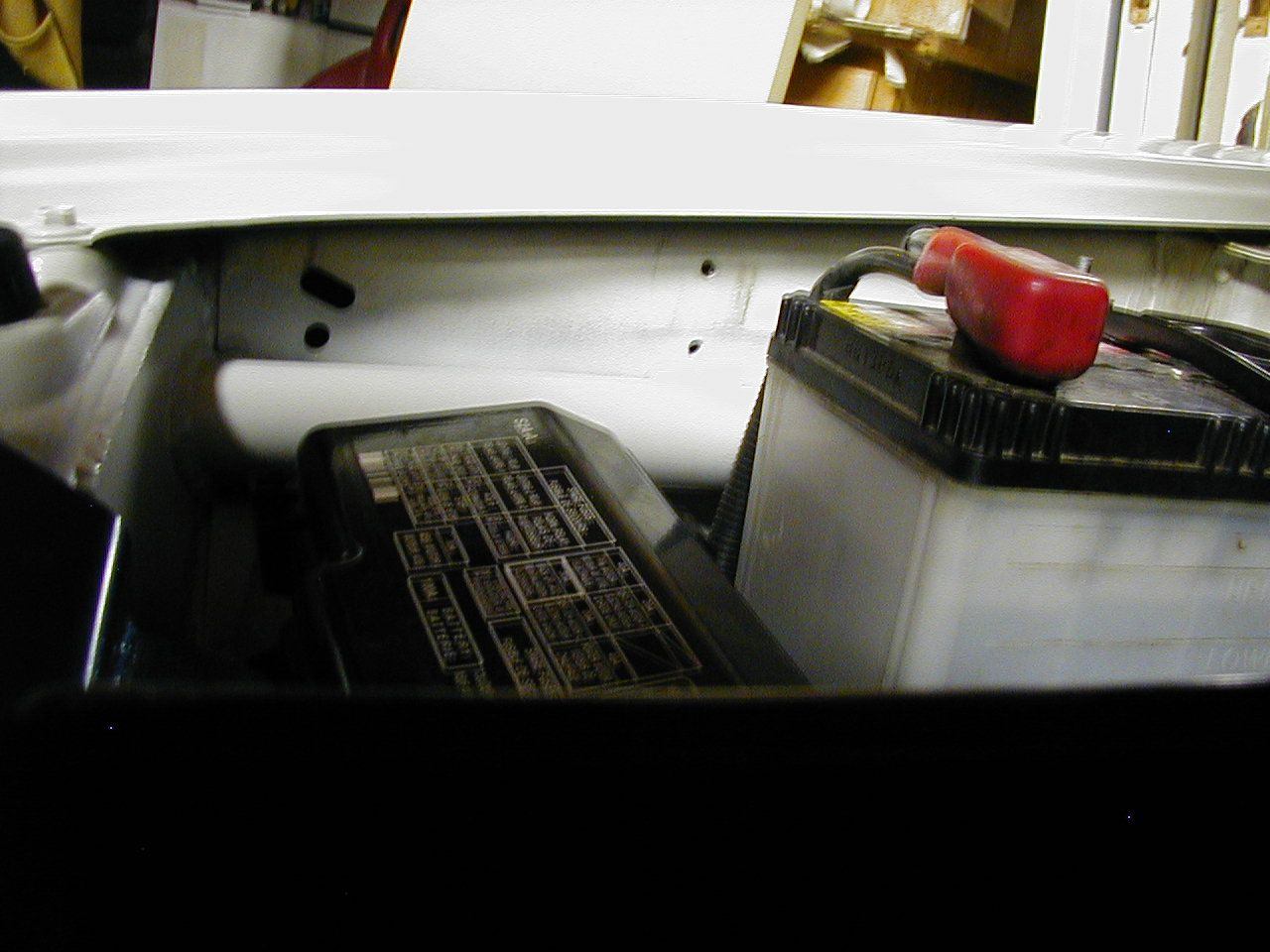

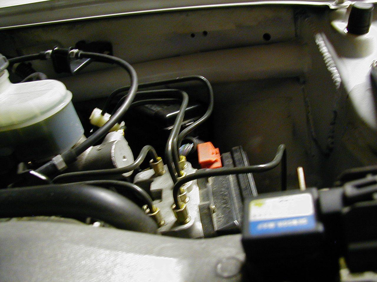

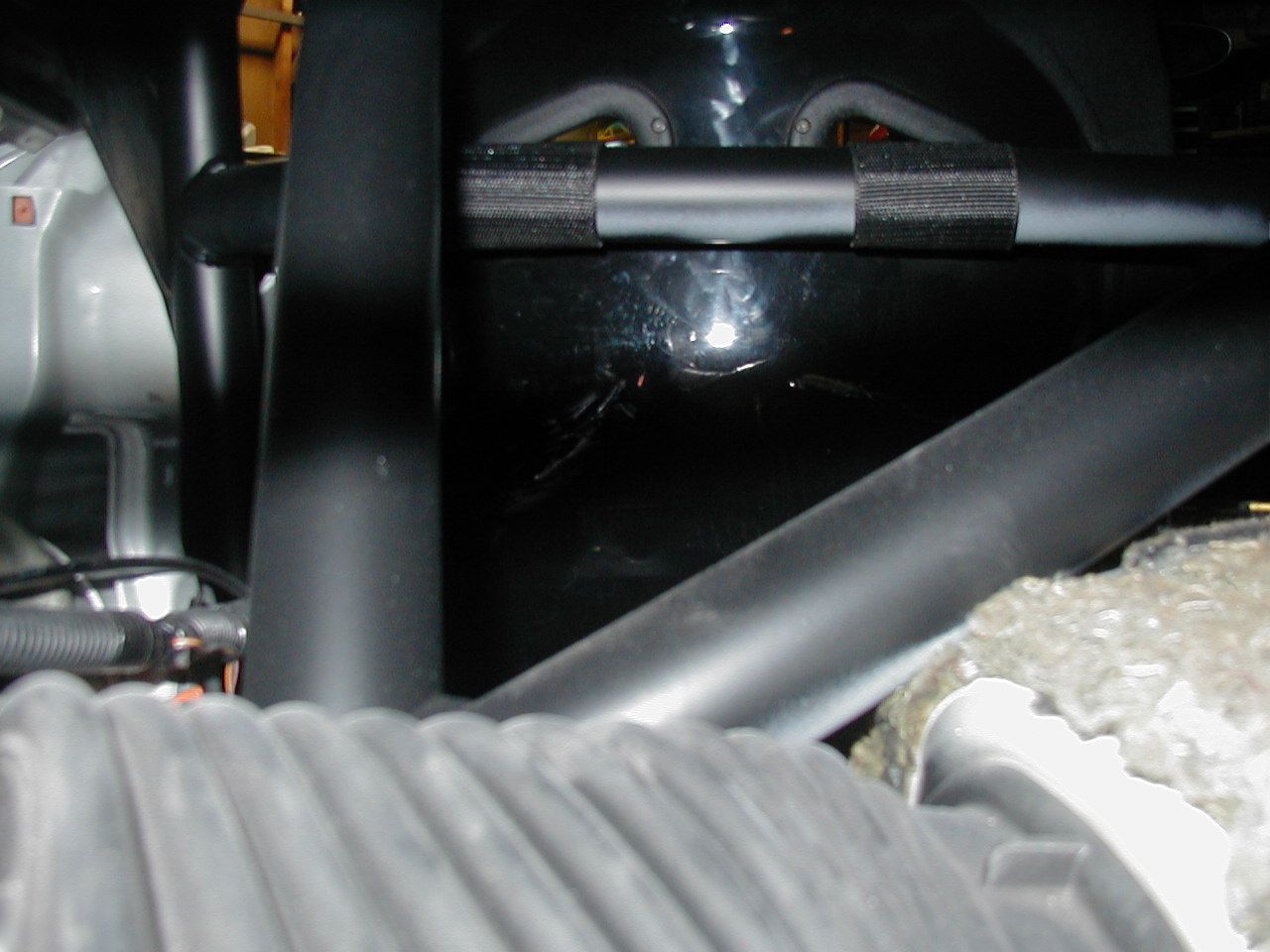

1 pair go through the firewall and attach to the front shock tower. They just squeeze through between battery and frame and clutch cylinder and frame. I have to remount 2 electrical boxes.

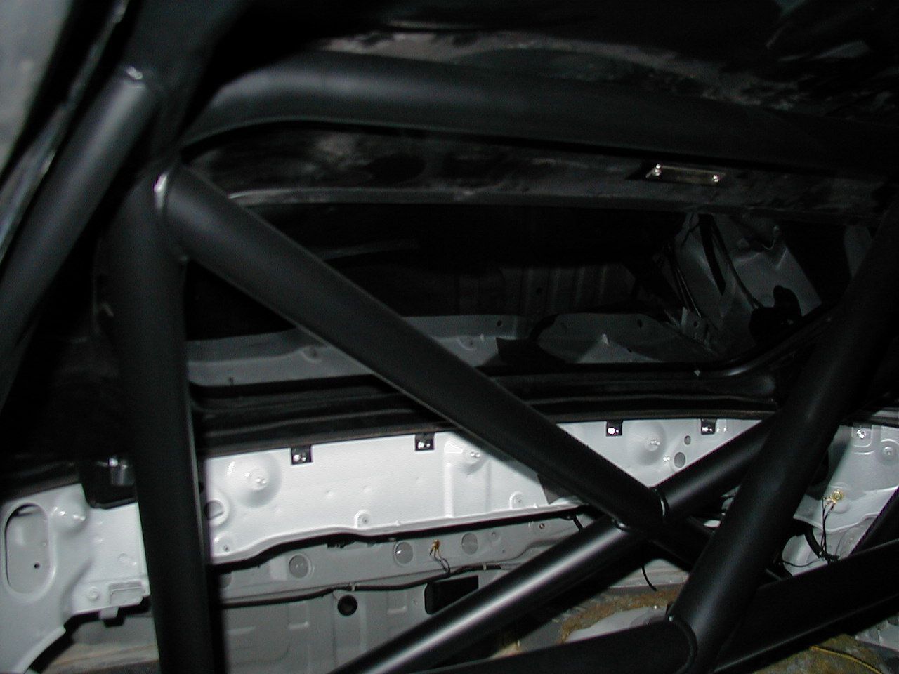

the X to the rear shocks.
window net mounting

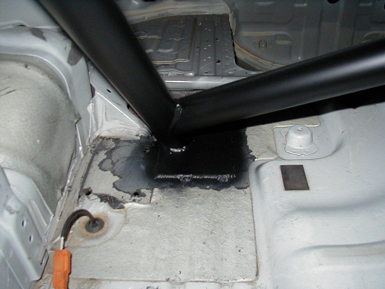

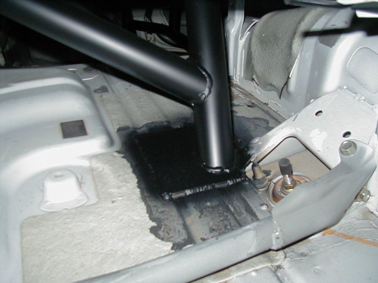

more mounting plate detail
Back to the rear.

Wow, I can't believe Mark got bars up to the front shock towers. That's a tight squeeze.

Recaro seat of course, I think it is SPG but I'm not sure. I'm sure it is the same one that is used for the Porsche Cup. I bought it through Northstar Motorsports and he hooked me up with the seat attachment and sliders. A car with an interior might have an interferance problem because of the "wings" on the seat.
