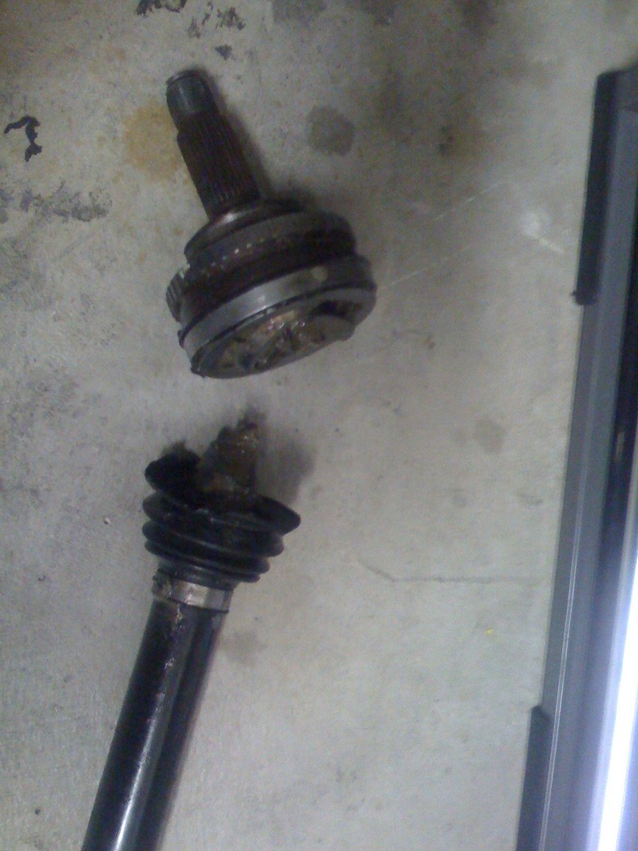

I had a very poor Saturday at buttonwillow. This is what happens when you shift from 3rd to 4th on a berm. This was on the my warm up lap on the first session of the day!!
There was a loud pop and no power. Lucky it broke near the sweeper going 80mph and I was able to roll in to the pits. I later had a talk with the race shop owner at buttonwillow and she said that a lot of spec miata's break there axles at that section of the track. i guess it was a combination of speed and shifting when the rear wheel was alittle bit in the air and when it came down it just shocked it.

Sorry to hear what happened, but could you clarify what happened? I'd like to minimize chances of that happening. If i'm not mistaken, a berm is a dirt wall/mound of sorts, so you hit something like that? Or am i missing something?

Here is a picture of a berm. The mini in the picture is running over it. At buttonwillow the berms in the Esses at turn 11 are much higher then this. I would normally clip two of the first ones (there are a total of four) to get a straight line going out of Esses. It was weird, I normally never shift around there but since I was warming up I was going a lot slower. I guess it was a combination of being slower on the warm up lap and not knowing that something like this could happen that did it. Rylan said maybe it may have just been a bad axle.
