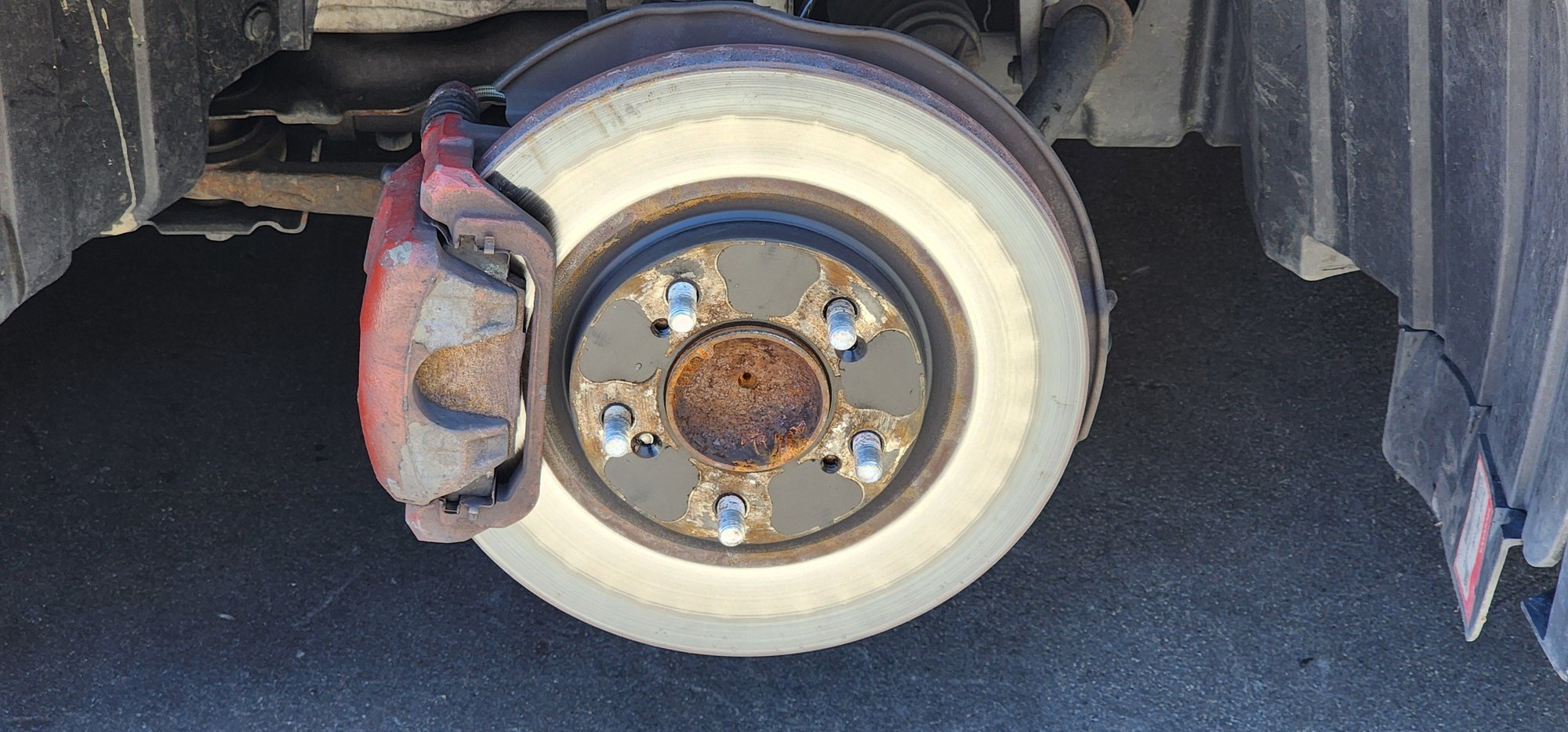

Hi all, a little update. I'm kind of hitting a bit of a wall as far as lap times are concerned. Kind of stuck at 2:13 on Thunderhill East but that's ok. On the last few track days, I've been dealt with high volume traffic sessions after sessions. I've decided to just work on specific techniques, and specific segments/corners of the track instead of going for lap times. And reserve lap time attempts when I go with buddies on our private track days = open track.
I made an observation though, I noticed a very evident glaze when I worked on the car under direct sunlight. What do you think caused this two-tone glaze on my rotors? It's there on x4 corners, with the rears being a little less pronounced.
The fronts are almost brand new, just track 5 track days old with 2 of those under heavy traffic:
Pads = Project Mu 999
Rotors = Centric Blanks
Calipers = Stock OEM
The rears are from the previous brake job, so they're old:
Pads = Project Mu Club Racer
Thank you!

looks like uneven pad pressure being applied to the rotor, usually from tapered pad wear. It's a characteristic of having a single piston sliding caliper.

Thanks, but the pads are relatively new? Just a few days is enough them to be this dramatic?
And is this a solvable issue (well, I mean, not really an issue, right?) with the current set up? I generally remove and inspect my brakes between track days and re-grease the pins. Let me know if there's something else I can do in the meantime?
Also, does this mean I'm not actually using ALL of the surface areas available to me and overheating my brakes?
I have some of this glazing in the rears as well, although not as pronounced.
