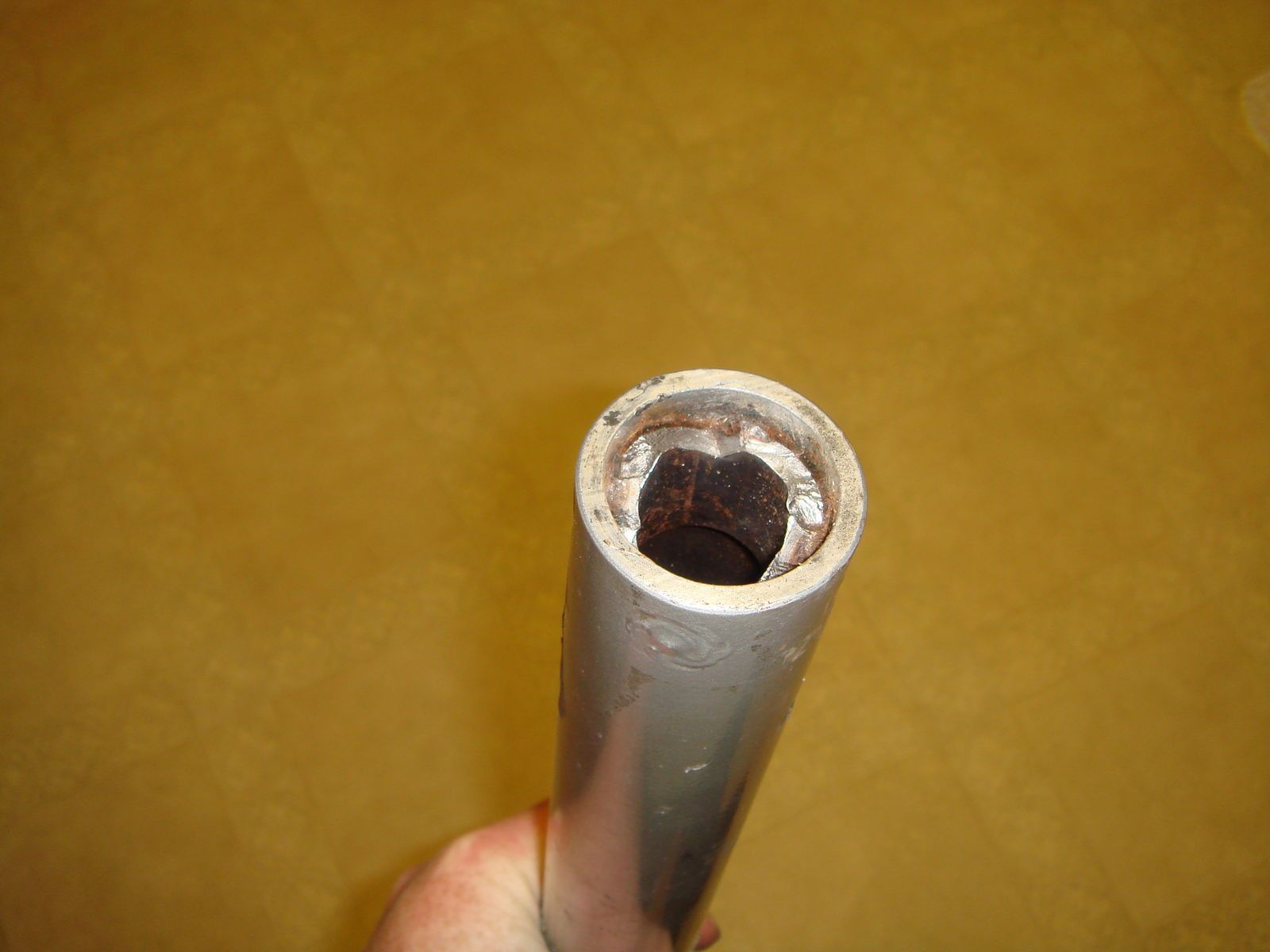

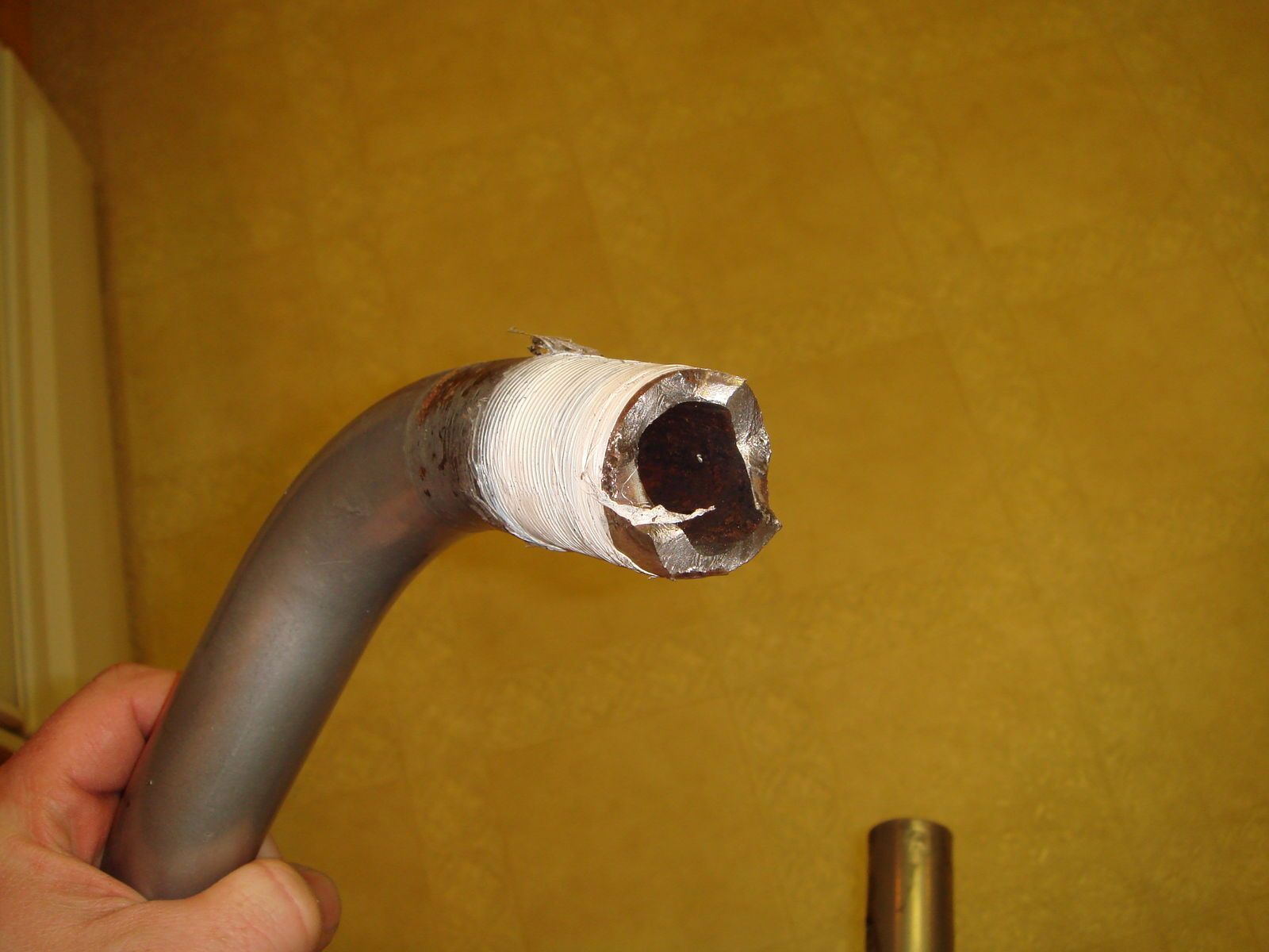

I had a 1st gen. bar - didn't crack but the adjustment bolt was frozen inside the bushing in the smaller bar. I've had the 2nd gen. bar nearly since it was available, probably have >45k miles on it, all on full stiff...

I have broken a Gen 2 bar
