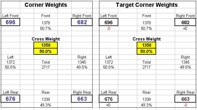

Here's my final corner balancing results. These weights are with the sway bars disconnected. I'm installing McMaster-Carr adjustable end links to remove the sway bar pre-load. Changing nothing except the disconnected end links changed my Cross Weight by -20lbs (or 10lbs for each of the 4 wheels).
This is with me (215lbs) in the seat:
This is with no driver or passenger:
This corner balancing thing is a lot of hard work but I'm finally ready for tomorow's F.A.T.T.

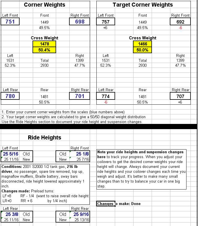

I have posted a detailed description of the steps I went through to corner weight my S2000. I have screen shots of all eight adjustments I did during my quest for a well balanced S.
http://www.robrobinette.com/corner_weight.htm
I did a Summit Point F.A.T.T event last week and the S handled superbly. All the work I've done to the S's suspension has been worth it. I have to give props to all the guys on this forum for the recommendations and installation help with the PSS9 shocks, Comptech sway bar, bump steer kit, and McMaster-Carr end links. Thanks for sharing your knowledge and expertise.

I have updated the Corner Balance spreadsheet with new wedge and bite values, date and time stamp, and other minor updates. The latest spreadsheet can be found here: http://www.robrobinette.com/corner_weight.htm
