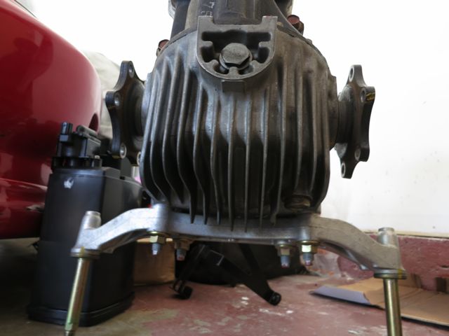

So is this an AP2 diff?

Looks like it from Mikes part #'s he has listed in the first post.

I realize that this is the prop shaft, but it bolts to the differential at the companion flange (yoke) (#1 in pic above). These are the bolts that are different on the AP1 vs. AP2 differential.
BOLT, SOCKET (8X65) - 2001 Honda S2000 (90183-S2A-000) can be found as reference #5 in illustration
BOLT, SOCKET (10X62) - 2008 Honda S2000 (90182-S2A-A00) can be found as reference #4 in illustration
AP1 is first pic and uses a 8mm bolt. AP2 is second pic and uses a 10mm bolt
