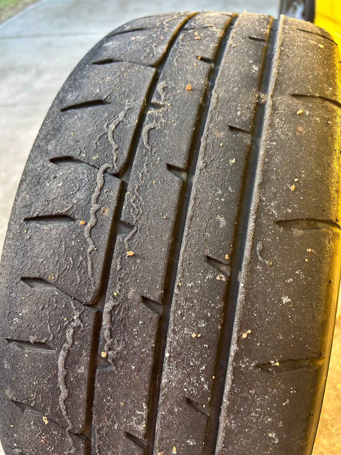

Been happy with the re71rs. Bought it for AutoX but I’m doing less AutoX and more track days now. From the old butt dyno, feels like performance is starting to drop off, although predictably. Felt like I was on rails at RA, this last time I spun at Sebring at turn 6, bad setup coming out of 5 and got on the gas too soon.

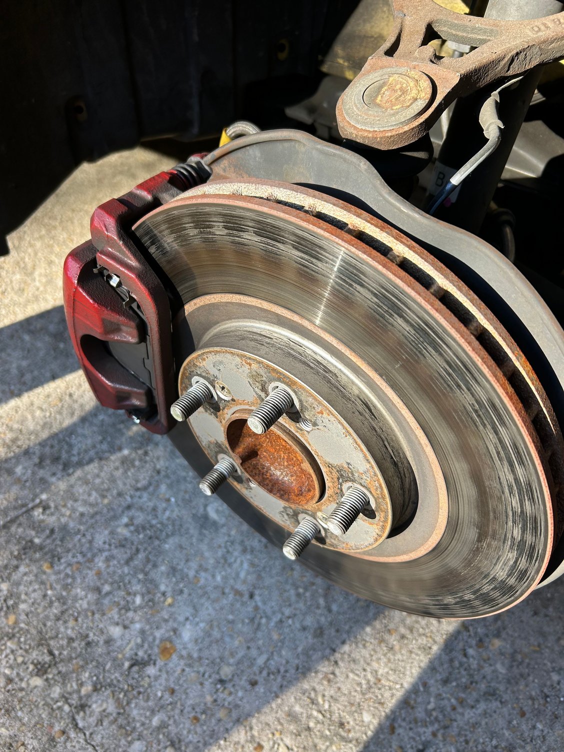

Also been happy with the POWERSTOP PSA. I’m about halfway through these pads up front. They handled all the heat from 30min sessions at Sebring. However, I still don’t have the confidence I’d like in the braking system. These were cheap rotors from Rock Auto, interesting how the heat marks lined up with the cooling veins. Also looks like pad contact is not uniform, unless it’s normal for the outside of the rotor to stay cooler that the center. Guess that makes sense.

Those "heat marks" are from the abs pulsing. Means you're leaning too much on the abs system. Your front tires are locking up and the abs is trying to sort it out.
Try to work on getting to that threshold right before abs and consistently hitting that mark every time.
