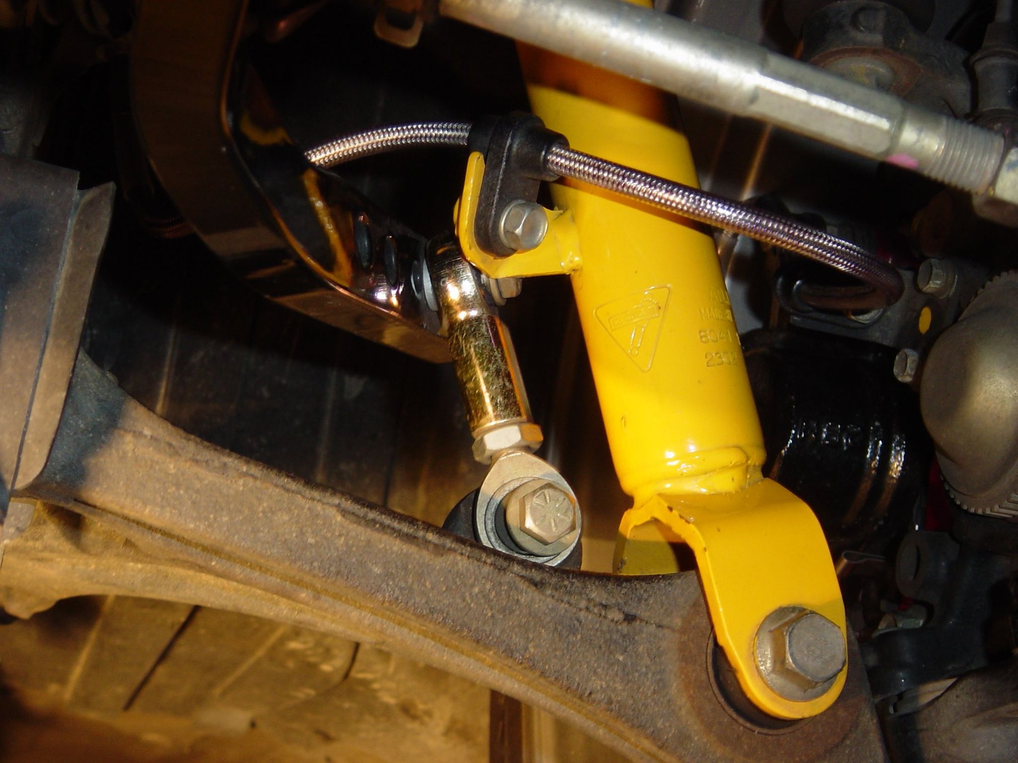

Forgot to check this today. Sorry. Going out to the garage now.
Old Jun 5, 2004 | 06:20 PM
FF2Skip's Avatar
Posts: 48,203
Likes: 10
From: Lewisville, TX

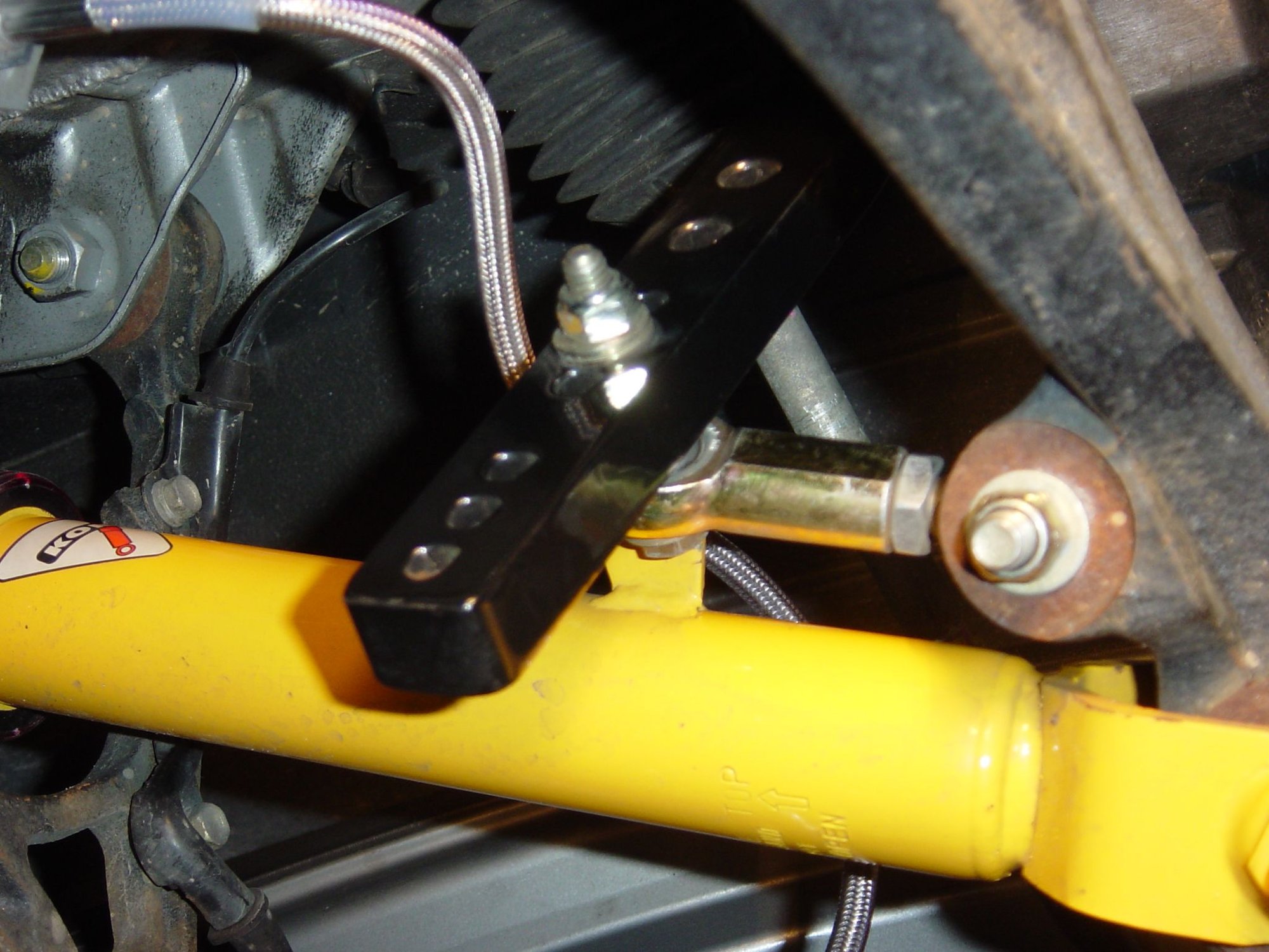

Okay. It seems as though the stock shock body's bracket for the brake line might be your problem... too low. I just jacked the car up and took some pics. We do have our bars on the same setting.

I really think it is the endlink hitting the mount for the brake line. Im going to give the mount a little bend away from the link and see if that helps.
