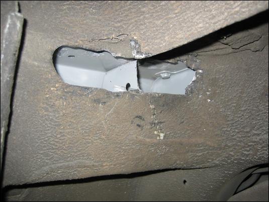

You need to cut on both sides of that vertical member, and remove a section of it:

Thanks I was looking for those pictures above to reference my problem. I have cut on both sides of the verticle. To the left I have cut all the way to that verticle piece/rib and on the right I have cut all the across until I hit that inside wall.
From the pictures it looks like your backing plate is a lot shoter. Can you measure yours?

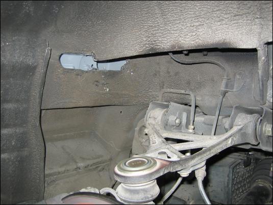

Here's what I've cut on mine:

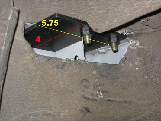

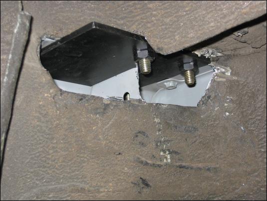

Mine are 5.75 x 4 inches. The 'U' shaped cutout is not centered on mine, so they are definitely left/right specific. Remember that the welded nuts should be facing down.

I just measured mine; it's 5.75(L)x4(W)". Is yours 5.75 long or wide?

Added dimensions to the pic to avoid confusion:

Thats exactly what I have. I'll take a picture tomorrow morning of my situation. I can't see why I'm having trouble.
