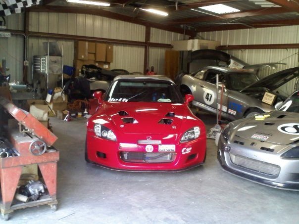

crash's Avatar
Posts: 1,751
From: Santa Cruz
Go into your local Ford dealer and talk to the Diesel Tech
On EVERY 6.0 Ford Diesel that has the engine pulled for repair some guys take off this bracket they use on the install at the factory.
If you can get your hands on a few they work excellent.
I am rocking one on my race car
Very hard to see it but if you look in the top photo its on the pass side of the mouth in the bumper.
I will dig around for another picture or go take one.
you can even see it in my sig kind
