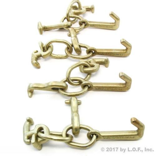

I'm getting prepared to trailer a new to me S2000 and want to make sure of the placement of the J or T hook attachment points. So they insert into the frame at the yellow arrows?? The oblong holes at the rocker panels?? I thought the frame would be better but those holes don't look like they'd hold the hooks very well. Is the rocker substantial enough??

Yes, what you have highlighted with the yellow arrows is correct. According to the manual, that is the proper way to strap the vehicle down. Many here, including myself, have towed our S2000s that way with success for many years.

Those are the correct holes in the chassis to tow the S2K correctly.
Those holes are designed to use R hooks only.
Like this:
https://www.easternwreckerstore.com/R-Hook-p/11-7r.htm

Thanks I've got these-

Some people find it tricky to get the R hooks in. It does fit and it's super secure once its in there the right way.
Make sure you have 3 wraps of the strap around the barrel of the ratchet minimum. Once it's secured nice and tight check it all of them after you've been on the road for 30 min or so,
Make sure you leave the trans out of gear. There's no lubrication in the engine when it's not running and if the car is in gear you are moving the pistons a little bit without lubrication.

Thanks, I didn't want to he hard on the tranny or diff leaving it in gear. Kind of want o put on the e brake though...something about it being able to move around if something does go wrong with the straps.

Another confirmation that those are correct holes and hooks. I used them to transport a tub strapped to a chassis cart to the paint shop.
