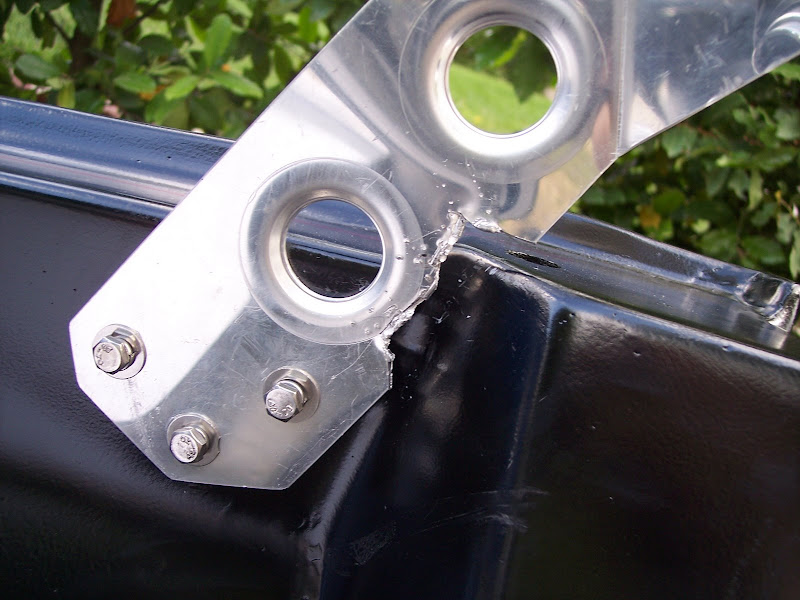

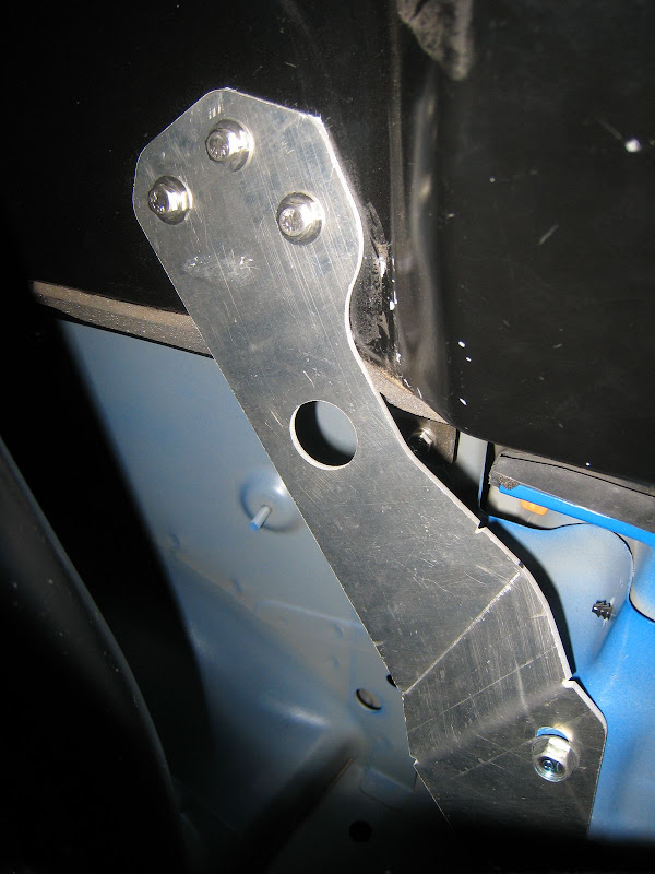

EDIT: wait I know, you have to get the new "racing" version from Izzy's...I had the same problem...just call him up he'll know what you're talking about
This was before (my own retrofitting of the original brackets in a parking lot the day I picked up my hardtop lol):
And this is the new "racing" version that he designed to address the problem (works PERFECTLY!):
-Fil

Update:
It's hard to tell from the pictures but its pretty far from mounting on the hardtop. I can push the bracket in, but then the 3 holes no longer lines up.
