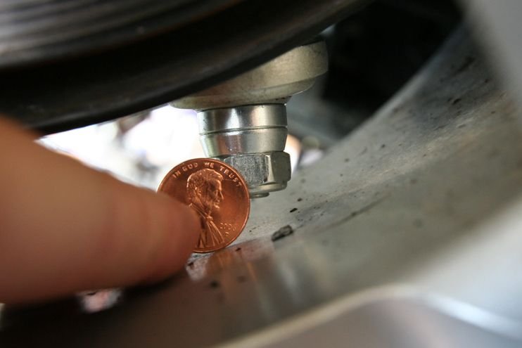

the j's racing rear tie rods will barely clear 16" wheels. you will have 1mm in between the wheel and the tie rod, which probably isn't safe. I've had the rear tie rods on for a year and half now, and the front tie rods for about 8 or so months, and they're still fine. thats daily driving and with a few track days.

16" wheel clearance:
Heim joints do not wear well on city streets and will need to be inspected on a regular basis for wear/play.
