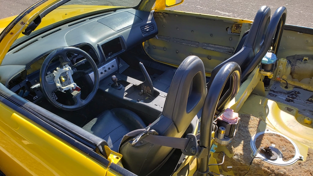

After keeping an eye on the market for about a year, I came across this S2000 on craigslist that had already been gutted and LS swapped. couldnt pass it up. stock they were going for $22-25k.
i paid $8600 for this one running and driving.
needs plenty of work, but there bones are all there. has a iron 5.3L, fbody T-56, Import Muscle swap kit, GTO ecu, and a Tahoe Harness. Honda Harness completely removed.
car was rear ended. but no damage. it just wrinkled bumper below drivers tail light. didnt even break taillight. didnt touch frame. previous owner trimmed bumper (damage)

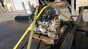

Picked up an Aluminum L33 5.3L. After waiting a month for my local junkyard to find one, my race buddy Matt put me onto Car-Part.com This was the only one available with 138k. Came out of a 06 Silverado 1500 with mild passenger headlight impact.

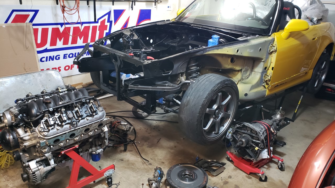

Truck to Fbody conversion begining. oil pan, pick up tube, windage tray, water pump, intake manifold, Harmonic balancer, alternator bracket, etc etc.

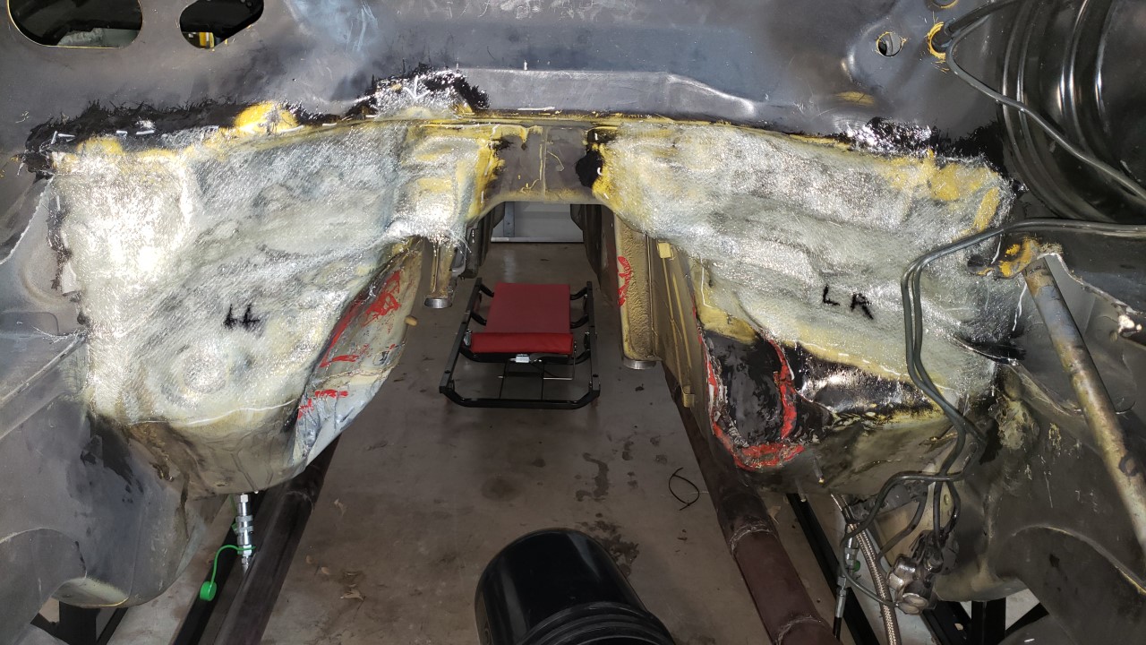

Firewall Fiberglassed to cover the 20 holes and random seperated seams.

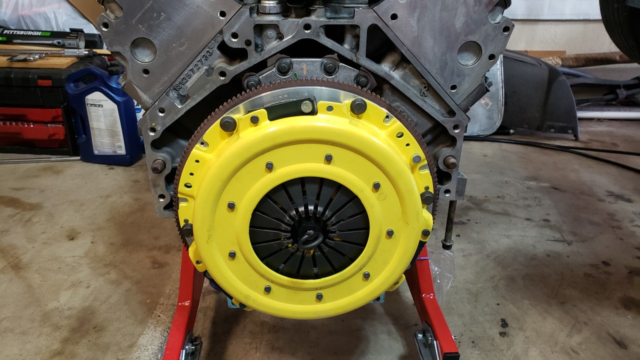

The clutch. this ended up being a two week nightmare. i could not find a clutch that would fit this flat 2 dowel flywheel. i had 2 clutches at my house an LS1 clutch and a Ram LS7 clutch. neither fit the 2 dowel pins. so i ordered a new Ram that showed it had the two dowel holes. when it showed up it was nothing like the picture and also didnt fit. so i decided to make a emergency trip to summit racing in dallas to not loose another weekend. Place is HUGE! i brought the flywheel and had them pull 4 clutches that were supposed to fit. the first 3 did not. either had no dowel holes or 3. FINALLY the last clutch they pulled, and ACT was the winner. had the 2 dowel holes and fit perfect. 6 clutches later i finally had a winner. ive never used this brand, as ive only ever seen it used on import builds. but it fit, and sorta appropriate i guess for a "honda"

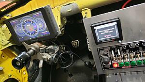

Holley Terminator X Max wiring and setup. and other odds and ends to start the new motor and ECU for the first time.
Bent up a center dash switch panel
Oil Cooler Adapter
Took the time to label EVERY single wire in the whole car. no guessing down the road.
Learned a new skill, pinning a new connector. the old one was shot and had raw exposed wires coming out of it
a $50 ebay silverado intake worked perfect as a cold air, goes right into a factory hole in the fender
First time applying power to the holley system. no smoke!
Holley install and first start up!

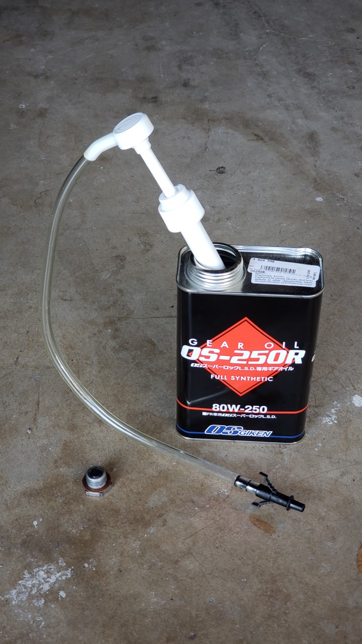

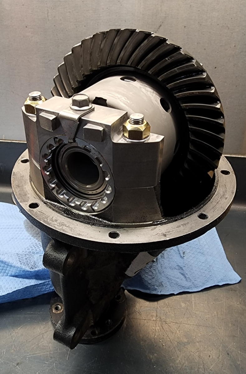

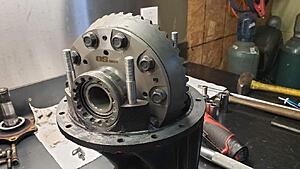

on the diff went with an OS Giken LSD, Powerneed billet diff caps, and Tim Kelly stud kit. and Gikens own oil.
