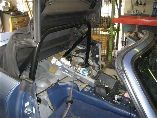

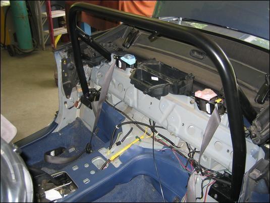

I installed a prototype GFL "Touring" bar on Friday and took a few pics of the process. The craftsmanship on these bars is absolutely OUTSTANDING! Well done, guys!
Here goes...
The inital test fit after removing all of the interior bits behind the seat, including the bulkhead. For future reference, you need to set that bulkhead back in place BEFORE you bolt the bar down.

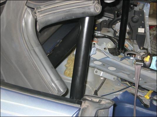

checking top clearance

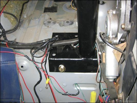

Right-Rear leg plate
Left-Rear leg plate bolted down

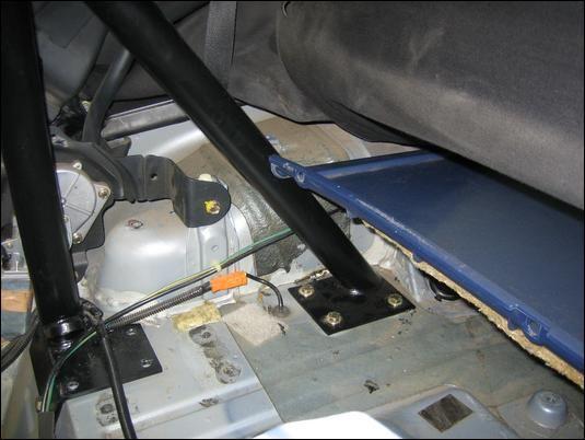

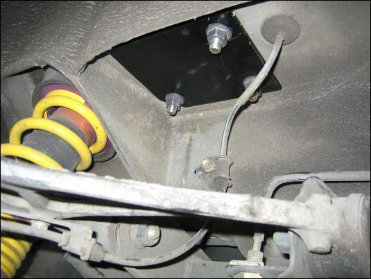

Left-rear backing plate inside the fender
The hole that had to be cut in the driver's fender to mount the backing plate.
Another shot of the cutout to give perspective
Backing plate installed. The guys talked about trimming that corner on the final mounting plate so that it doesn't hang outside of the cavity.
Left side about to get the front bolts installed -- notice the bulkhead has not been reinstalled yet. Did I mention that you need to set it back in place BEFORE you bolt the bar down?
Bulkhead reinstalled. Just to be clear, you need to unbolt the bulkhead to get access to the bolt holes in the front mounting plates of the rollbar. You don't want to take it out comletely, though, because you can't get it back in with the bar bolted down. We found that out the hard way and had to unbolt all 4 legs of the rollbar to put the bulkhead back in. It only cost us about 45 minutes, though, and was the only real problem we encountered during the install.
Enough interior reinstalled to hit the road and autocross the next day.
Rear view.
And here we are in action:
