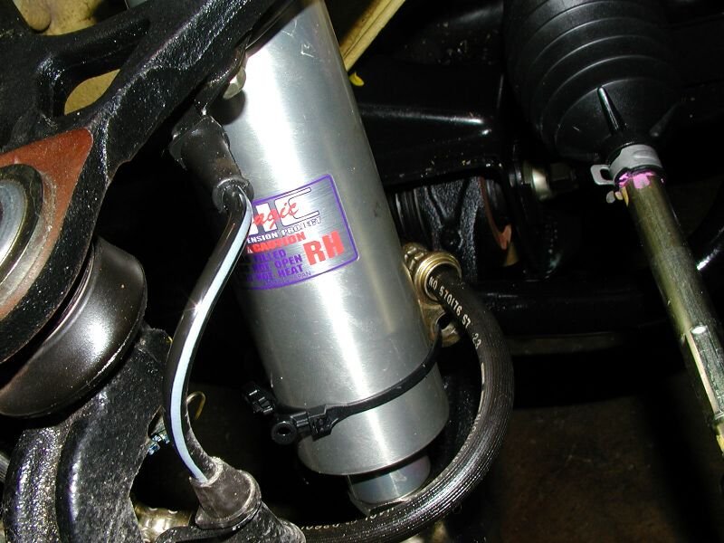

Thanks to Cdelena with his instructions. I installed my JIC dampers today.
It only took about 6 hours, a lot of time was spent dropping bolts into dark small places etc.
You need to elongate the dampers quite a bit to match the stock dampers.
I ended up with a 10mm drop to start. I am getting my car corner weighed and aligned soon and will set the ride height to 15mm less front and rear.
For my initial shakedown drive I left the dampers on 2 (soft), the ride is more compliant and comfy than stock. For general cruising this will be a better setting
After a few minutes I noticed some clunking, I guess I need to re set the spring preload a little and re-torque all the bolts.
So far I am pleased, I will try some heavy damping next
George

If you look at the pictures I just tie wrapped the brake like bracket to the damper. I don't see any issues with it.
