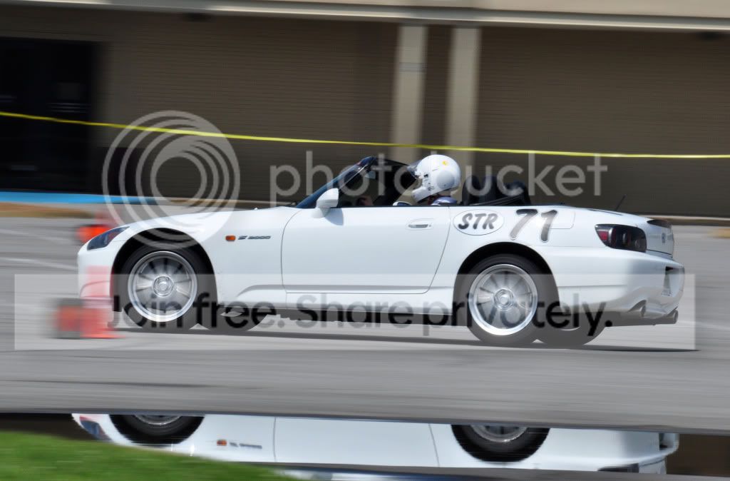

Here is a shot of me at the AutoX last weekend. I hope my new coilovers will help with control the roll.
