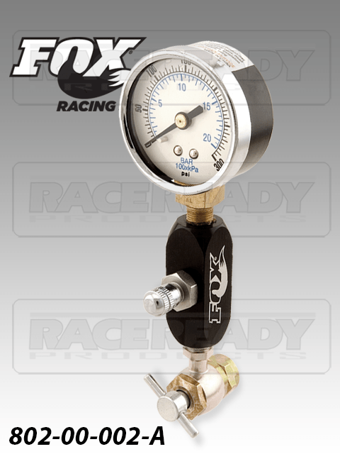

FOX Shox Fill Gauge

Since most of these are schrader-based, the other element is a nitrogen tank with a tire chuck on it. Directions are pretty straight forward:
Uncompress shock
Spin schrader collar onto shock schrader
Spin t-handle into shock schrader
Check pressure
Use nitrogen tire chuck on tool schrader until ~20psi above target
Bleed shock schrader until desired pressure
Unspin t-handle from shock schrader
Unspin schrader collar from shock

I purchased a regulator kit and shock pressure gauge from Kartek and 20CF nitrogen tank from Airgas. It came with everything, but knowing what I know now, I could have bought the entire rig for half the price.
Kartek's China-sourced quick-disconnect leaks under the pressures required and the tire chuck prematurely engages the schrader valve. With the low volume of the canisters, each time the chuck engages, the volume dumps and then recharges. The end result is a very imprecise process that requires wasting (and huffing) a lot of nitrogen.
My solution to this entire process is to source another threaded schrader valve to attach directly to the nitrogen source, bypassing the schrader inflation tool. The nitrogen regulator has enough control to get me the 200psi +/- 10psi that I need to start pressures at.
