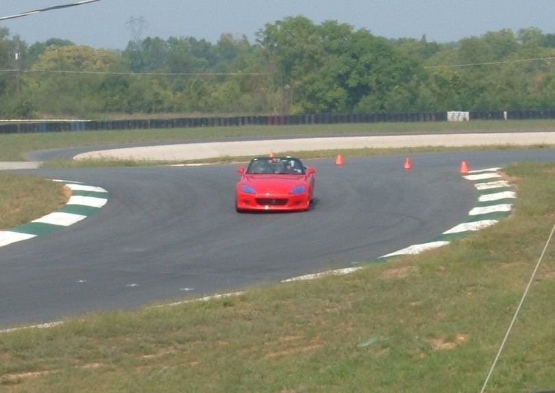

I dont think youd be getting much understeer with a broken front bar. I really dont think this is the case.
just alot of body roll in a decreasing radius descending elevation turn
heres my body roll in the same turn with almost an identical setup to gfactors (car wise)...
he was a little further along and more to the outside of the corner (where you are supposed to be)
this is also the major understeer turn. You can see it might just be the environment and not the car or driver.
