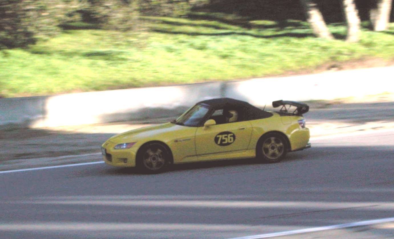

You can definitely see the downforce in this photo coming out of the corkscrew at Laguna. (my suspension is stock, so the car isn't lowered)
Here's JP's wingless car in nearly the same spot. You can see the difference in the attitude of the cars, and the gap above his rear tire.
I'm very happy with the wing. I really noticed the difference at Big Willow a few weeks ago. The rear used to get really light coming through turn 6 and I always wanted to lift as a result. Now the car sits nice and low, with plenty of grip. With the wing, I'm much more comfortable making the shift into 4th right after turn 5.

Nice shot demonstrating down force!

The credit goes to Karim for climbing that huge a$$ hill to take those photos.
