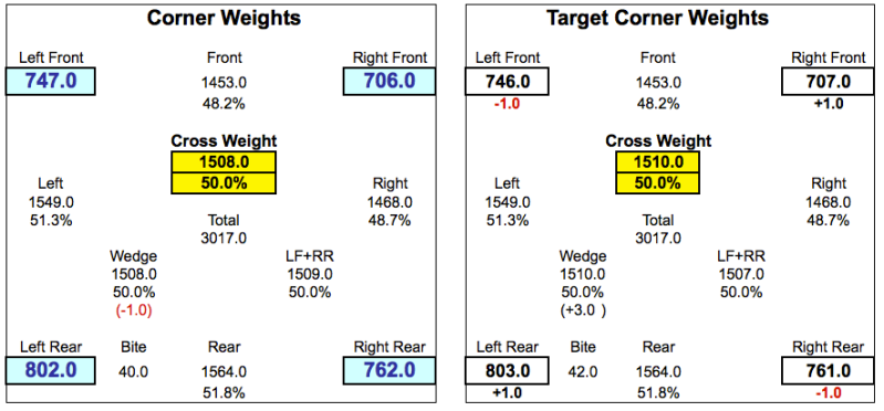

I installed some Skunk2 Pro C coilovers and Dunlop z1 then took my first shot at corner balancing myself with the help of Carl C. one of the planning guys for equide car club in south Florida. He offers rentals for the scales if anyone is interested pm me and i'll get you in contact with him.
Here are the results!
After I took the car to Zeca's Auto Repair in Pompano, Fl for a full alignment. Stenio did a great job and really took his time with symmetry. The only trouble we had was the rear toe. I read on here its suggested to stick with .05-.1 The current numbers I have are as close as possible.. Suggestions?

Any comments on the corner balance would be greatly appreciated... I tried my best to get things as close as possible, next month I'll spend even more time if you guys thing its necessary to really dial things to an absolute 50% all the way around. The car is mainly driven on the street (12-15k a year), 3-4 autox events a year and the occasional track day(once I'm comfortable with the RWD).
