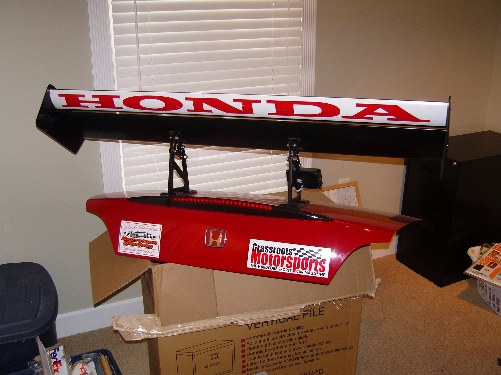

I ended up buying an extra trunk and a cheap wing from another guy on here...
I used it at the track and didnt really feel much difference, then I increased the angle of attack and the car felt much more planted.
I can support my body weight on mine... I bolted it as far rear on the trunk as possible (the trunk is stronger there) and bolted some metal plates for extra support
I suppose some of the more expensive wings do a better job (and look cooler) but im happy with this one. I dont care about this extra trunk so it got dented up a little in the mounting process.

your wing looks like it has too steep of an angle of attack. the profile of the wing matters a lot... but even cheap wings can be made a lot better if you do a few things to help it (add a Gurney Lip, deeper endplates...).
read this for more info... lots of good pics and drawings here.

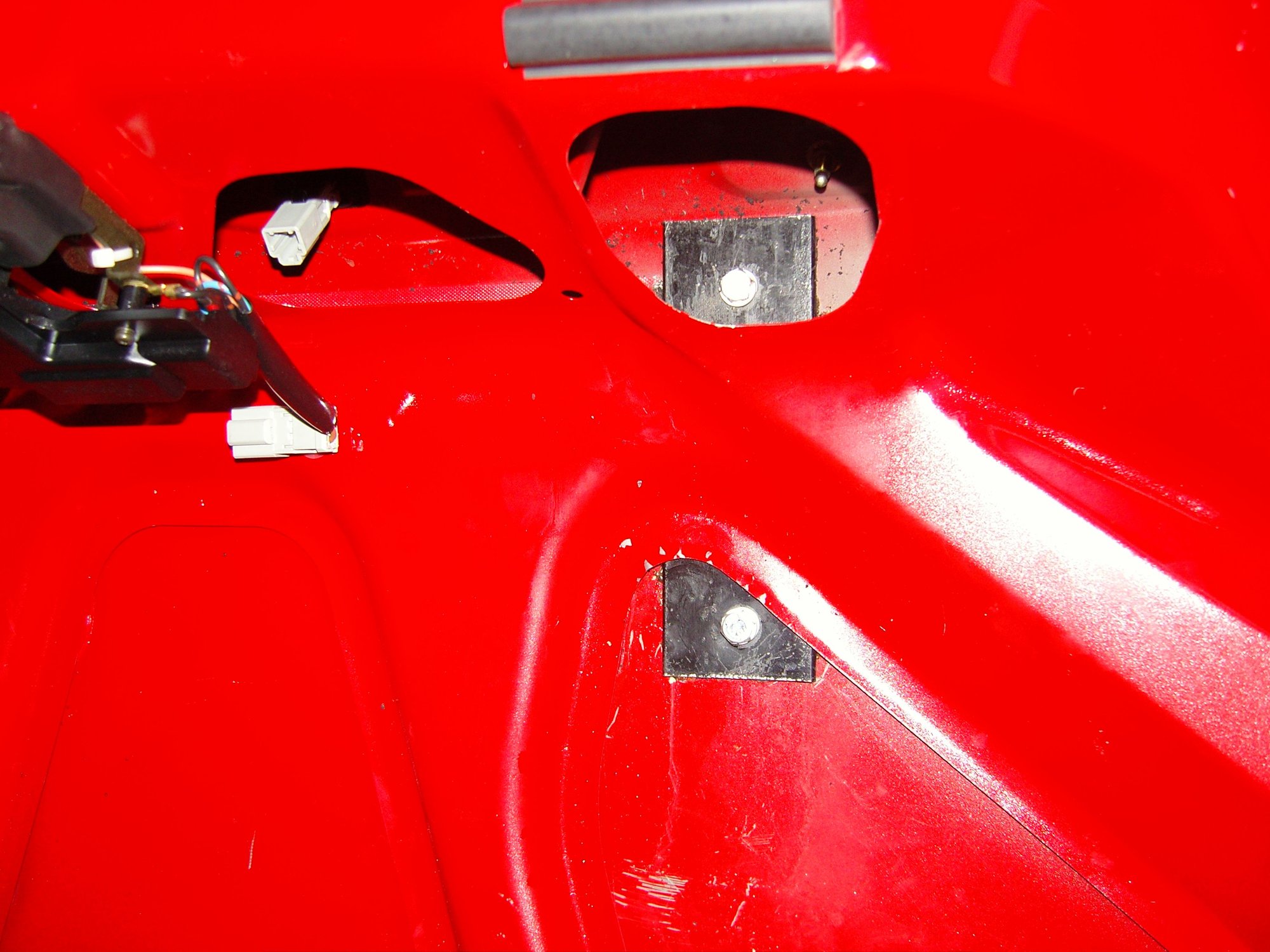

im currently using the J's Racing carbon wing on my S2k. Its a nice piece, cause ti mounts at the pinch welds at the far edges of the trunk, so it shouldnt flex much at all. They also make a center mount versions, and now sell contoured reinforcement plates to bolt to the bottom side of the trunk lid if you choose that route.
