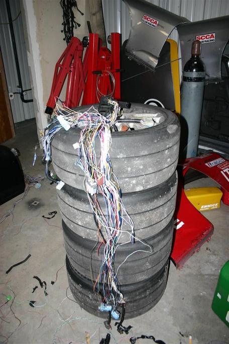

Anyone have a decent way of removing the electrical wiring that isnt needed in the process of stripping. Should I just start at free end and then start following back and removing the electrical tape and tubing as needed???

A few years back one of the guys pulled all the wiring and ended up neededing schematics and a whole lot of work to get it going as a race car. A real headache.
Probably best to pull the tape and covers and remove one wire at a time.

I wired my interior from scratch, it wasn't that bad. I will do the whole car eventually but to do it right is actually pretty expensive. If you don't want to remove the whole harness the way you described it is probably easiest.

I've been de pinning and removing each wire I determine won't be needed. Chassis harness is complete, have to do the engine harness now. Planning to use the Raychem DR25 to cover and protect everything, plus it will match the harness for the Motec ADL.
It isn't a huge weight savings but it adds up, and the less crap there is the cleaner it looks and the easier it is to trouble shoot.

The whole car is stripped and all is left is the wiring. I figured it is not a whole lot of weight saving.
Making look cleaner inside is any factor that gets me wanting to do it.

Not worth it for me, we spent over 50 hrs on taking out wires that we don't need on our 240sx, total weight about 10 lbs, and keep in mine that s2000 has much less wires dont need than nissan.

Unless you are going with a Pectel or an older version of Motec , this is not worth the trouble. Sure, you can build a mil-spec harness.
But unless you are replacing the factory sensors with proprietary ones for your CU/Data Acquisition system, this has negligible weight savings.
Same goes for removing the undercoating.
Start drilling holes in non-critical areas and replacing components in carbon fiber. Or just turn up the boost add more HP
