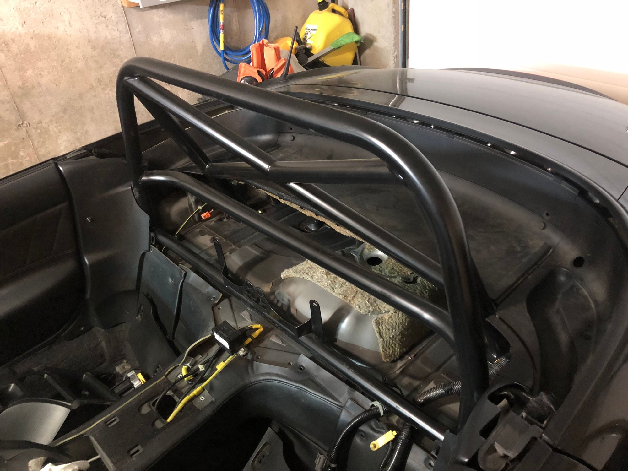

You can get a good look with the other companies it just takes a lot of time I did it with evs tunning and I’m happy with how it looks

Can you post pictures of the EVS bar. And thanks for the input at far as regulations go . I guess they keep you safe and that’s why they are there .

Thanks for posting pictures I know that’s kinda like opening your zipper and putting it out there with so many people ready to give “advice “. So thanks for posting those pictures. Another option is the Cusco 6 point is that one legal ?
